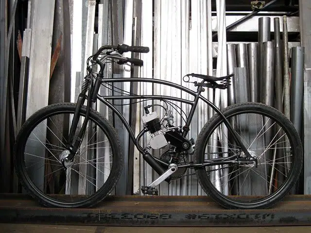

I should be ashamed... but I'm not lol - I just hadta take the Rollfast out for a pedal under the pretext of findin' some "solutions" to a coupla lil problems by bringin' it to work (that and it was a really nice day heh). It's FAR from finished, there's 'bout a million things I still need do - not least of which the tank... but as a bicycle it's back to operable again, 'cept rear brakes which I still need to make a bracket for.
Even without a seat cover (or any padding on the steel for that matter) it's the epitome of comfort, the Sturmey Archer 3 speed shifts beautifully, the brakes work great (at least the front one does lol), the springer is everything I'd hoped, and the bike just glides along forever.
Takin' it out for a pedal turned out to be a far wiser thing than I'd thought, my determination renewed - I was reminded why I like this bike ;)
...but as you can see - there are more than a few problems still :p
