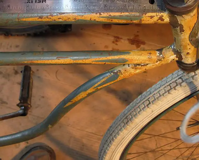

Well I've started on the fenders and they're proving to be just as much a challenge as I thought - which in a way is good 'cause it's prompted me to start the tank as well as a diversion and something to do while the fill sets lol I'll post some pics as soon as I've made 'nuff progress so they look like somethin' ;)
I decided to do as much of the tank as possible at home, bringing it in only to be welded to speed up the process a bit and while there's far better tools for it at work, I've simply more time at home to make sure the various panels fit as well as I can manage.
I must say though - getting a 2' x 2' sheet of 20 gauge steel home on a MB is... interesting lol and I did actually "crash" - it had nothing to do with the hunk of sheet steel though and I wasn't even going any faster than a slow walking speed. I was just trying to round a corner when the Schwinn suddenly flew out from under me, leaving me standing there with a dumbfounded look. Glare ice/black ice - whatever you wanna call it, it sucks. The bike wasn't damaged and I didn't think I was either... till a lil later. Now as I type this about 12 hours after the fact, I can't even stand up without pushing off something, my lower back is defo not happy about alla this.
Bah, enough whining and onto teh pics heh - the tank will be about 24"L x 5"W x 3"T with the only real challenge being finding some vented fill cap and base that's about 1 3/4" wide... I'd really like a brass cap but we'll see what I can find. There will be an internal baffle/splash guard to reduce the amount of fuel slap against the fuel fill (number one cause of cap seepage), a "fuel sight gauge" made from brass elbows and a hunk of clear fuel line, and ofc copper fuel lines... tho that's not really part of the tank lol
The poor, filthy Schwinn bein' a workhorse;
and the initial measurements bein' figured out fer the tank; (click to view larger)
In the pic it looks as if the tracing is off, it isn't - it's just the angle of the pic. There's a 1/4" gap all around the tank to allow for the fasteners BTW
