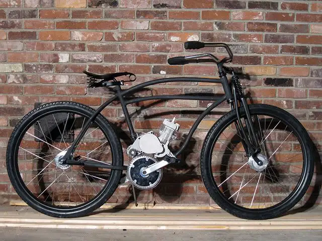

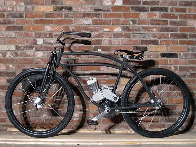

well, here's some updates on my bike. some progress, some going backwards...
my skiptooth chain is dying. i've broken it twice, just from pedaling it to start. it was NOS, but i think the 60 or so years of inactivity are taking it's toll. haven't done any real damage, just had to remove and replace broken links.
the spring collar that holds the rear sprocket on the hub snapped, causing the sprocket to jam up with the chain, and scratched up some spokes. nothing bad, just cosmetic. replaced the collar with one from the many hubs i have laying around, and fixed it.
now for the big one.
the chain tensioner...
once my sprocket wore in, the engine drive side was too loose. there's no way to tighten both chains up, and believe me, i tried. i made another rear cog for the pedal side out of a 20 tooth, added a link and a half to the chain, but then it was too loose. went back and forth with sprockets and crap but nothing worked. either one side or the other was too loose or too tight.
if it wasn't a skiptooth chain, i would just put another odd toothed cog on the rear, like a 17 or a 19. but with the skiptooth, it has to be an even number of teeth. follow me so far?
so, i spent all day making this:

it's the brake arm off an old hub, and the nut, grinded down to a square. i took the holesaw and cut out a piece of urethane to make a wheel. i was gonna put a bearing in it, but i wanted to see if it was gonna work, first.
i bolted that on next to my real coaster brake arm, and had to mess with the cones a bit to get it where i needed it, and away we go...

if my skiptooth chain holds out, i'll make another wheel with a bearing in it. if not, i'li switch to a new chain, new sprockets, and be done with the tensioner.
there's no way the thing can slip, move, break through my spokes, etc, so it's actually kinda cool. i'll just have to wait and see how well it lasts. the urethane's kinda soft. might have to go dig through the trash at the urethane place and find some harder stuff.

yeah, i was trying that first. couldn't get the right tension. when i thought i finally got it, i pedaled it around, thought it was great, till i pedaled backwards to coaster brake it. chain tightened up, jammed again, and it just wasn't working.
i'm totally re-working this whole bike around the god d#@$ skip tooth chain. without it, i'd be fine, but i just can't get rid of it.
another case of sacrificing style over function.
but, i just rode about 50 miles and my chain tensioner rig is holding up perfectly.
