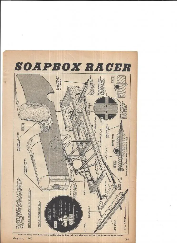

The MI design is a nice one. Very good looking, I think. By clicking on an illustration it will make it large enough to read the print. Thanks for sharing the plans, Troy.

Here are the soapbox plans from 1941, there isn't any copyright, as far as I can tell I have the only set of plans...including the Hi Sibley site. I also won some other plans from the 40s for pusher set ups and motor wheels which I will also put up in the correct sub forums.
Put a HF 6.5 engine in the back of that under the body, and add some Honda CX90 wheels and you have a CYCLEKART:
http://www.cyclekarts.com/
(well, not exactly, but it's close enough as a topic for discussion)
I saw the cycle car site a bit back, so very cool. Also it seems they have basically the same origins of Boardtrackers..returning GI's looking for that adrenaline rush of combat.
