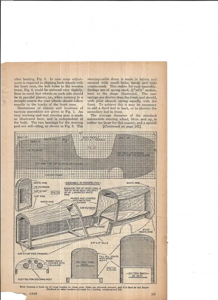

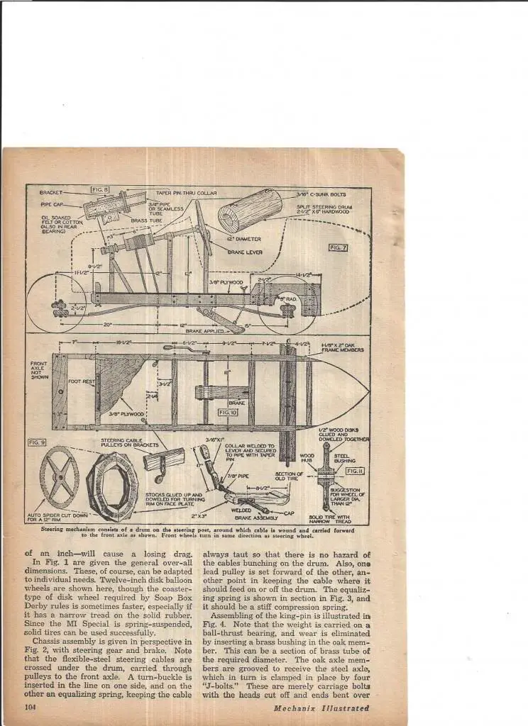

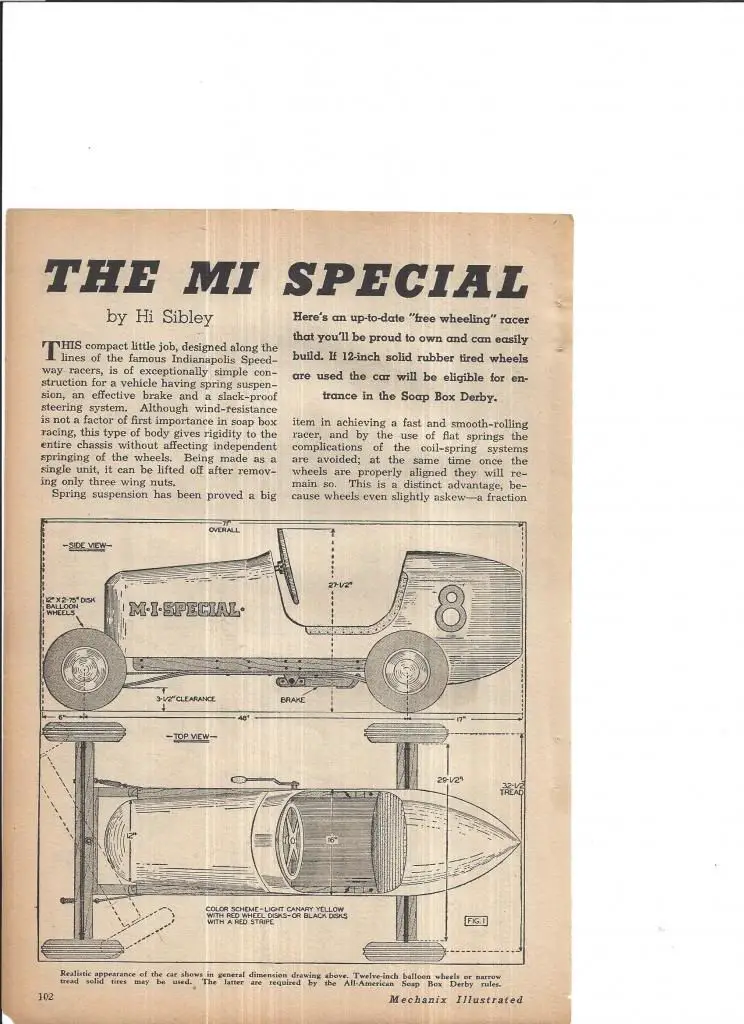

That is a cool little car, I'm going to try to remember to scan those plans at work and post them. I saw this car a couple weeks ago another for an Indian
Here are the soapbox plans from 1941, there isn't any copyright, as far as I can tell I have the only set of plans...including the Hi Sibley site. I also won some other plans from the 40s for pusher set ups and motor wheels which I will also put up in the correct sub forums.
