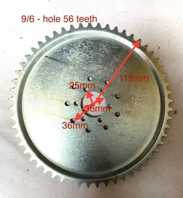

I'm building a hill climber, not a street racer or commuter. There are so many brands and merchants selling motor kits now that it's crazy.
I'm looking for guidance/tips on which kit I should select on a budget ;).
56 to 60 tooth sprocket
Hopefully sprocket adapter
If it's bad, I will do port clean-up
Adding generic Amazon spring tensioner x2
Cheap aftermarket carb
Here is my thread for more detail if genuinely interested!
Thank you for your time and expertise!

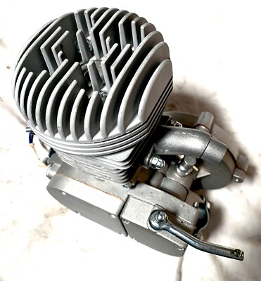

zeda type engine best I can tell, 8mm mounting studs, has the new style jug with long open transfers and a better than stock head for more compression nd better cooling.
I hvent bought one of these engines from him yet, but I hve been buying from this guy since 2009 with good results, some people cuss this guy, but after dozens of transactions over the years, I have zero complaints personally.
If this isn't helpful in some way, please ignor.
Definitely is useful and is not ignored!
I genuinely appreciate you linking me to a motor and giving me some background. I do like that it has the upgraded head and hopefully no porting needed since the description kind of insinuates the ports are sized differently (lmk if I'm wrong!)
I'll look around and try to find a whole kit with the zeda/bgf to consider.

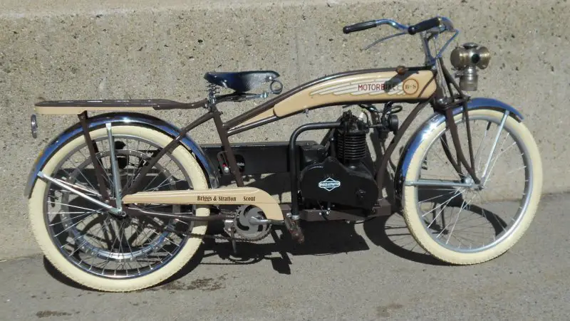

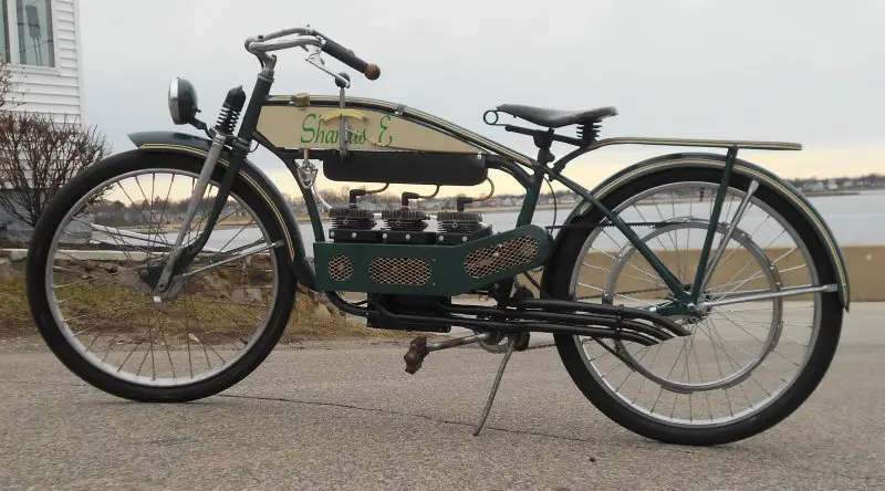

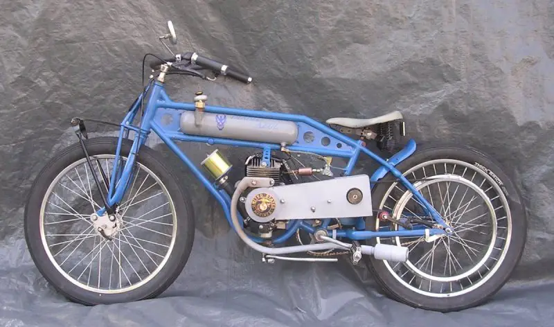

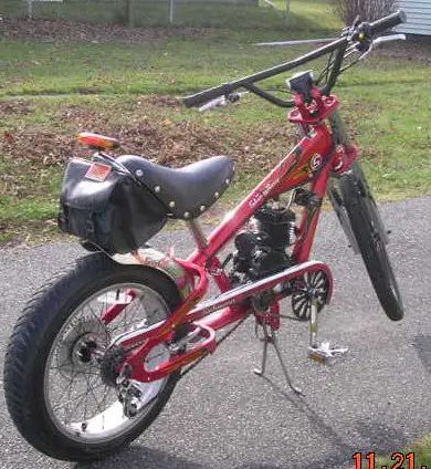

One of my first builds, about 9yrs ago. Was really to small of a bike but with 6 speeds it could fly or climb any mountain trail.

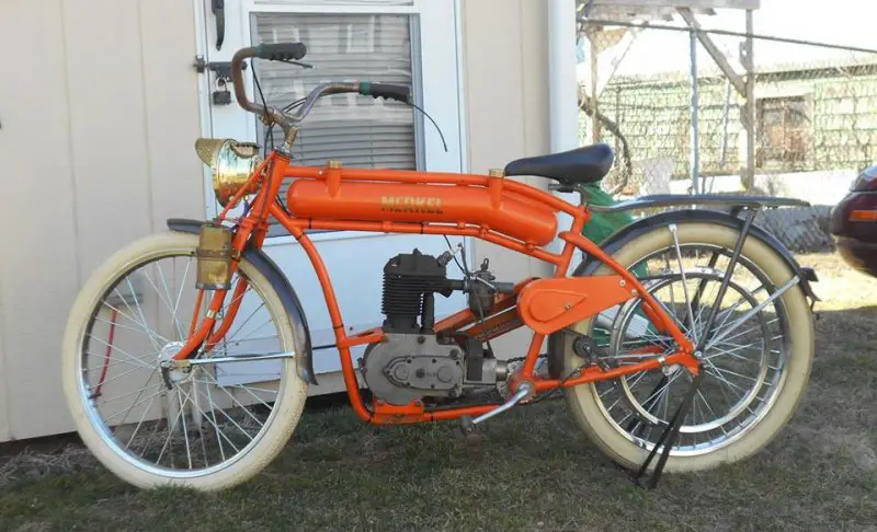

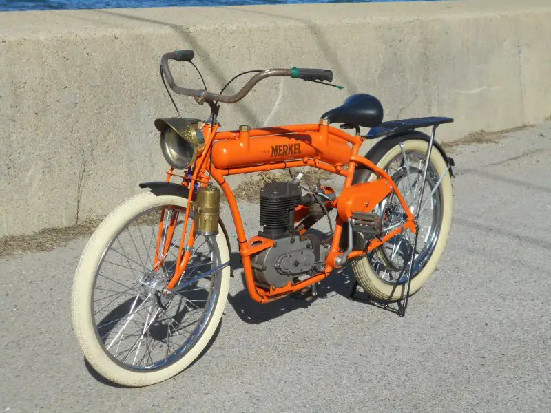

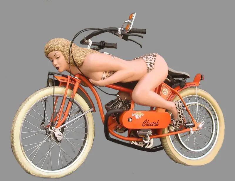

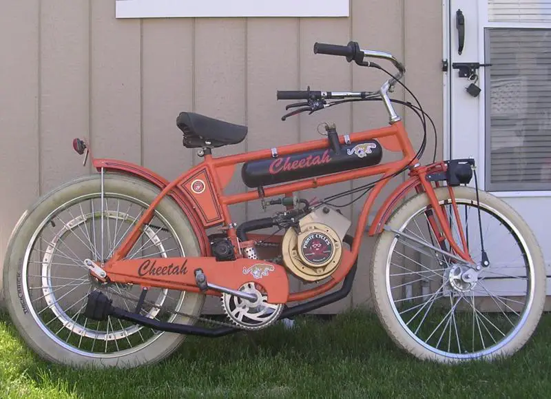

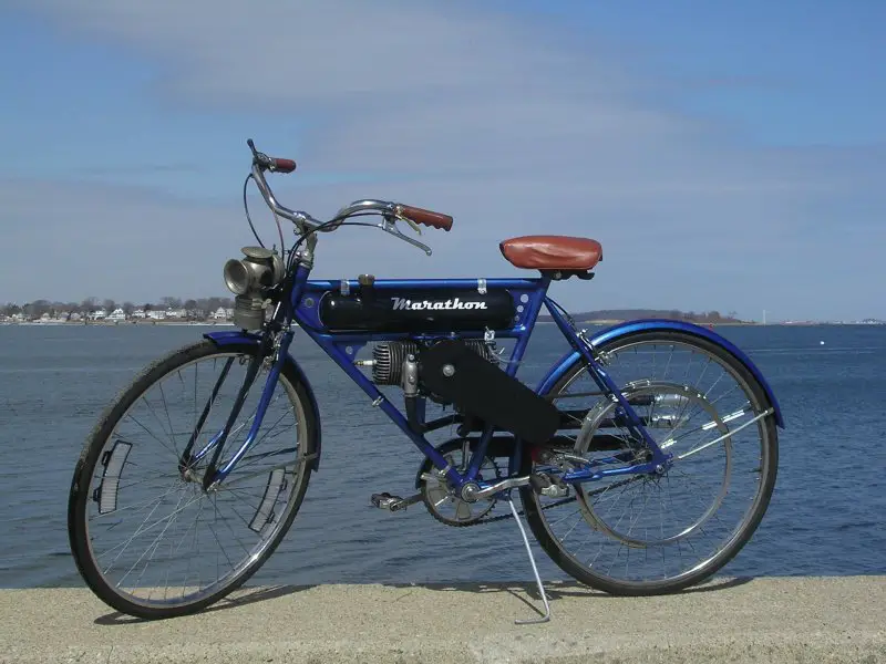

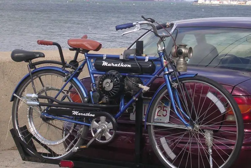

My blue build (Diablo Azul) has a variable ratio belt drive with a 5 hp 2 cycle engine and also can fly or climb anything.
The orange Cheetah also has a variable drive but only a 2-1/2 hp two cycle engine, still it will scoot!

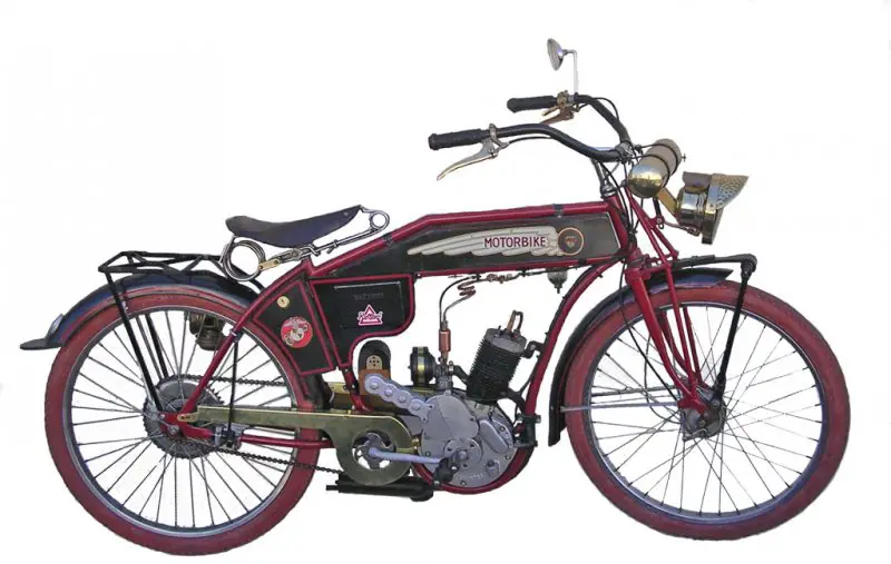

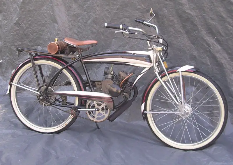

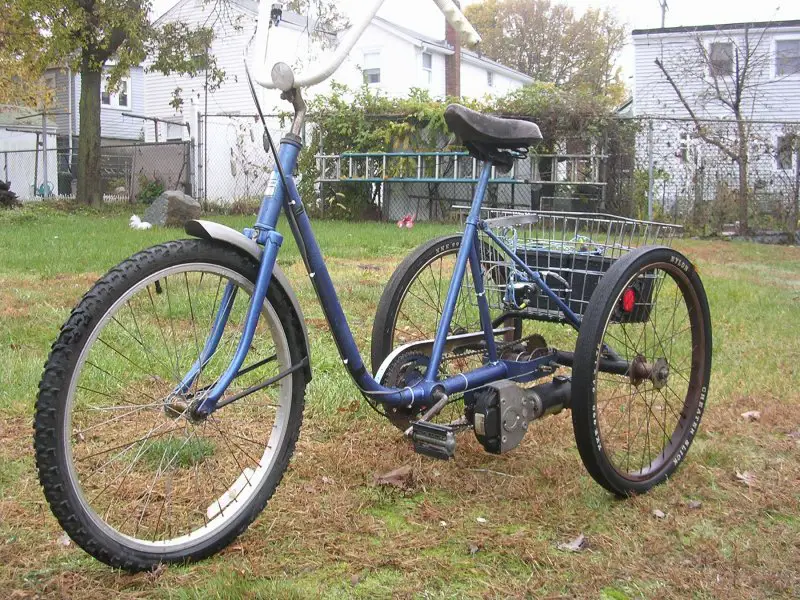

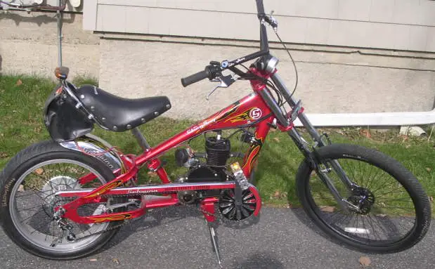

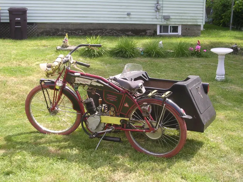

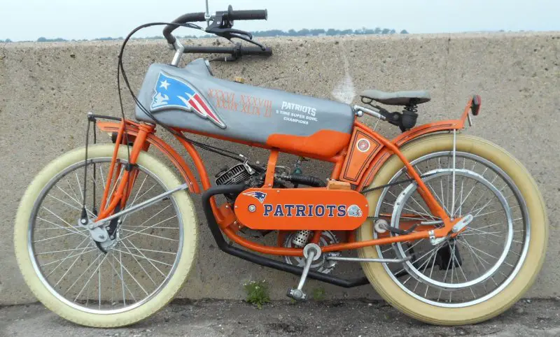

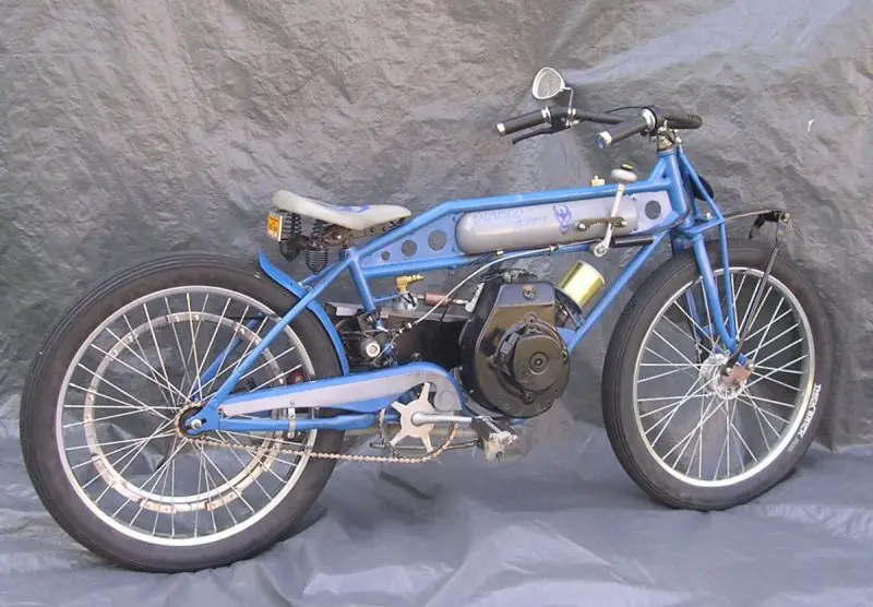

I still have almost all these builds and a few others. I believe that the 1927 briggs and the 30's gravely are my only 4 cycle builds.
