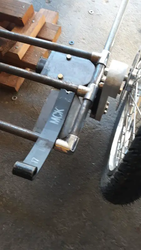

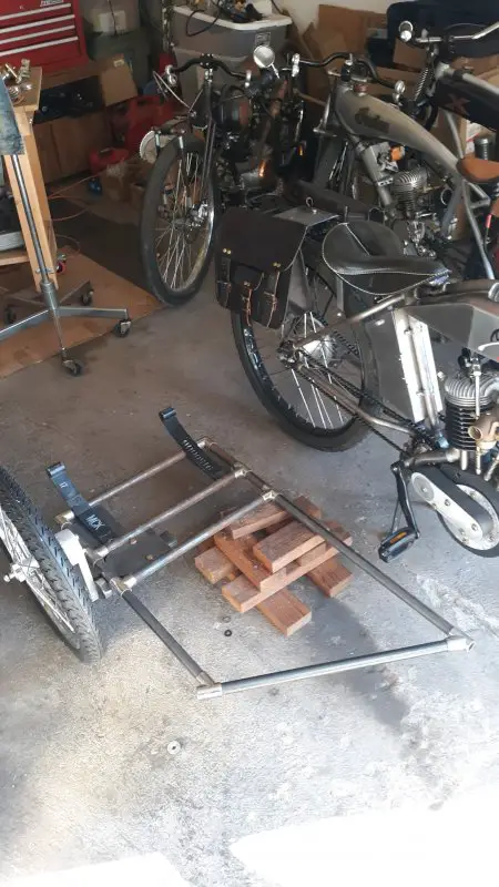

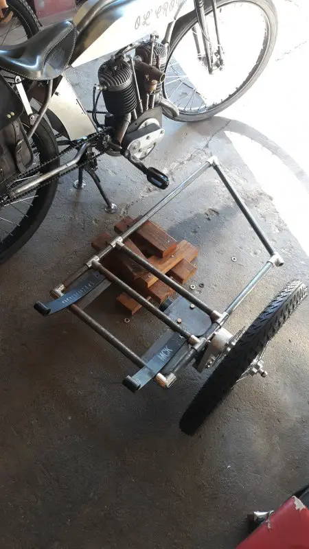

Pretty day here and got some work in on cleanup and side car frame which is 40" x 24". Wheel is 17" and tire is 2.25" DOT rated as is the wheel and hub.
Body will use two leaf springs and the wheel suspension is a torsion spring and of which are smalll utility trailer parts. The aluminum torsion arm drops the frame 4" as shown. Ground clearance shown is 2.5" at the suspension housing.

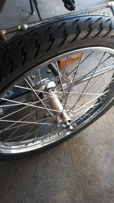

Brake rotor (shown) could be used but I don"t think it will be necessary to run a brake on this hack.
Those joint fixtures on your chair's frame sure make for fast headway, Rick. Loads of room for adjustment prior to final fixing. Do the joints actually secure well enough just with bolts are is any other method of securement - like welding - necessary? That brake disc looks great. Even if the rig doesn't need any more brake capacity I'd go with the caliper just for the bling effect. Imagine picking up your grocery shopping in this beauty!

Pete you guys are providing food for thought on the sidecar. Thanks to you all it's helpful and appreciated.
It's pretty dang cold here today, but warming nicely tomorrow and staying there to the end of November, so I'm staying inside for the most part and will get after it again tomorrow.
I've spent many hours over several years researching sidecars before I laid out the design for this sub frame and pieced it together several years ago. Basically what I photographed yesterday. There are potential underlying flaws discovered when projects drag on for protracted periods of time. The big one for me is changing bike frames which are each quite different, the Ol' Crow is the third iteration frame, and power train (also the third) so bike to car dynamics are different. I'll not elaborate on each but there are several elements involved. Brakes are just one of those, one reason I left the rotor in place and adding a caliper to the suspension lever is a modest task at this point. The original bikes were to employ disc brakes fore and aft, good stoppers. The Crow's vintage drums are not great and after one hard stop, and even that first stop isn't super. All three bikes were in the 150 lb ea. range and with the addition of another 60lbs or more of hack weight...I need additional braking for those times I may exceed a leisurely pace, intended or not. Steep decents come to mind. Thanks for the nudge and they will look nice, but not vintage...safety first.
Tube fittings are great for setup and changes, but not to be trusted alone. Frame gussets and plates will be added as will some additional fasteners here and there. Rear of the hack body will be connected to leaf springs and nose of the body frame to a swivel bearing axle.
Since I use functional pedal levers on all my bikes they really create clearance and mounting problems for a car rig. First of all they require
additional room to clear the car body and the mid frame support bracket. On the first two bike frames the kick start lever was a design problem that the electric bike doesn't present. Bracket attachment points on each bike were all very different, but the sub frame is really wide open for basically whatevever and wherever I need support and adjustment. I don't trust two point support, though some lightweight hacks, with which I would class this one, employ only two. I will use three and each with generous adjustment range for car alignment.
Your thoughts are welcomed and appreciated of course. Details matter to me and I always test everything ad nauseam during and after building
a rideable design and this side hack will be running "naked" till it proves worthy of a body. If I can't safely ride anything I build ( and I ride them a lot) there's no reason to flesh them out by mounting a body or accents to it.
I appreciate you guys more than you know!

Thanks Steve I actually have studied both of these and they are both very helpful. I had intended to revist the Mod bike instructions and now I have it located thanks to you. I tend to think I'm leaning more to small motorcycle or large motor bike rig connection, but using 3 points of connection rather than two between hack and bike frames.
Brake pedal mounted on the car frame can double as a parking brake on inclines too.
The photos of the torsion suspension mounted below the sub frame really limits clearance so I will try top mounting which will lower the sub frame a couple inches, but gain two inches plus of ground clearance. It should work fine either way though.
I decided against welding mounting tabs to the frame. I want it clean as a solo bike and be really quick to disconnect the hack.
Again thanks for taking the time to participate in this long delayed project.
Rick C.
