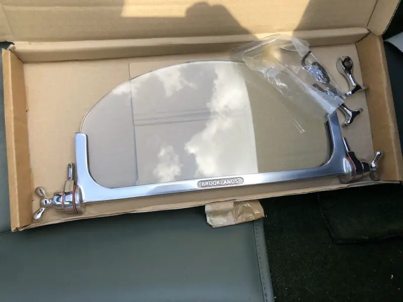

Not sure if you're planning on fitting a screen for your chair Rick, so I'm just gonna leave this tidbit here for your delectation.....
Nice! I'm not decided, but as the body height will be quite low the screen would be awkwardly tall to protect a passenger. Helmet and googles probably
the extent of protection in the hack.

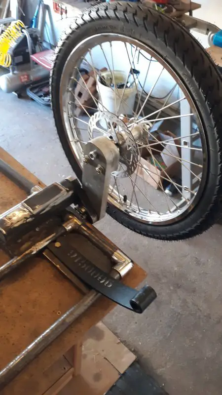

Made some progress today. The frame will have 3" of ground clearance now. The 17" wheels are 21" diameter with tire mounted. The rear tire on the Ol' Crow stands 27.5" so big contrast. This will be an easy car for the passenger to mount, but getting out might pose a problem for some even with a grab bar.

Now that the two suspensions are mostly sorted I'll turn my attention to locating and mounting bike frame connections. Then start fabricating the three brackets for the sidecar chassis. Both of these tasks are critical for a working adjustable design. After this I can test and adjust the assembled rig both weighted and un unweighted till I'm satisfied with the handling and my proficiency piloting the naked frame attached to my Ol' Crow....the fun part.
I will get started on the frame for the body mount during my testing of the rolling gear.no need to wait once the sub frame is up and rolling.

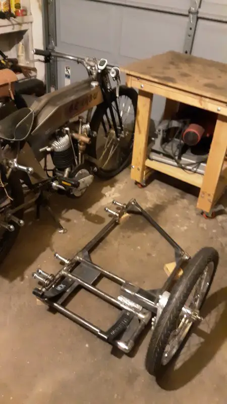

Okay reconfigured sidecar torsion suspension and positioned the leaves for the body shell suspension. Leaves height not yet determined, just locared in place with a single bolt for now.

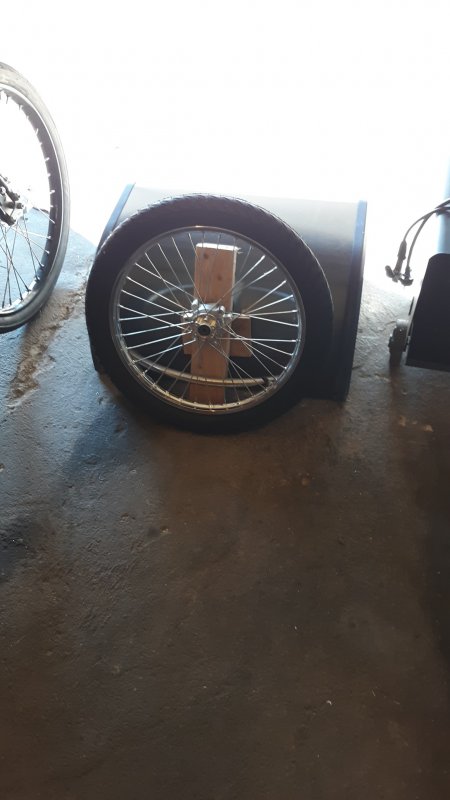

Decided to go with a Ural sidecar rear (32 Ford coup look alike) and spare wheel mount. I like the simple look. Did some mock up to get a feel for size and interior space etc. For the shell frame. Also help determine bracket stick out for sub frame get that wrong and I end up not having leg room between bike and hack and or requiring a shell too narrow for a average size adult (butt space only) 24" is still my target width.
That suspension change required more work than you might suppose.

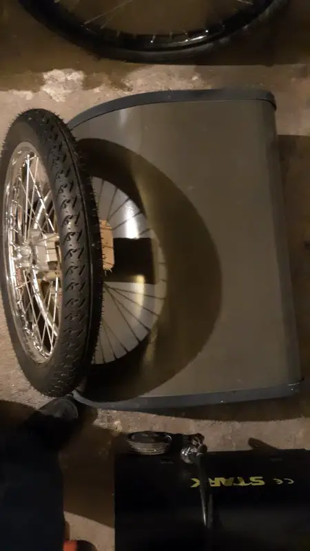

This is the basics of the cars rear shell, pretty close to the Ural. I won't use a tilting tire rack and trunk lid though, less stuff to fiddle with and rattle. Seat back will fold down to access the rear storage space. Points scored if you thought this a lid for a BBQ pit. It is exactly the size and shape I was wanting and there it was in the scrap! Spare will be a nice fit too.

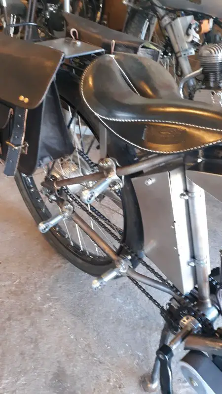

Just a few photos of the Ol' Crow setup with the five sidecar connection brackets. I should finish the corresponding brackets on the frame today and get a good start on the strut and standoff bars for coupling and aligning of car to bike. Great weather today for getting stuff done outside.

Good progress being made here. Nice job on the hack's reinforcing gussets. Can't see if they're welded to the frame tubes AND the corner brackets or if you've notched the gussets to clear the brackets.
Thanks Pete and yes the gussets are welded and notched. I wll also add a tube cross bar welded in place for the body pivot point.

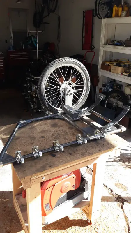

Thanks Steve. The bracket photos shown will vary from actual positions shown and are just representations at this point. My use of both Heim joints and the Harley tube clamps are my solution for allowing simple repositioning of support links and struts, which will likely be moved multiple times while searching for the best support and alignment placement. The brackets ultimately used on the side car frame might be welded in place once I decide on final locations for all the brackets.
I actually have two different ideas about how to connect the hack to bike, both fixed designs, not leaning wheel type.
I've started making up a couple of struts with clevis connections on both ends and one end adjustment using 1" steel tube and 1/2" grade 8 threaded rod. My basic design calls for five such links of differing lengths.

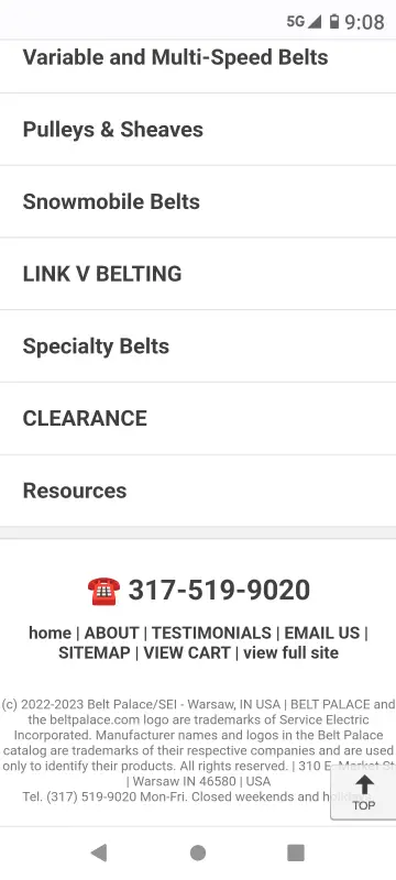

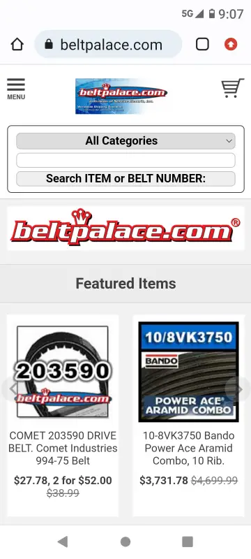

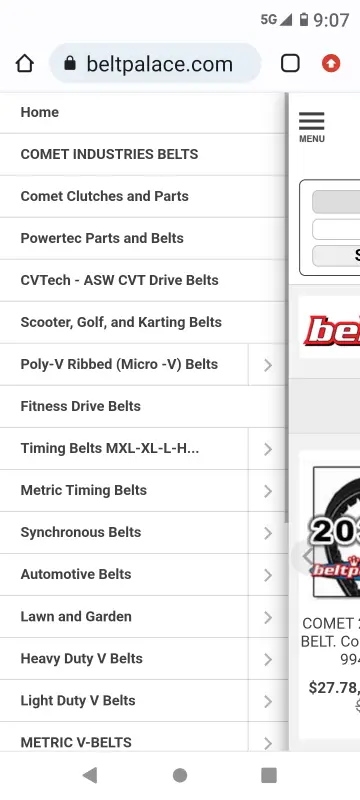

I heard about belt place from a friend who knows them and from what he said there just getting on the web and have decades of knowledge and great customer service... For when I do the predator build I got from a forum member... They have more than listed on the web if you call...
