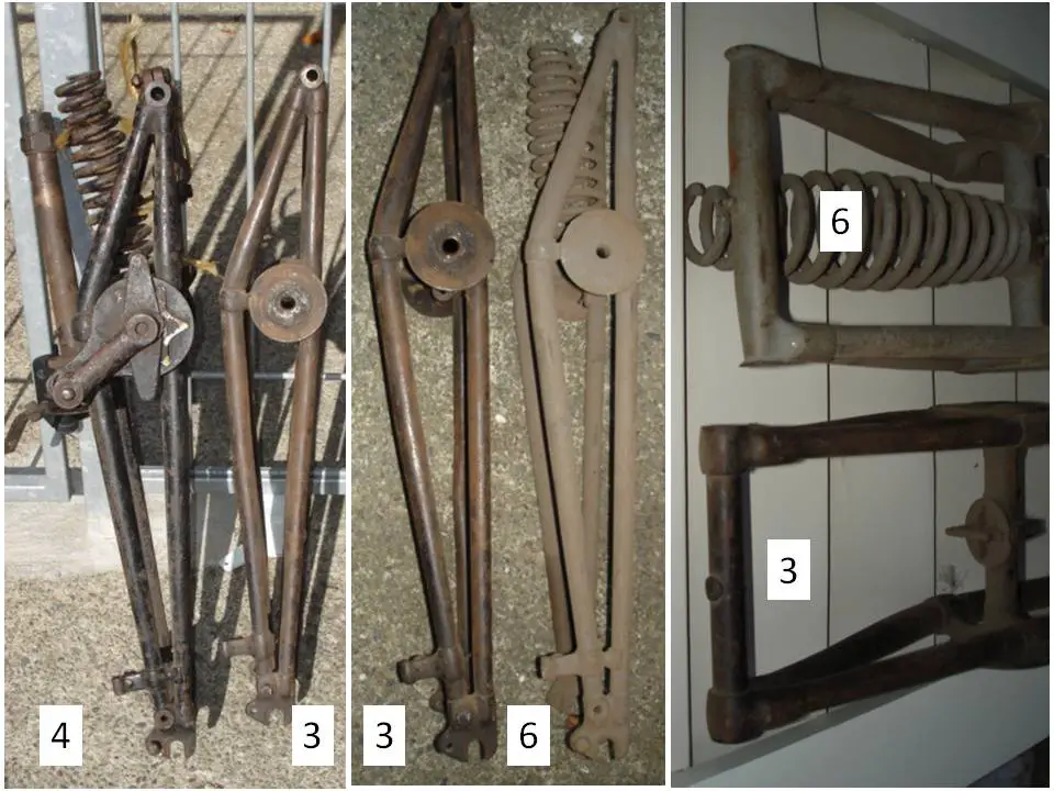

Ludwig I'd think the leather disk friction would be my choice for this one, but depends on how hard this fork rebounds. The problem is not so much the quality of ride or I would be using spring over air design to start with. The safety issue is my real motivator, so damping is important as well as adding additional fork stabilization for control at higher speeds. My Simplex Copper Gator doesn't exhibit control issues at 70 mph plus, even on rougher surfaces & the dual spring Sunlite fork does not feature damping, though I do run a steering stabilizer. For the V-twin I'll use both damping & a stabilizer.
I really like the collection of forks in your last post, yours? Rick C.
No, these were from a page selling old Norton parts I think. It's a shame you're not close to me, you could spend days trawling through the stock at Yeomans.
Ok Ludwig now I have directions. If I could borrow Pete's fine Morgan replica I'd be set for holiday!
Steve the heft is impressive. Width between the fork legs & the diameter allowed for axle bolt are really the only issues I see for light motorcycle use & both those are simple for a fabricator to remedy. Damping with traditional friction leathers, one on each side is also easily settled. The fasteners and toggles seem to be up to the task, yet lack an appealing classic look...also easily addressed.
