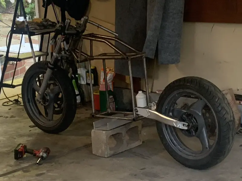

Haha thanks Rick. Doing this, gonna run my old wheels though and the swingarm in pic didn’t work out, just made a new one in steel. Soon! Can’t wait to see how your side hack works out. Always wanted to do one just never got around to it.

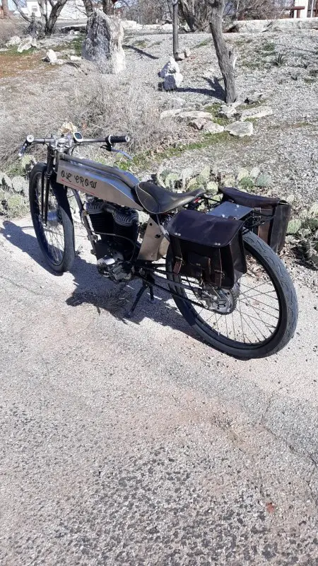

44 degrees and cloudy today, not bad but today is a back to the shop day. Work on getting the motor case finished to appear a 1912 Harley intake over exhaust gas engine. Copper fuel and oil lines with brass fittings and some aluminum case covers. Also I will fab a magneto case to complete the look of the motor. I may not add a primary chain guard as planned I like the open look and accessibility to the chain. I don't wear bell bottom Levi's so no chance to get caught in the chain using bicycle pedals for footrests. I'm close just need toget it done. Then back to the racing style side car frame, also close to having a rolling frame to bolt up to my Ol' Crow. Looking for a "monkey" to ride in the car too.
Rick C.
I just read through this thread. I hate to say but I failed to notice you have 3 threads with similar looking titles that start with “old guys” which had me confused (I use the new posts button). I saw you originally planned on running a 250 vtwin but with the reliability of your ebike will build the hack with that one. I must say that with the very realistic gasser look of your ebike I’ve gone into the habit of zooming in on every picture because even I can’t tell. It is so realistic I would not be able to tell from 5ft away in person. I have seen a lot of bikes, one or two replica types as well but it only takes a few seconds to see they’re ebikes with faux cylinders. None have the level of detail you’ve achieved. I would absolutely be fooled at a car show and it would take several minutes for me to figure it out, if I even did figure it out noticing the very, very minor details that give it away. Which I would never look for... but thanks to you I do now :D Well done Rick.
Thanks Tony like you I don't self promote well to get views. I'd rather ride or build...learning is way up on my priorites too.
I've didn't and haven't finished the motor case yet with cooper oil and gas lines complete with brass fittings, or aluminum crank case plates. I also will fab a magneto case and a brass oil "injector" on the gas tank. To that end I will add an oil bung to the gas/oil tank to sell the deal. The brass Schebler carb also needs authentic additions so I've waited two years to really make the case look real.
This style F head Harley intake over exhaust design was introduced in 1911 but full production began in 1912. Harley did not participate in racing at this time. They even advertised that If a HD bike won a race they had no association with that win.
My Ol'Crow is a 1912 replica of what was termed an "Outlaw racer" certainly not a factory team bike until 1915 when they started the HD racing program to cash in on the big sales of cycles that won races on board and dirt tracks. So my track style 1912 V-twin has lots of authentic elements, but a hodgepodge of components which an independent racer could run over a ten or 20 year career using the basic frame but adding newer stuff damaged in racing falls over many years of racing. This F head engine design was competitive on dirt tracks up into the fifties.
At any rate this is how twenties style forks are justified on a 1912 bike. Also this basic V Twin design was used by other manufacturers as well, it was a huge improvement over the earlier atmospheric intake valve designs.
I'm close to complete on these details to complete the look from 5 feet. The patina of the unpainted frame and bars helps to sell the vintage look.

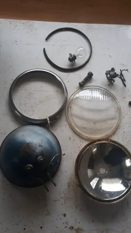

I've disassembled an old 6" 6v, headlight bucket that I guessed was a forties or fifties vintage, but could be decades older, as it's a style that's been popular worldwide since at least the teens on various American cycles and later scoots too.
Two tiny dings on the nickle plated lens retaining ring and the sealing gasket is hardened, but still intact. Thick glass lens is perfect as was the 6 volt bulb. Very slight rusting on the bucket edge. Blue paint wasn't a good job. The original paint was black and a nice, professional application was applied to the interior of the tin and still bright and shiny inside the bucket. It will cleanup well and I will start on it today. I have the led module to convert it. The reflector is also still quite good 90% at least. The bracket is solid so fabrication of a fork mount is a simple deal. Lights front and rear, illuminated full time are a big safety item which I'm giving into.
