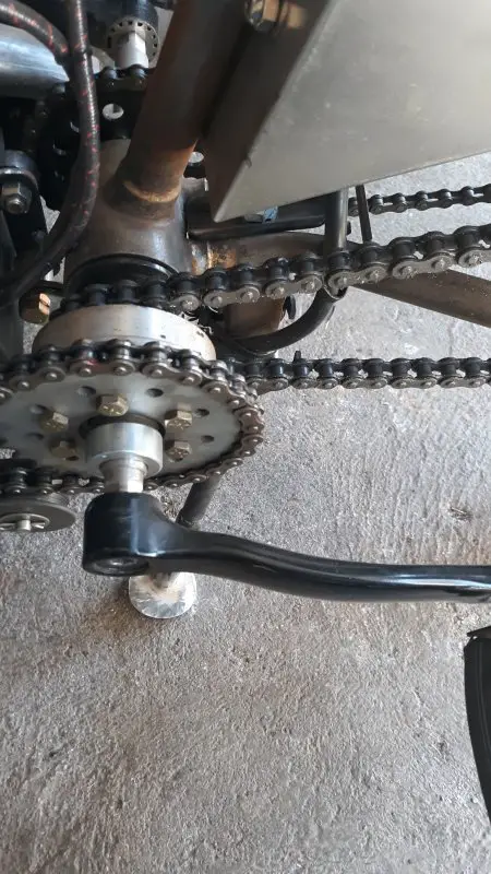

Clean and adjusted chains while I modified the lubrication of my reduction sprocket, I'm ordering new chain for the primary drive, I used a piece of old chain, shouldn't have, but did so time for replacement. It did last 2 years however.

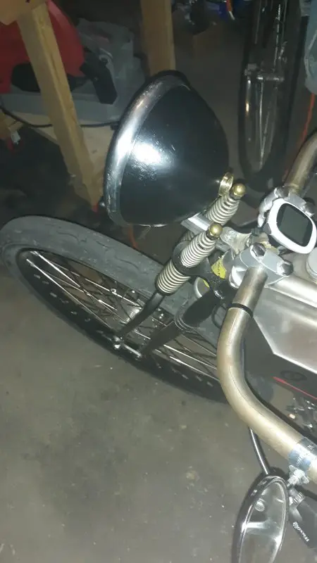

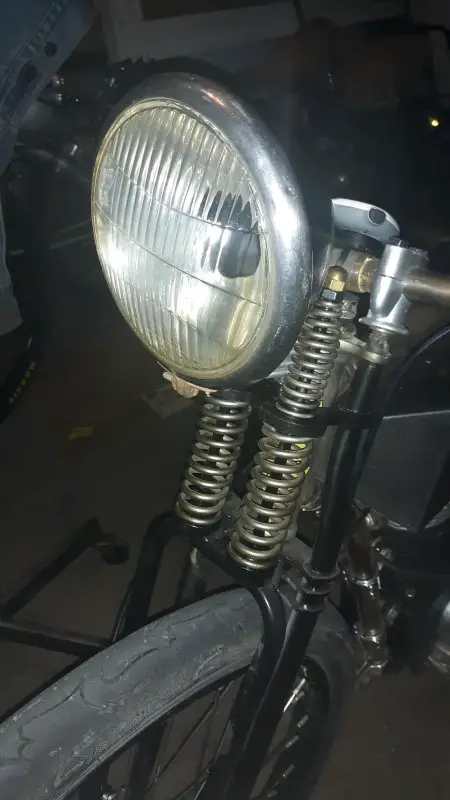

Headlamp got some paint and is mounted. The wiring of which led me down a rabbit hole of electrical stuff and how to reach an electrically sound bike which functions properly. To lengthy to go into at this time, but adding a third 20 amp hr 48 v battery, all three running simultaneously through a balancing parallel circut and a power analizer is the gist of my plan.

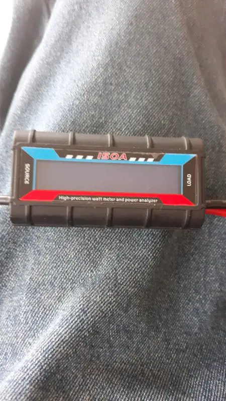

I have a 150 amp 60 volt analizer which I use on the bench but will mount it on the bike to track, in real time, my power consumption. Along with a GPS for the other aspects of my rides. Though not a fan of digital readouts on a vintage style bike I plan to disguise it a bit....in plain sight.
Other stuff like the Sprag clutch has progreesed well but I have a sprocket on order that slowed me up.

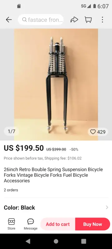

Those springer forks came down in price so I got another one...

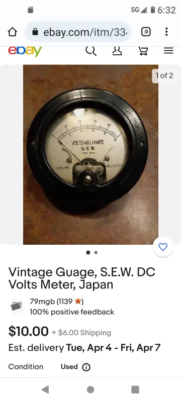

eBay has a bunch of stuff if you're looking for an old timer volt gauge

Those forks are way down in price now. The analog gauge is what I prefer in volts and amperes, but I need at least 60 amps and most don't go that high. 60 volts is fine though. Smith makes some small diameter sizes in analog. I'm still checking thanks for the info share.

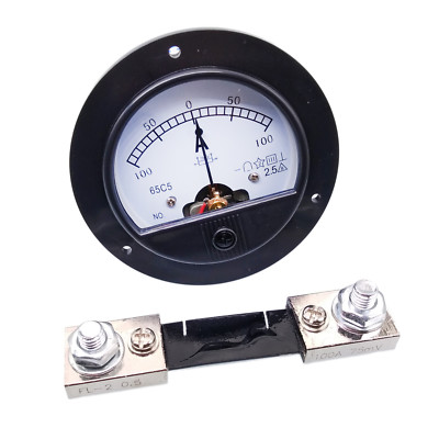

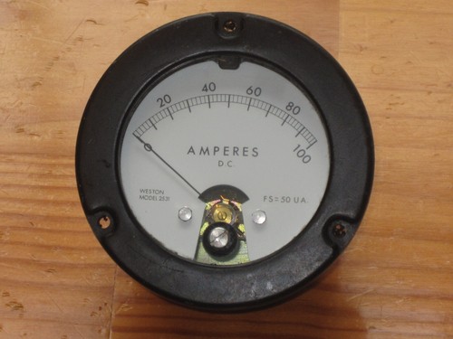

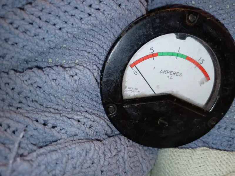

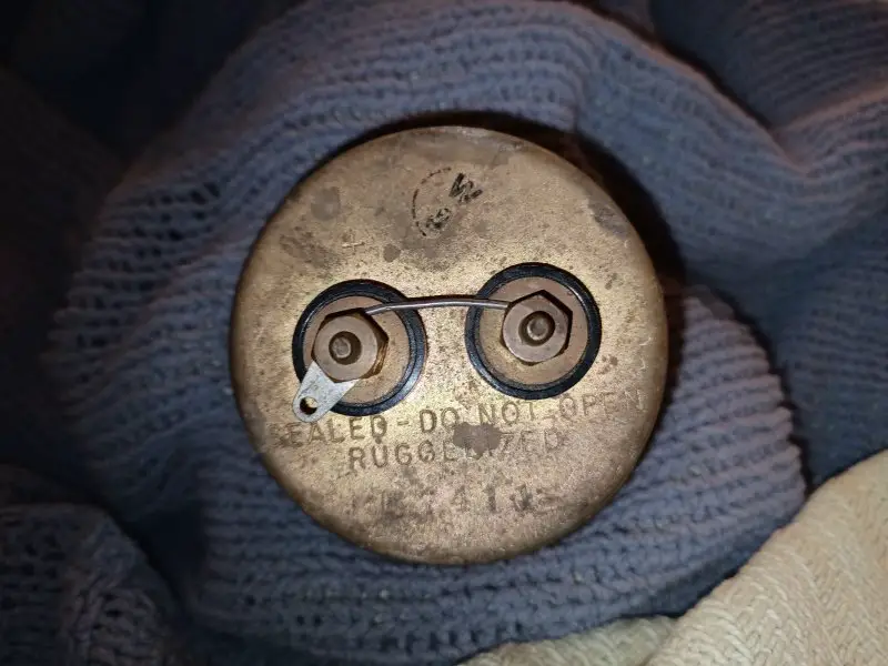

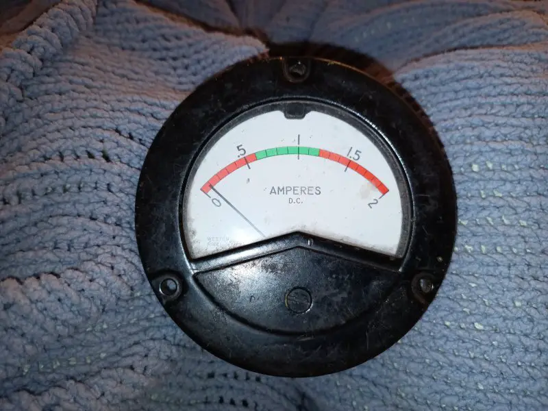

About old style ammeter that runs dc amps to 100 dc amps. I have an old one with attached photos you can see. The shunt on this one gives 2 amps DC Full Scale on the Weston Model 2531. They don't exist any more though. Other company similar name is different business. The shunt is just a wire on the back. Calibrated close I will check. Used to use it when charging lead acid car batteries on a slow charge. I still have the large big finned selenium rectifier that was used with the Lionel 250 Watt AC Model Train Transformer. I suppose some nichrome wire that I have for my hot wire foam cutter could be added to fine tune as a calibration shunt.

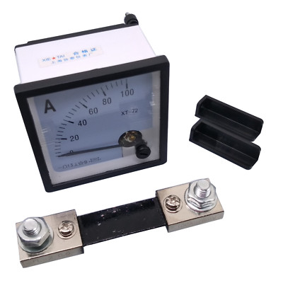

Another I saw was not US Made, but does have a large shunt to use to have the scale that already exists on the meter go to 100 Amps DC Full Scale.
Anyway just a thought. I though would much rather a clip on ammeter to sense a small amount of current and have it run a panel meter in micro amps that would equate to 100 amps on the handle bars or near that.
Running even some fancy wireless gadget that takes a small sample of the current being used or generated (generative braking), for the scale that goes - 100 dca to + 100dca on an old style meter would be a neat trick!
The overseas stuff meter image:
Ebay links to some of these ammeters.
other not showing ammeter shunt
Maybe the person selling used does not realize you need the shunt or else! I suppose maybe the meter without is goo for miliamps, maybe 50 mA DC max Full Scale?

Thanks for the links and photos. I really like vintage gauge sets.
I will however use digital for my bike and try to disguise them a bit and keep the gauge footprint small while providing needed data.
My wireless GPS speedo is small and the analyzer is as well, just need to machine a dashboard to house both.
