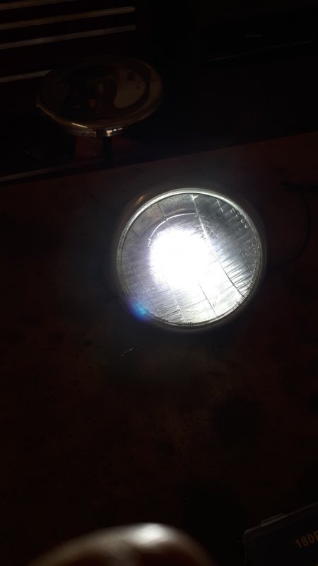

LED mounted right up to the reflector and the conversion was really simple, good light at only 16v so it's all good. The bracket also was simple to make and solid, and absolutely no shake. I think it would look better mounted 4 or 5 inches lower though, so I'll make a second bracket and see how that looks and works.

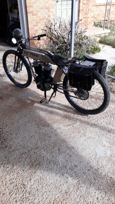

Recently I've invested quite a bit of time revisiting the amazing steam engines, both actual historic engines and current hobby recreations or restorations of famous designs. Steam powered cycles are a historical category, subset, of steam transport. Your Ol' guy is onto it!
I lurked this forum and built motobikes for several years too.
My Ol' Crow isn't a copy of a Harley. Though that's how I think of it; it's more a composite of manufacturer designs extant during the first two decades of the motobicycle. I lean towards the racing look of a weekend racer and a weekday work transport bike, but not a factory supported team bike. Regular people raced, but couldn't beg, borrow or steal a real team bike. They weren't for sale. So weekend track warriors pieced performance mods together to be competitive, they were the original motorcycle hotrods. Most of these were powered by intake over side pocket exhaust design motors which HD V-twin owners some time raced the same basic bike for decades on flat tracks and hill climbs. Bikes took a pounding with accidents on track and when old parts could no longer be repaired and used the parts of newer bikes were used as replacements/upgrades. Tins and forks were really common replacements as were handlebars. Also these bikes in some cases were used in both solo and sidecare events so forks and handlebars were switched between events. For my Ol' Crow I have wide bars, for sidecar and daily riding and downturn solo racing bars for board track and two different forks (simple girder and four spring). Four springs are more a late 1920's item on Harleys as is the style headlight I'm using (though Indian and others used this headlight bucket on earlier bikes) it was a definite lighting upgrade to carbide etc.
My frame and tank really look like the Reading Standard board track design to me. Check out the only known example housed at Wheel's Through Time's Maggie Valley exhibit and I think you'll see what I mean. Also I kept the motor drive side simple like the Reading Standard. Pat at Sportsman Flyer really built me a fine frame, to my design specs and fit his big battery "fuel tank" in it. The full scale size 61 V-twin engine case fit perfectly with no need for any frame mods. Great work as always from Pat!
As far as performance goes my electric using 48v and 40 amp controller can equal the Harleys 1912 advertised speed of mid 40's mph with full charge. Going to 72v and 70 amp continuous it easily runs high fifties. Daly riding for me, 48v is what I prefer and I have three motors and several controllers which are simple to just plug and play on this bike.
Original track bikes ran 2.5 to 3 inch wide tires on 28" rims. I use 26 inch x three which stand 27.5" tall on the Ol' Crow. Pretty close to original without the cost.
I did indeed plan to mount a 250cc Yamaha in a frame and had everything in hand to do so and I think that's a great setup still, but I really wanted a engine that looked original early teen's so I waited and the Ol' Crow developed and it doesn't leak or smoke and fires up without a push, wheel pull or pedal and it has a reverse for the sidecar. Three speeds, hand shift lever, not yet hooked up and eventually running a full suspension side car with foot pedal activation of a disc brake, definitely not vintage, but the bike's twin drum brakes just not up to stopping the weight of a side hack even from a modest 25 mph.

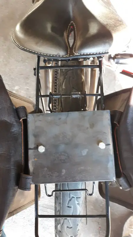

My thought on replacement of the lightweight pedal bike rack, is to use the steel saddle bag supports and attach two heavy duty tube supports to the big axle plates on each side. The result is a much smaller length rack, but able to support a lot more weight with no rack movement and without drilling additional holes in the axle plates. The saddle bags actually covering the support legs, except at the axle plates. Overkill support for batteries, but able to haul an adult in an emergency. A shorter rack also alows me to run 5" barrel coil saddle springs with full articulation using my saddles existing mounting hardware with out striking a rack or rear tire.
The current rack held up better than exprcted but with batteries in both bags it's not a matter of if it fails, but when? The answer is at the worst possible time.

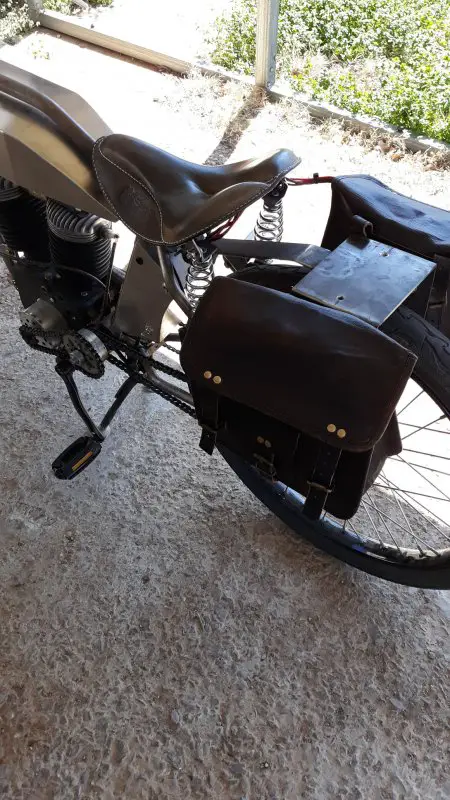

Hi guys yesterday was a good day. Lot's accomplished on the Ol' Crow.
I rethought my saddlebag rack and simplified it while making it far more robust. Really strong and useful design. No bike parts used all heavy steel plate and welded construction and super compact. Can bear the full weight of a 200lb. rider and two batteries. A longer rack can quickly bolt onto the small rack top to equal the length of a standard cycle rack or a box can bolt on for enclosed hauling, or use a wire basket. This is a Swiss Army knife of bike racks!
This small footprint allows room for saddle flex when using 5" length barrel springs too. I have good tire clearance as well. Rack allows tire change without removing rack or bags. Lots of room to mount a tail light bracket too.

Thanks Curt 5" springs out for delivery today. I will halt other work to get those mounted. The bag rack was my prep work for installing these Harley Springs, not cheap pedal bicycle stuff but real deal cycle heavy duty saddle springs. These don't bend and lean to the side after a couple of weeks use. Think this will really improve the ride.

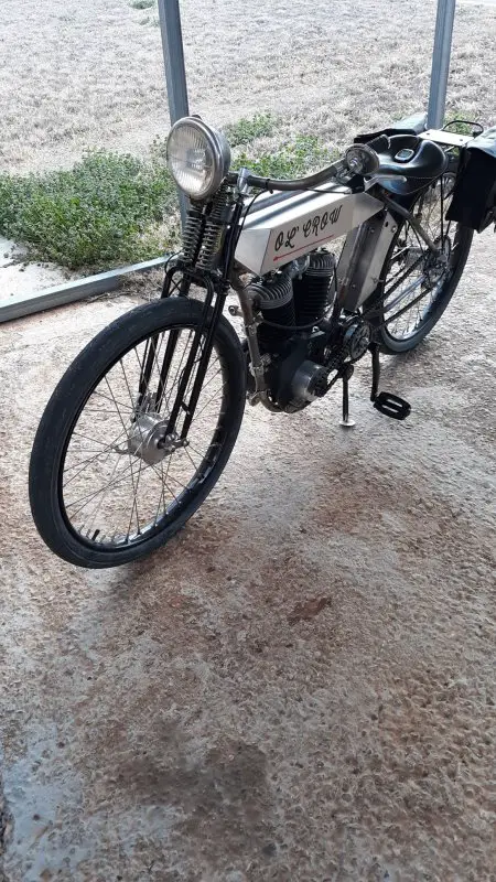

Well the barrel springs are mounted and I'm pleased as they are not rigid, but dang sure don't flex much. I'm certain they will hold their shape long term.
Headlight bracket tomorrow and brass light switch. Followed with wrapping the bar grips with black heavy leather boot strings.
My bike is pretty heavy so the four springer fork is now set quite firm, it was a bit spongy for my taste even as a solo. With or without the sidecar I think this is now a good fork setup.
I'll take photos this weekend.
Eliminating the 35 amp discharge function of the 48v BMS frees my controller to work to its current capabilities and adds a couple more hp. The low gearing with my reduction gearing won't allow much more speed using the 44t final sprocket and that's fine, but it will add a lot of extra torque for the side hack. We have a lot of rolling hills here and very few actual flat roads even in town so more power is a good thing with a heavy rig.

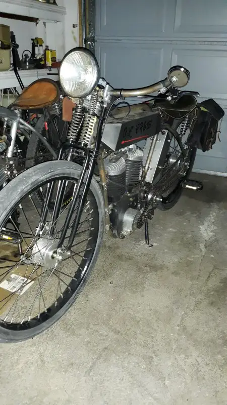

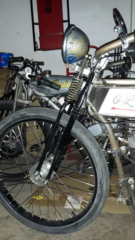

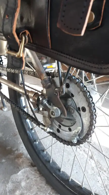

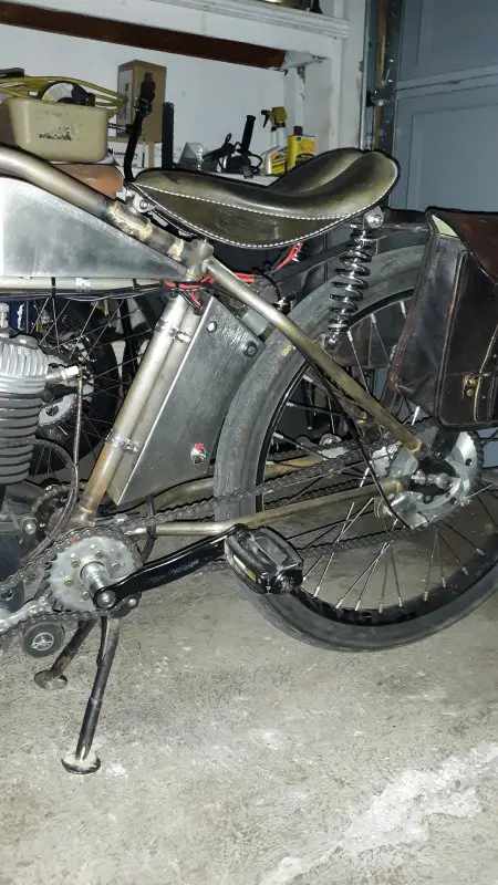

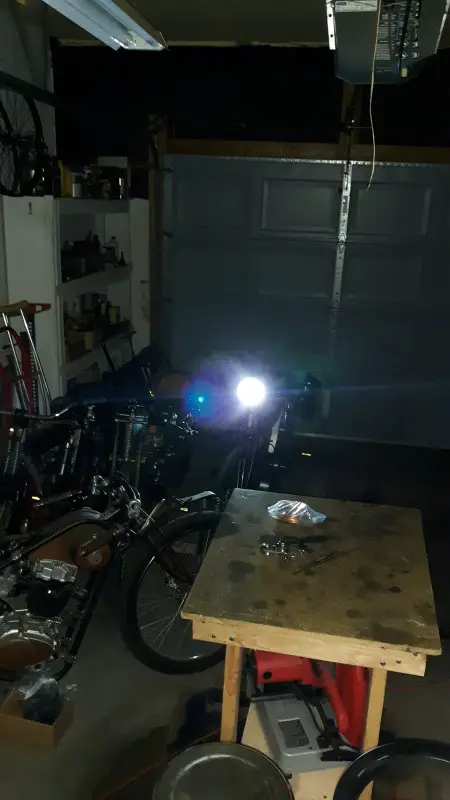

Bad photos but proof of actual work progress on Ol' Crow. Rack, saddle springs and headlight; that head light throws a beam! I did lower the headlamp 4", so split the difference.
A lot of wire management, paint etc yet to be addressed, but so much yet to do before it makes sense to tidy things up. While this is going on I'm also riding her everyday, so she's fully functional.
