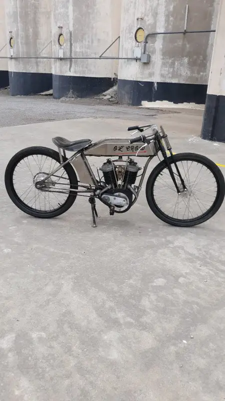

Well I'm getting back to my dead thread V-twin sidecar build. Pulled out the half finished frame and suspension parts (torsion spring) for the side hack and rethought what I now have to work with.
I'm long past the Yamaha 250 V-twin concept (which I no longer possess) and the side car mounted,with an electric motor in the side car frame to power reverse the rig.
I now have a V-twin electric (The Ol' Crow) which has a reverse function on the controller. Not at all useful for the cycle alone but just the ticket for a side car rig and really simplifies the car fabrication. The Sportsman flyer frame is robust enough for a lightweight sprung frame attachment car. I plan on the body being pretty small in length, height and width. Very low ground clearance to match the bike and a 17" cycle hub, wheel and tire, all of which I have. as you can unders I paid for all these parts years ago for this project so time to actually build and mount it!

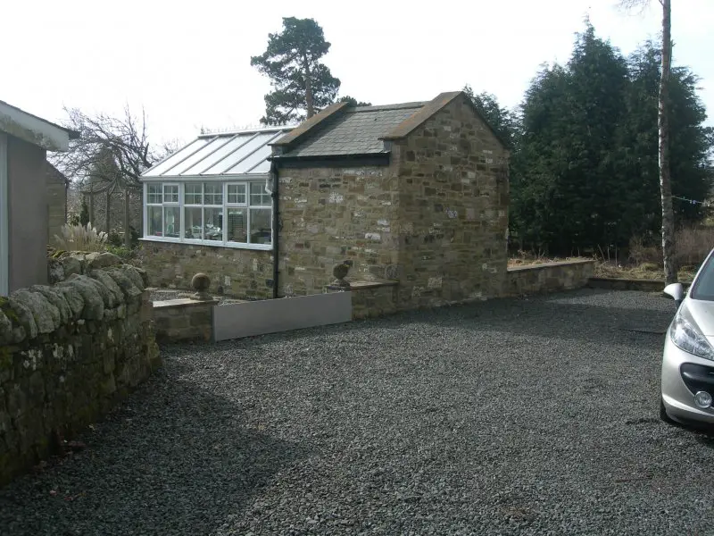

Just a thought. Might you consider using lightweight square aluminium tubing for some of the sidecar body's framing? Couple of years back I created several robustly braced, double skinned, flood prevention barriers for our converted barn home in Netherton. Using fully riveted/adhesive construction and fitted into channeled frames with butyl rubber seals they worked so well that neighbours and a local builder asked me to make bespoke versions for their properties. Fun to design/build and I reckon I'd use a similar technique for any alloy-bodied sidecar I planned to build. Man, I sure miss the workshop/studio/garage space I enjoyed at our Netherton house. Nothing other than lounge space available to me here in the Alnwick apartment. But at least I'm still able to build stuff....when the spirit is willing. :)

Having a reverse e motor controller makes this so much more practical for public parking and storage. Plus not having any concern for staight line road speed is freeing for side hack alignment purposes. Handling at under 20mph isn't as critical as it is for highway speeds.
Your correct Pete this should progress pretty quickly as projects go. It's another no paint wanted, but patina required build. Character not perfection preferred. To be ridden and not for display only concoction of metals and attitude!

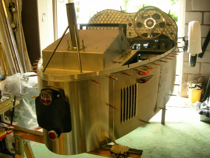

Be great to see a riveted ali sidecar on your Ol Crow. I'm sure you're already aware of them, but the biggest aid to rivet construction is Clecko Pins (pic below). Whoever came up with them in the aircraft industry deserves a mention in dispatches. I'm sure I mentioned it before, but they were indispensible for precise body panel alignment on my Aero Cycle Car trike project. Also those flood barriers, which although not discernible in the photo in my previous post, featured rivets every two inches. Shame they spent their entire time hung on the garage wall and were only installed into the driveway openings when there was potential for flooding.
Pete your tri car was great. So are Clecko fasteners and your right it's a genius idea for sheet metal projects. Salt lake/dry lake streamliners are my first recollections of their utility outside of the aviation industry.

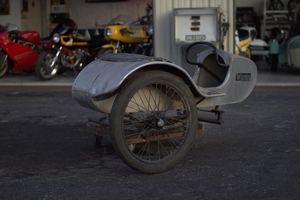

Thanks Pete that length is close to perfect and I really like the simplistic lines with the rear body blending into fenders. That had not occured to me. Actual body height isn't too bad, but ground clearance is probably 12" higher than I envision, but my frame and wheel diameter would allow for that. I also like the idea and look of the body not extending much if any past the rear of the body.
The passenger grab/assist bar is close to ideal. All in all a nice design with some very appealing elements Pete. Thanks again for bringing it to our attention.
I've a spare wheel and tire for a rear mount on the body and this design would allow a spare to be fitted. I'm not considering a "trunk" as a feature for the car. Since the body will ride so low there's no need for a deep mounting cutout, except as a stylistic element.

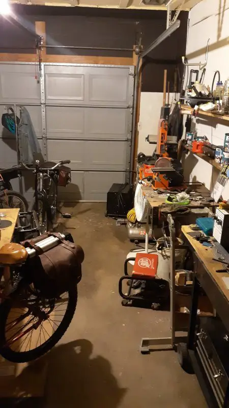

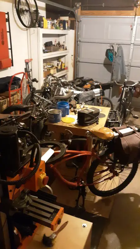

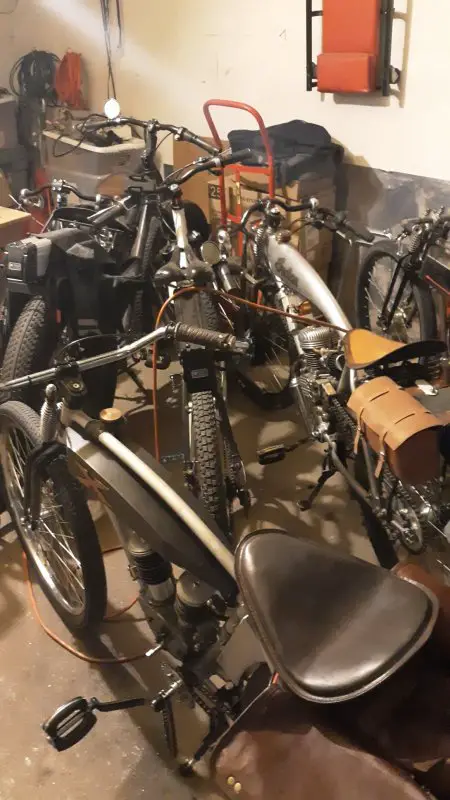

I need to get several bikes moved out of the garage to storage next and then move parts to the basement for the Winter to make enough room to work on the side car. Snow needs to melt first. Then I begin. I'll take a photo of how jammed up my work space is at the moment.
