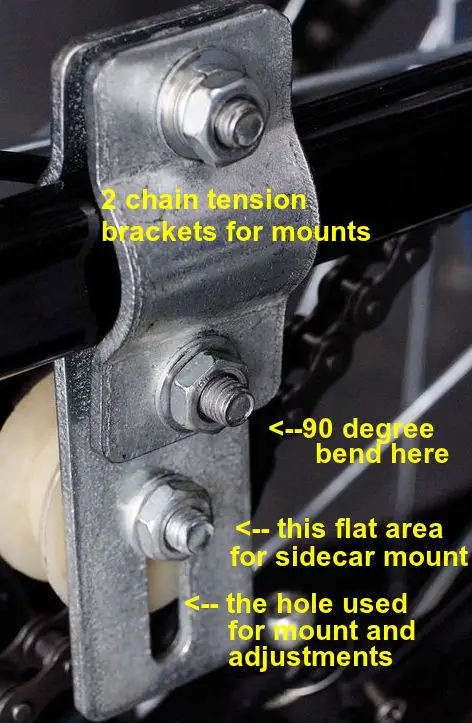

I am thinking about using 2 chain tension brackets to mount a sidecar on mine. With adding the 90 degree bend the tension bracket will have a little shelf, and the hole can adjust for toe in. With a Heim
joint/tie rod end mounted to this.
I'd think a lite hack would work well with these brackets and speeds kept modest. The 4 bolt tension clamps are really quite robust.
Using four link rods is the plan for my Simplex rig hook up & Harley Davidson tube clamps on the bike frame.
