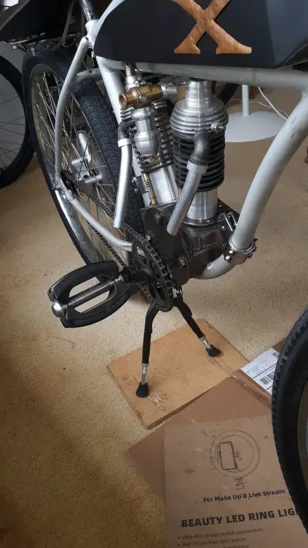

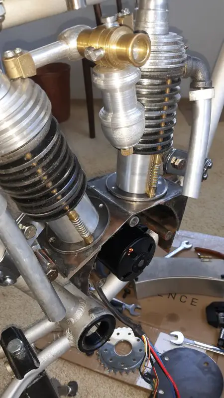

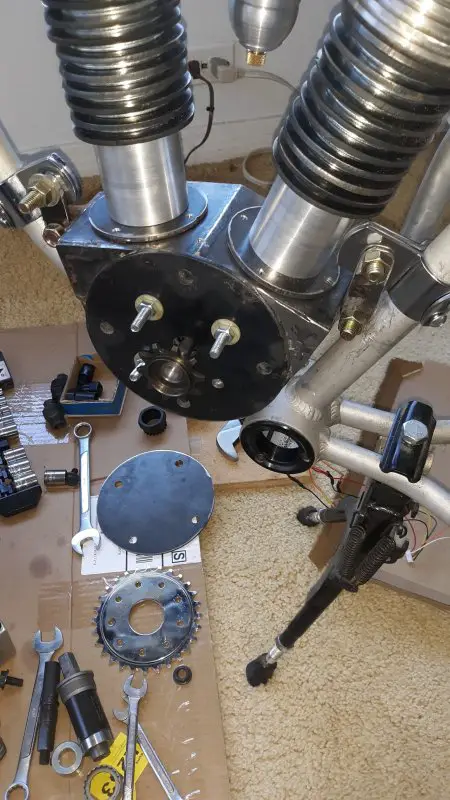

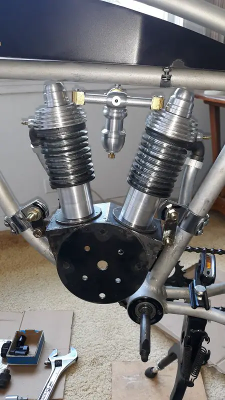

Got going on the Schwinn e V-twin again today and now have the motor case securely mounted in frame.Now I can set up the offsets for primary and secondary chain lined to get dimensions to machine the reduction sprocket drive. The case is about half scale to fit in a cruiser style frame. Weight with 36v 20 amp hr battery should be about 75 lbs. I think I'll need low gearing on this setup so I have a 54 tooth sprocket on the rear as and I 'll run 2 to 1 reduction from motor to reduction shaft
I plan on working inside on the Schwinn during the heat of the day. Ol' Crow in the mornings outside while it's cool. Try to move both projects forward that way.

Motor is mounted in the case with sprocket. Had to verify position to determine the width of my reduction bracket which will be very narrow only 1.5" or so. The motor sprocket is a 10 tooth. Which will drive a 28 tooth which is a 2.8 to 1 ratio
And I should be able to drive a 14 t to the 54 tooth rear. This ratio is lower than I mentioned earlier but the big 54t is really the easiest for me to change out if the speed is too limited with this sprocket selection and I have a lot of different rear sprockets I can choose from: 48, 44, 40 and 36 tooth are all in my parts collection.
Photos show fasteners sticking out of the case an inch or so but that was just easiest to do with what I had handy at the time. It all comes back out now anyway as I have more to do on the case and the motor is just in harms way at this time.
4000 watts continuous is a lot of power at 36v so amps are 110 continuous to reach that number. The motor is rated at 4000 watts continuous and the controller is too. The controller uses 100 volt caps so I would think the controller could easily take 48v but those that have tried it at 48v and 110 amp burned stuff up! Not a good idea to me.

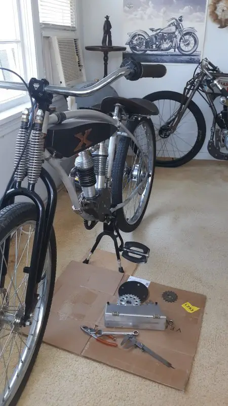

I started my pedal bracket/jack shaft for the Schwinn this afternoon and made good progress on it. Simpler design than the last few I've made. I won't machine the reduction gear until I finish the jack shaft and mount it on the bike. That helps get the chains close to perfect, that and having the motor case set up in it's final frame position. I have some wiggle room as well.
I weighed the V-twin case with e motor and they weigh almost 20 lbs together with controller. Very light weight. Case is 18 lbs of that.

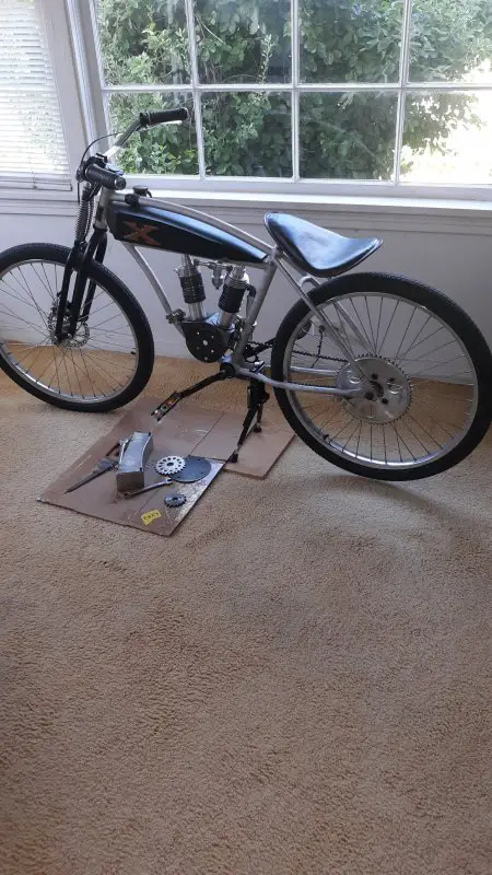

Getting back to the Schwinn electric V Twin I should have the drive train installed with the reduction drive, chained up and rideable this week. I will start with 36 tooth rear in place of the big 56 tooth rear sprocket. Several factors involved in this and high speed isn't one of them. Efficient motor speed is, back to wasting energy through heat generation.
This Schwinn aluminum frame reproduction with Sunlight dual spring forks tracked well at 35mph using a 66cc China girl, but I may extend the wheelbase by 4" for improved tracking. I did this mod on my hybrid Grubee and it made a big difference at higher speeds. I also prefer horizontal rear axle drops for efficient two chain management. The bolt on aluminum and steel laminate extension plates have survived a lot of miles on the Grubee without problems and have eliminated short WB tracking issues. Really makes a difference in riding fast and with confidence.
I still plan a rear rack and saddlebags for batteries and not using the fuel tank for anything at this time.
First things 1st. get her running and ride for awhile. The rest can wait. At any rate riding is fun and not at all work.

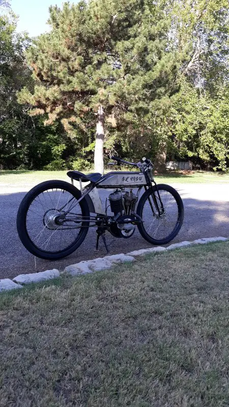

I rode Ol' Crow for an hour this morning and it was perfect weather I hated to stop riding but have a lot to get done. The reduction drive seems to be working well and all three chains track perfectly.
I 'm not sure why but this bike pedals great for a heavy bike. It's geared pretty low so it's good for up to 8mph with hardly any effort on level road or even slight inclines. The only change I made was a new chain. Magic chain? I run almost 60 lbs in the Vee tires but that's what I've always ran. Anyway I like it when I can pedal without using a motor.
Speed is fine now and motor was cool after the ride. I did hills etc. It purrs at 30 with no component heating. Nothing more than warm to the touch after the hills.

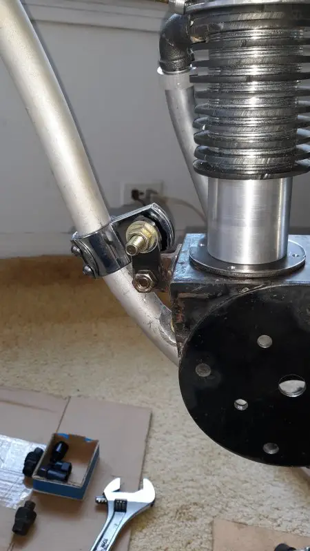

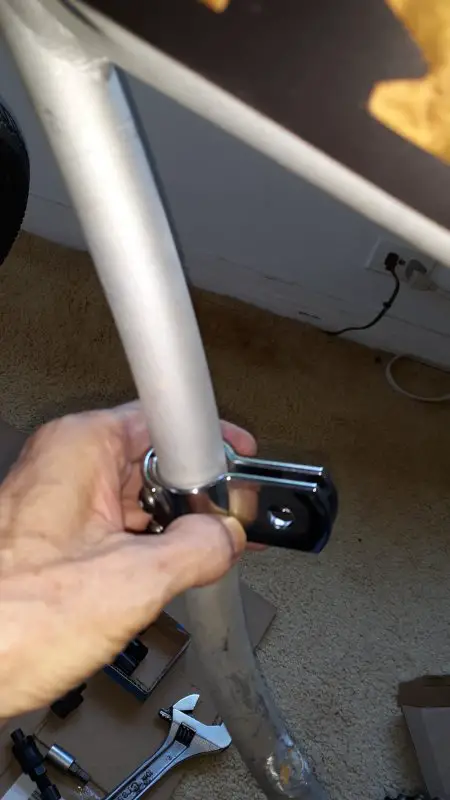

Schwinn primary chain adjustment will be to lift the motor case by just loosening the tube clamps, the toggle strap connection between tube clamp and case mount allows this to function. The problem is I need to lower my motor housings overall height to accommodate such adjustment. So simple a solution I almost overlooked it.

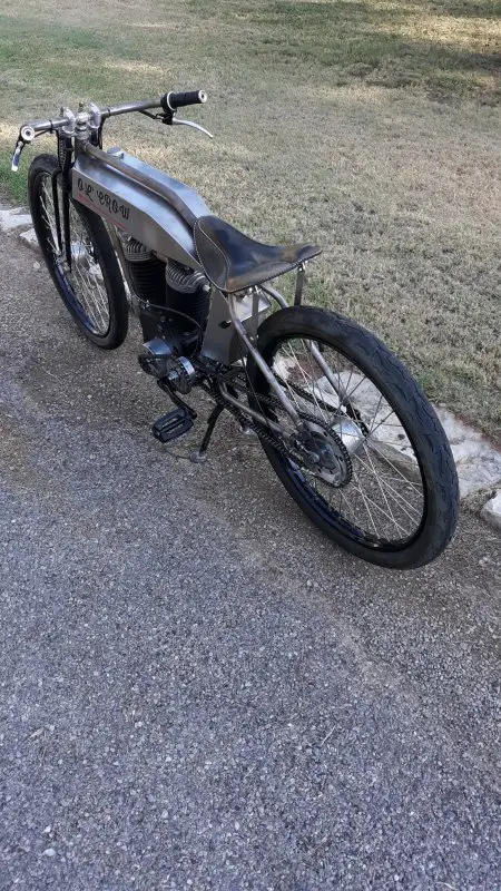

Alterations to the Ol' Crow.
Spring tensioner was a bit noisy due to chain length so I shortened the chain and she happy now and not so noisy.
Next I decided to set the 3 speed to high on the controller and it made a noticeable difference, but not dramatic. I think mph differerence is 2 to 3 .mph between the 3 selections. I rode at higher speeds on varied terrain today for over an hour and had no heat issues or issues of any type.
Weak link on this build is the controller and that's easy to solve with a different one. This controller is marked as a 40 amp but I doubt it's even 30 amps. Very weak but at least it doesn't heat up. I will probably order a Vesc Flipsky controller, which are fully programable and if anything underrated on current output and voltage. Also they are very small in physical size and run cool.
Well one issue of my own doing occurred when I switched the wiring from moderate to "high" speed setting. The bike had no power. Turns out one pin in the Hall connector had disconnected during the speed change process of moving the mass of wiring, the pin lock didn't engage and the pin backed out just enough to lose contact but still was in the plug housing so it wasn't very noticeable. A new pin locked in properly so it's all good now.
Shout out to Pat at Sportsman Flyer for this great looking frame which also rides and handles great!
