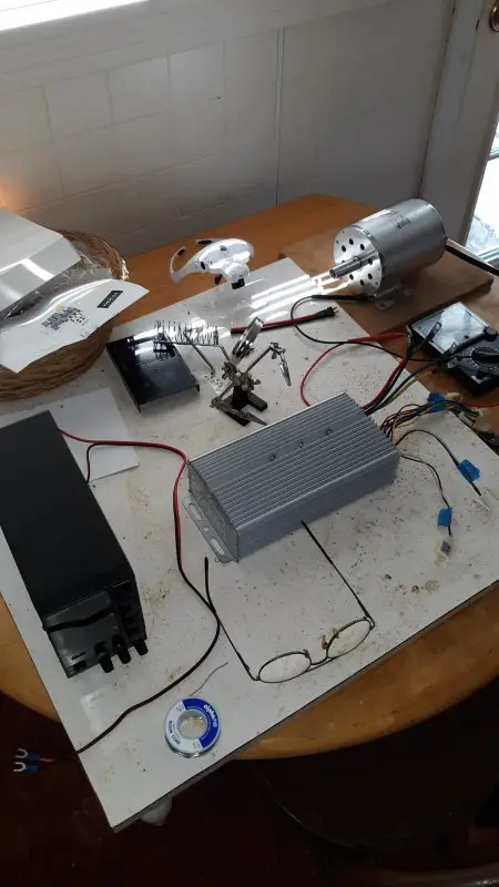

Getting the big controllet hooked up had one snsg but it's all good now. Drew only 2 amps at no load (good number) and at full throttle and ran 6,000 rpm on 54 v power supply setting, also at no load. Very smoth and quiet. Though 72v capable I plan on running 48v still. 80 amps (50 amps more than the installed controller) at 48v is almost 4kw or 5.3 hp at 4500 rpm loaded. I'm wanting more torque and not speed so the sprocket reduction will remain the same. This is the setup I should have tried first with the gear reduction drive train.

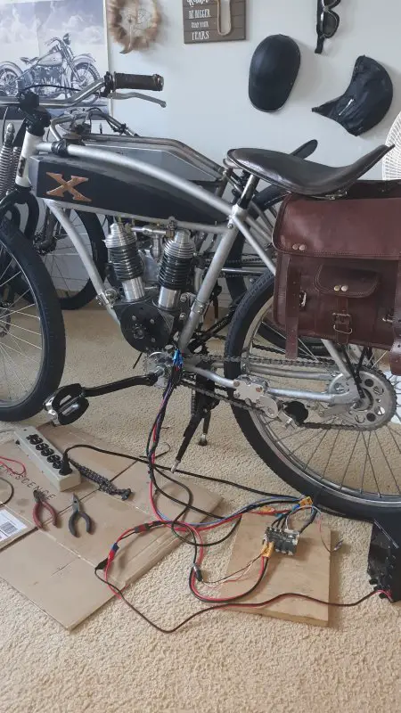

Tony my Schwinn is back in the house again and where I have more room and comfort. Cleared the kitchen table of the last motor work in anticipation of a complete rewire of the Schwinn. One connection at a time done up properly as it should have been done before. I'm not looking for a quick fix but rather a proper install.
The wiring appears correct but it seems my controller setup via Android isn't pairing via bluetooth.
The new controller for the Ol' Crow is behaving great with the 72v motor and hooked up quickly for a quick test ride with wire ties holding controller in place. I'm using 48v. battery. I can't begin to describe the difference in torque this pairing has made. It really climbs well, but the test with wire ties was a hinky setup! Bags and rack should be here next week.
Now the Schwinn is my focus and think perhaps the software version is outdated? If I can't find a solution I'll run a non programable controller. I've had some problems with buying motors and matching up to controllers not matched with one another by manufacturer as a pair.

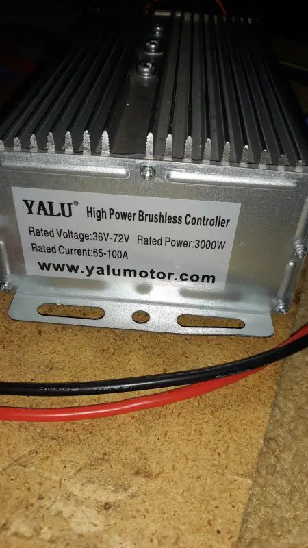

Well color me gullible. I read the vendors spec sheet and I verified the controller case data when it arrived & tested it on 72v and 48v but took their word for it being able to function at 36v. It won't as it requires 42v minimum to function and any voltage drop under this shuts the controller off as it would normally for 48v voltage sag. Basically I found out they lied about the specs.
I suppose it's time to find a 36v, dedicated, hardwired controller which will support at least 50 amps for the Schwinn or just switch to 48v battery pack?
