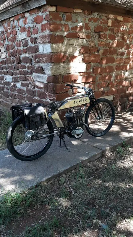

Rear rack, and saddlebags all here today. Time to fab the saddlebag bracket for the rack and get things mounted to the Sportsman Flyer frame.no frame mods required, all just bolt ons. I'm 100 percent satisfied with all of Pat's work that went into the Ol' Crow electruc V-Twin!

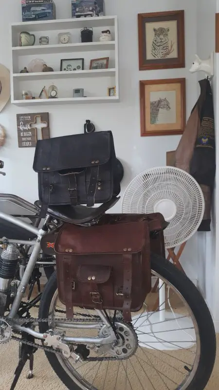

I just used the top stay holes in the axle plate, you mentioned, to mount my rear rack this morning. Saddle bags came in and I'll post photos tomorrow after I get them mounted to the bag support frame which takes all the weight off the leather bag straps.

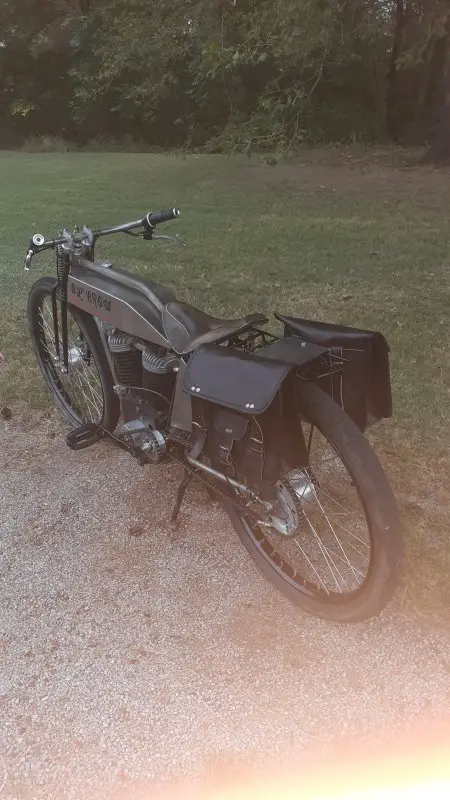

Had a surge of energy and mounted the saddlebags but light was fading sooner than I expected so really bad photo kinda' gives an idea of how they sit.
Thanks Curt. This is the forth bike to get leather bags. Finding bags which are in proportion to the frame size was a problem for awhile. Horse and Harley leather just far to large 12"x7.5"x4" is about perfect and will hold 14s x 7p 18650 cell packs if required. I'm just using 36v or 48v 7p packs so lots of room left over 52v or 60v packs would fit.

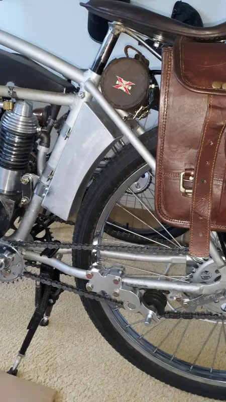

Hiding the wiring from the motor case to the saddle bags or at least keeping it discreetly veiled is something I'm working on now. Starting with the Schwinn. Photo will help my description. Motor wires run from motor case to bottom of "tool box" and continue through the box to leather tool roll under the saddle and then into the right side saddlebag which will hold both battery and controller. Not much wiring and no plugs exposed.
