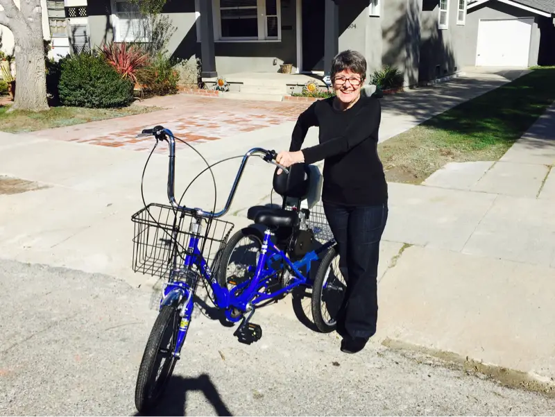

    Outside of the rear basket, which may or may not be an issue, it looks like Norm gave this a lot of thought. No clue if it has a centrifugal clutch, but I see a pull-start four stroke, and it, and the fuel tank, are raised so she won't have to bend over far. Good welds with Norm's attention to detail. It should be fairly reliable and a cinch to maintain. I think she'll enjoy it way more than those mobility scooters that so many people are getting these days.

    I dropped the bike off to her today... Here she is with her new ride! :D

    You might want to take a 'Trike Class' as apparently you have ever rode a motorized adult trike.
    They are damn unstable with an offset drive and there is no 'lean factor' for turns, they just tip over.
    A 212cc engine?
    Max safe operational speed is 20-25mph, about 5-10 in a turn.
