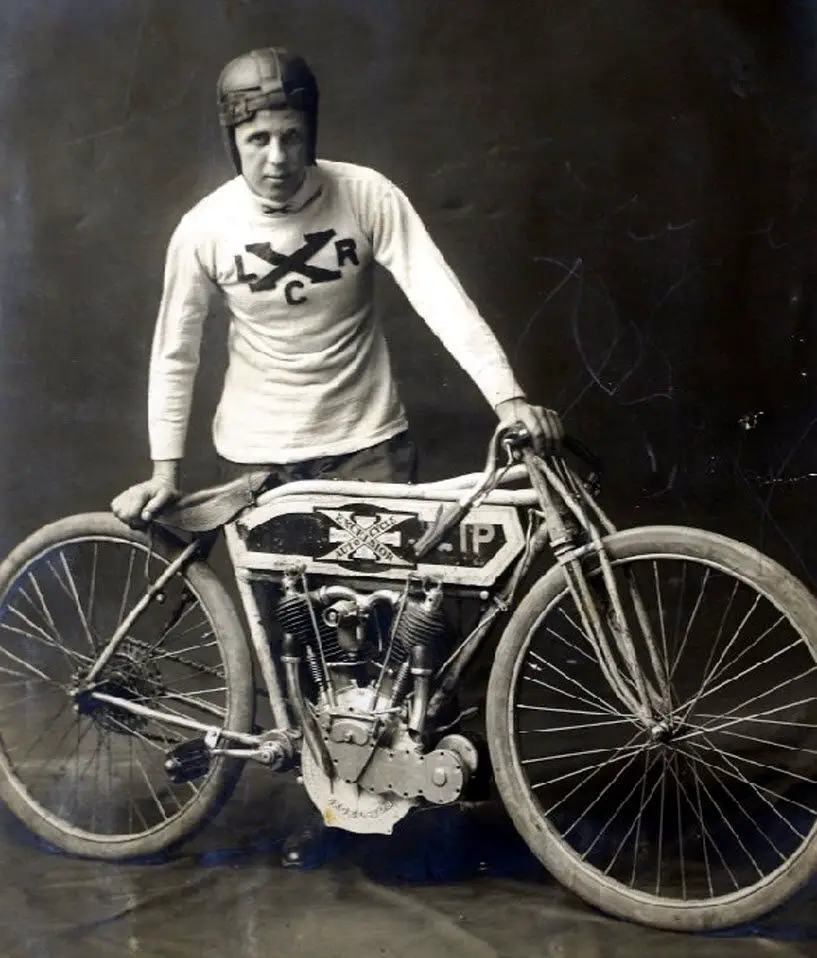

I see an Excelsior in the works.
sorry for the semi hijack
Here is a similar Excelsior which has been restored
Thanks for that image whitey. The only things that were inspired by Excelsior on this bike so far have been the handle bars a eventually the tank design. Most of it has come for a 1926 harley and a 1911 indian, with some of my own Ideas.
