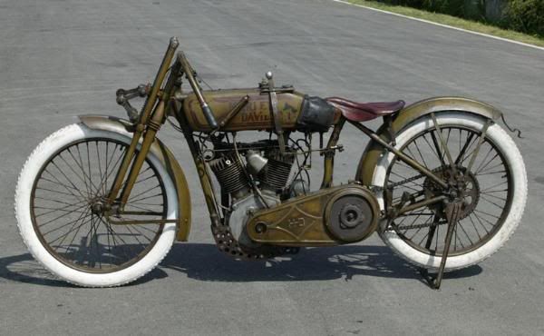

Here is a picture of a 1910 Harley Davidson with a fork that is very similar to Lurkers' ride. The springs are tall. I like the additional mechanical linkage that the Harley has. Look very industrial. I like the direction you are going with it.

That extra linkage is actually a couple of a early style friction disc shock absorbers. Most likely a after market bolt on. It's a cool detail!
