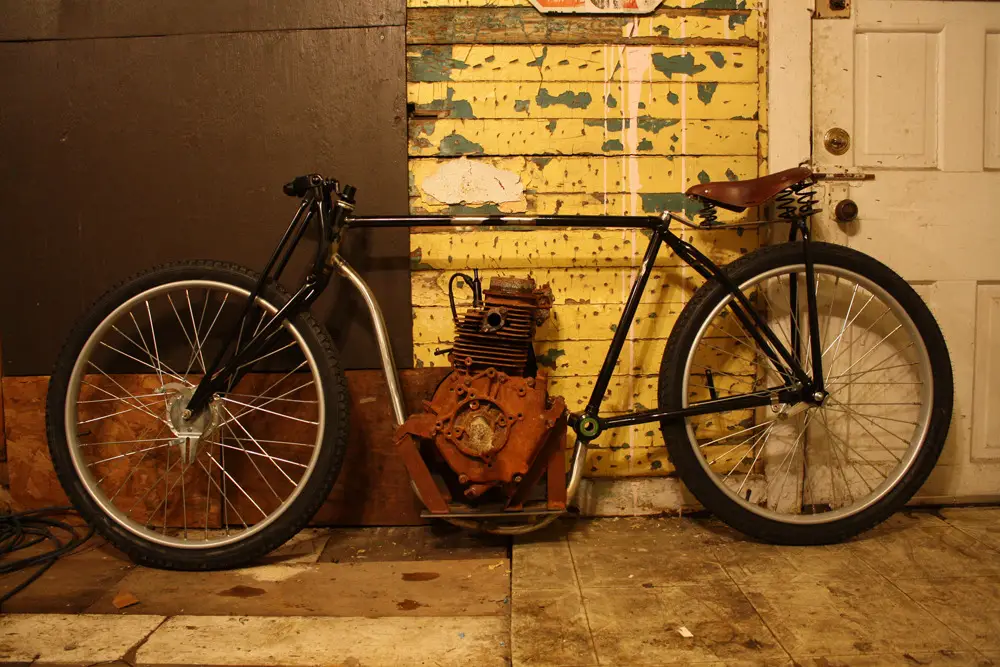

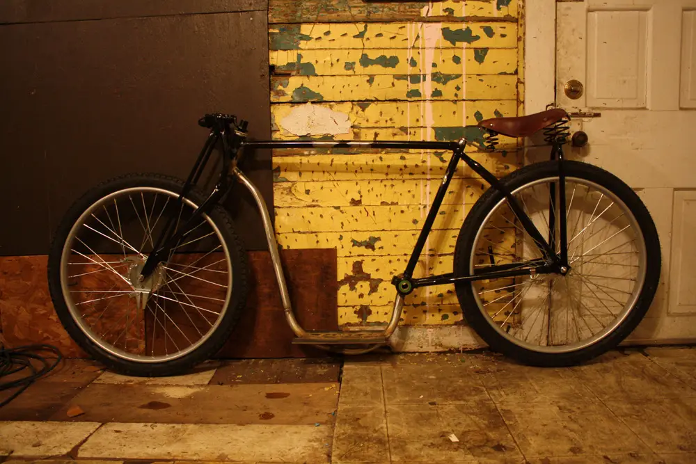

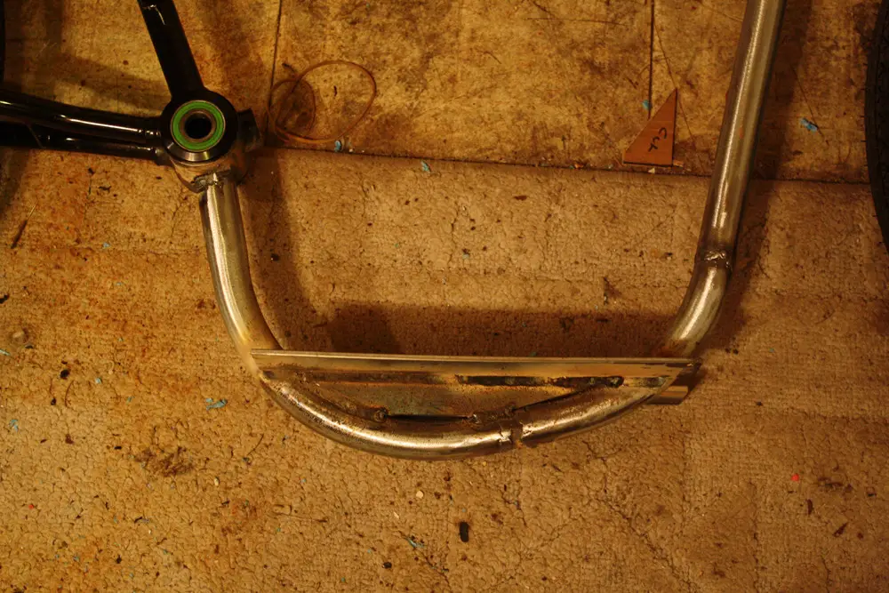

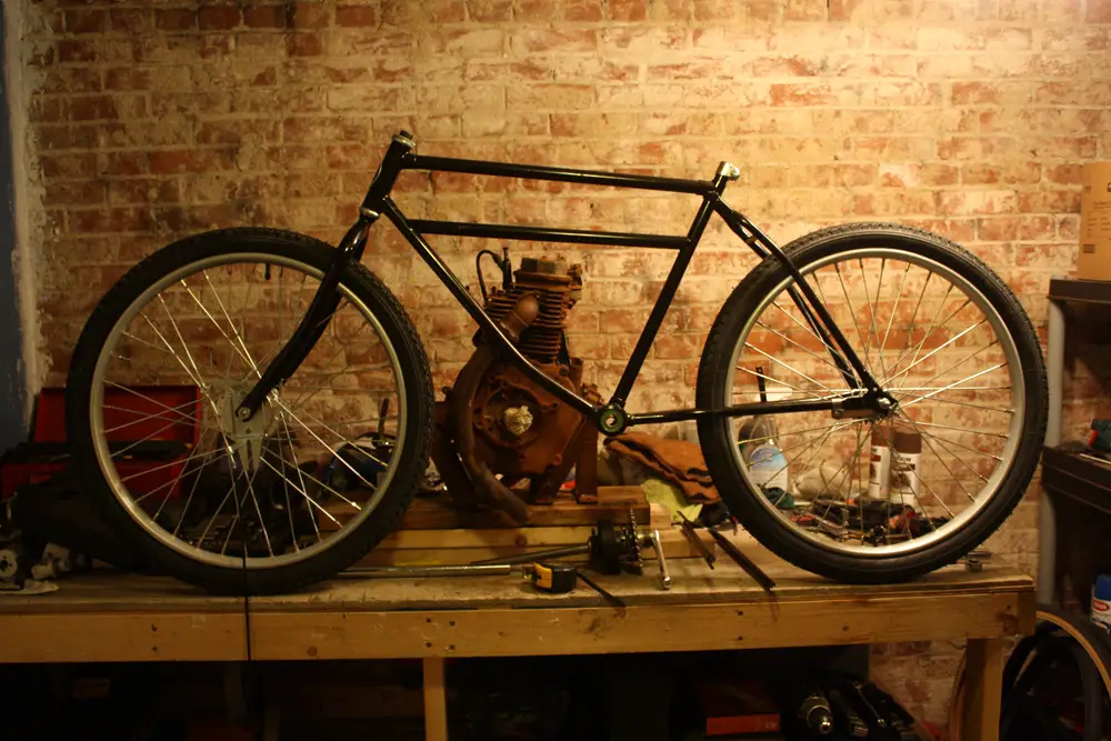

Anyway, work on the racer is back in full swing at least until I leave for Japan. Here is where I'm currently at, I have spent the better portion of the day trying to figure out how to shoehorn this monster into this unbelievably ugly bicycle. In the next few weeks the frame will be undergoing major reconstructive surgery and I will try to upload the photos as I make progress. I'm hoping for a very quick build with this one.
Here is short list of what will need to be done.
1. Add 5” in length to the centre section of the frame
2. Remove current down tube and replace with a drop loop and engine mount
3. Seat mount fabrication

Looks like the flat mounting portion of the engine as shown is close to the angle of the seat tube- I’m sure you planned it that way, it should make engine mounting much easier!

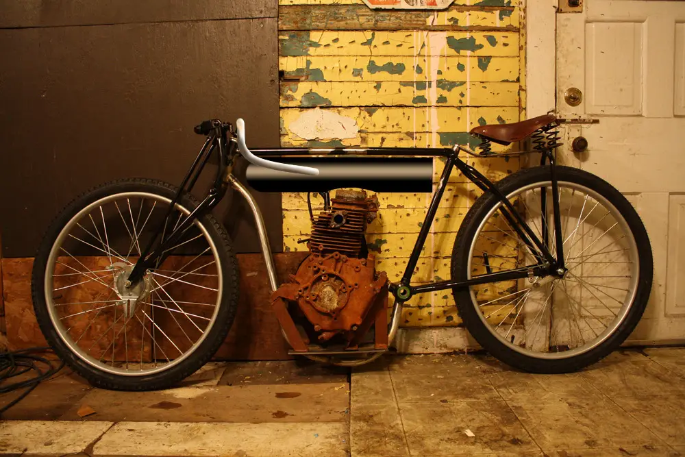

I spent the past 2 weeks waiting on part, so if it seems like it's been awhile since I last updated, it has been.
When I was planning this build I vastly miss calculated the size of both the engine and the frame. With that being said I have had to make some design changes to the original concept. It might look a little weird right now but I am confident it will all come together in the end.

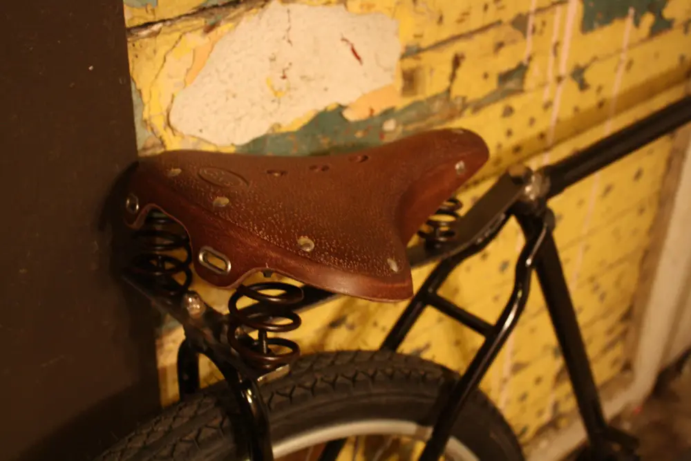

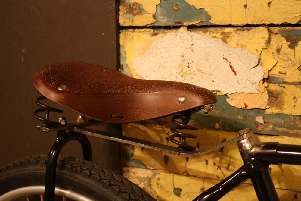

Looking good and great to hear from you again Lurker..... I'm just wondering on a lot of antique bikes the seatpost is made from tube, you appear to be using flat bar, are you concerned that isn't strong enough or is it just temporary?
Glad to see you went with a Gyes saddle I love them! good thing the Merkel didn't have that Gigantic tank.
harry, The 3/16 flat bar is there to stay. I was initially going to us a round tube like the original bike but because my saddle has springs it would have placed it much higher than I would have liked. It is very sturdy and under the weigh of an average person there should be no problems. If anything it will provide a bit of extra suspension for the terrible roads in Pittsburgh. I am trying to build a bike that is a bit more comfortable, because my v-twin is the worst when it come to potholes.
Thanks truckd I have used the guys saddle on a previous build and was very satisfied with it and I thought it would fit the style of this build very well.

Looks cool, the motor does look massive though, and that drop loop looks very low. I hope you don't live near speed bumps ;-)

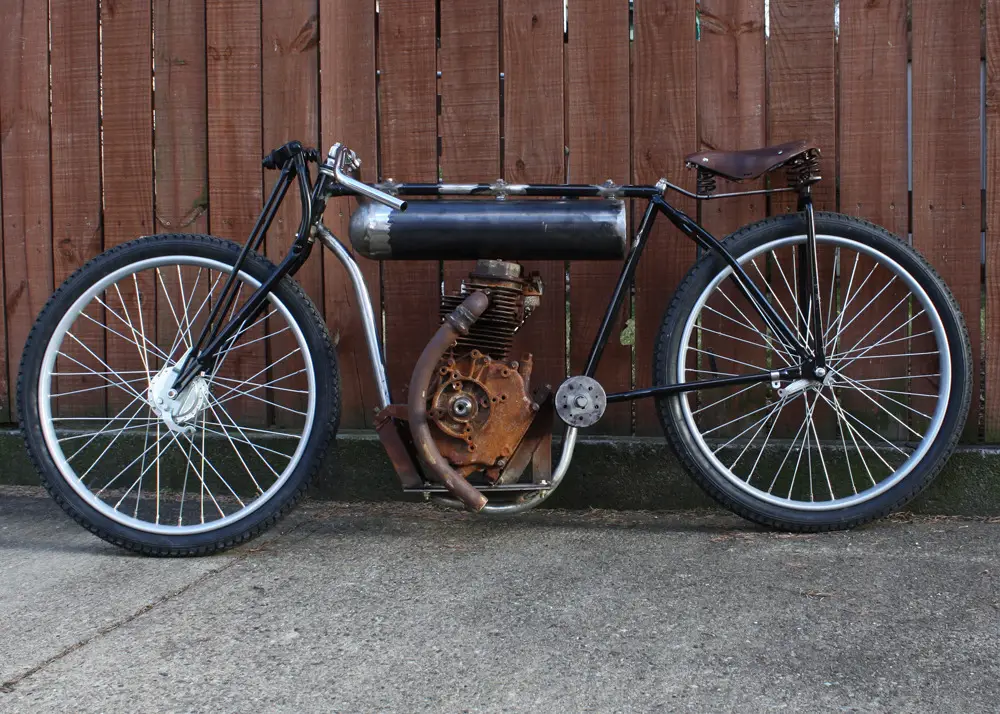

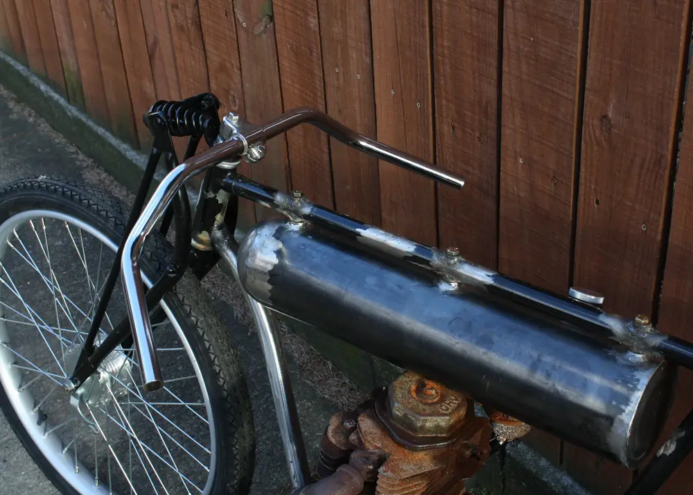

Thanks for the reference photos trucked, my tank will be very similar to that. I have all the holes drill and the tank is mocked up in the frame, so hopefully I will be able to get it finished sometime this week.

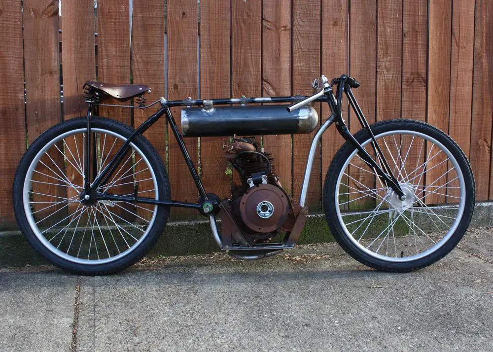

Here are some up to date photos for you guys. I have made lots of progress since my last post. I have finished modifications to the frame and the gas tank is almost complete I'm just waiting on the sediment bowl so I can weld the petcock bung in.
It took quite a bit of massaging to fit that 350cc monster in that frame but I made it happen. I can't do much more as I am waiting on parts but I will be sure to post more photos when I make some more progress, but for now enjoy.
Let me know what you guys think so far, I am open to all your critiques.
