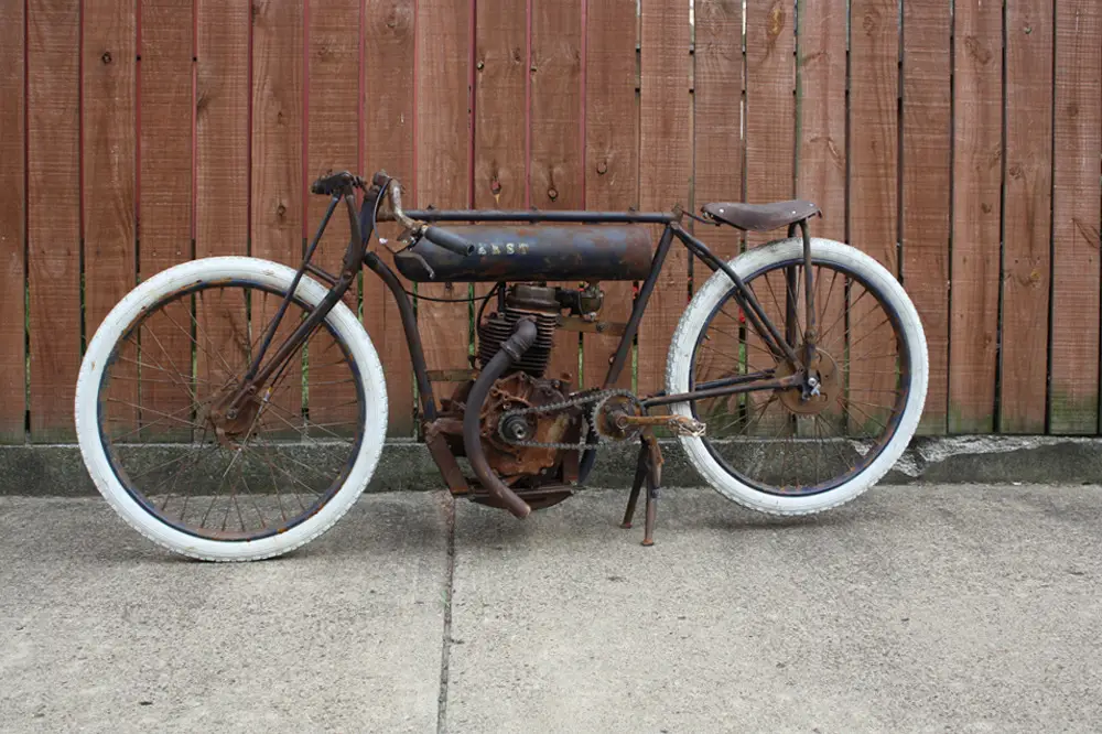

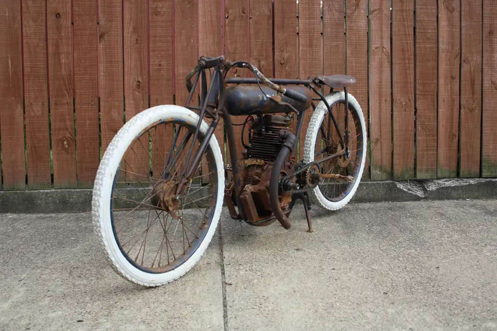

Awesome work. Ive been looking forward to seeing the progress. Really looking forward to seeing what you do to make the bike match the great patina job you did on that motor!
I am really liking the 'look' of this build.
I just started a BTR build and am torn between the "barn find" look and the semi restored look. It will be interesting to see how the patina coating on the engine holds up to heat.
Also, what did you use for bottom bracket bearings in your jackshaft/transmission setup?
Thanks
Nice bike! Looks like a very nice drivetrain setup...are you going to patina the aluminum parts to match the period look?
(not criticizing, just wondering)
If I was going to start a board track build I would have to assure myself that I had the talent to make it look as good as yours or it would never be started. A beautiful build.

Oh no! That's not what I want to hear. I build these bikes to inspire others to step out of their comfort zone and take a chance at something they have never attempted before. I encourage everyone I talk to about these bikes to give it a shot. You dont have to go crazy and build a v-twin, start small and work your way up, making sure you push your self each time you do so.
Remember, It is all about planning and really thinking through your work. Plan everything, never work haphazardly.
Here are a few rules that I follow when building a btr, these are things I have learned through countless hours of research
1. Average height is around 32"
2. The crank shaft should fall on the same plain as the axles
3. The cross bar should fall at the top of the rims
4. The average length of a btr is no less than 80"
6. bottom of the frame should be between 4-6 inches from the ground.
I hope someone will find that info useful, and if you are thinking about building one you should. It is a learning experience of a lifetime.

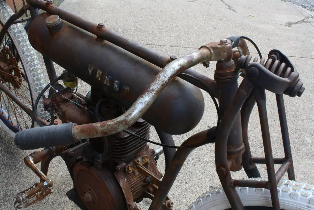

I guess I should also post an update on the progress of the bike. I must admit I have been slacking on the bike stuff as of late, due to purchase of a new vehicle and my reignited interest in cars. But the racer is almost complete, I’m just waiting on a few carburetor bits to arrive and I should be in business. I just put the final touches on the “Paint” today, which consisted of used motor oil.
