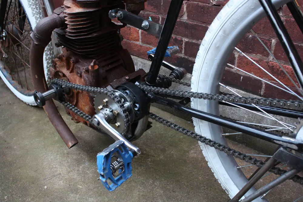

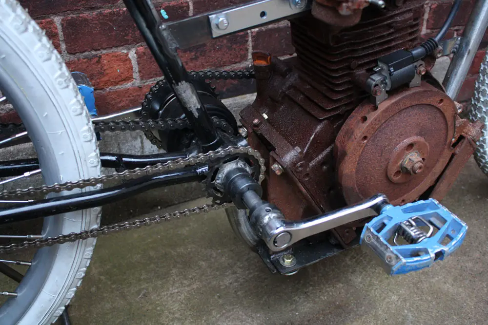

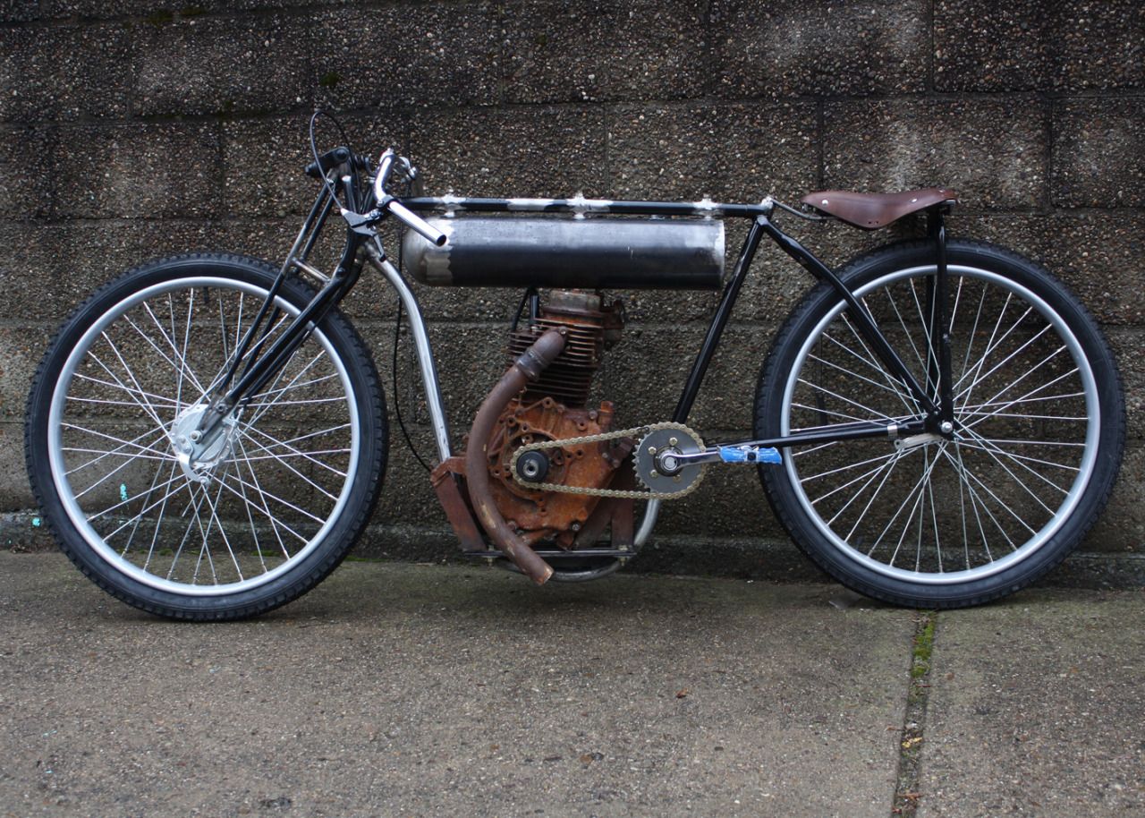

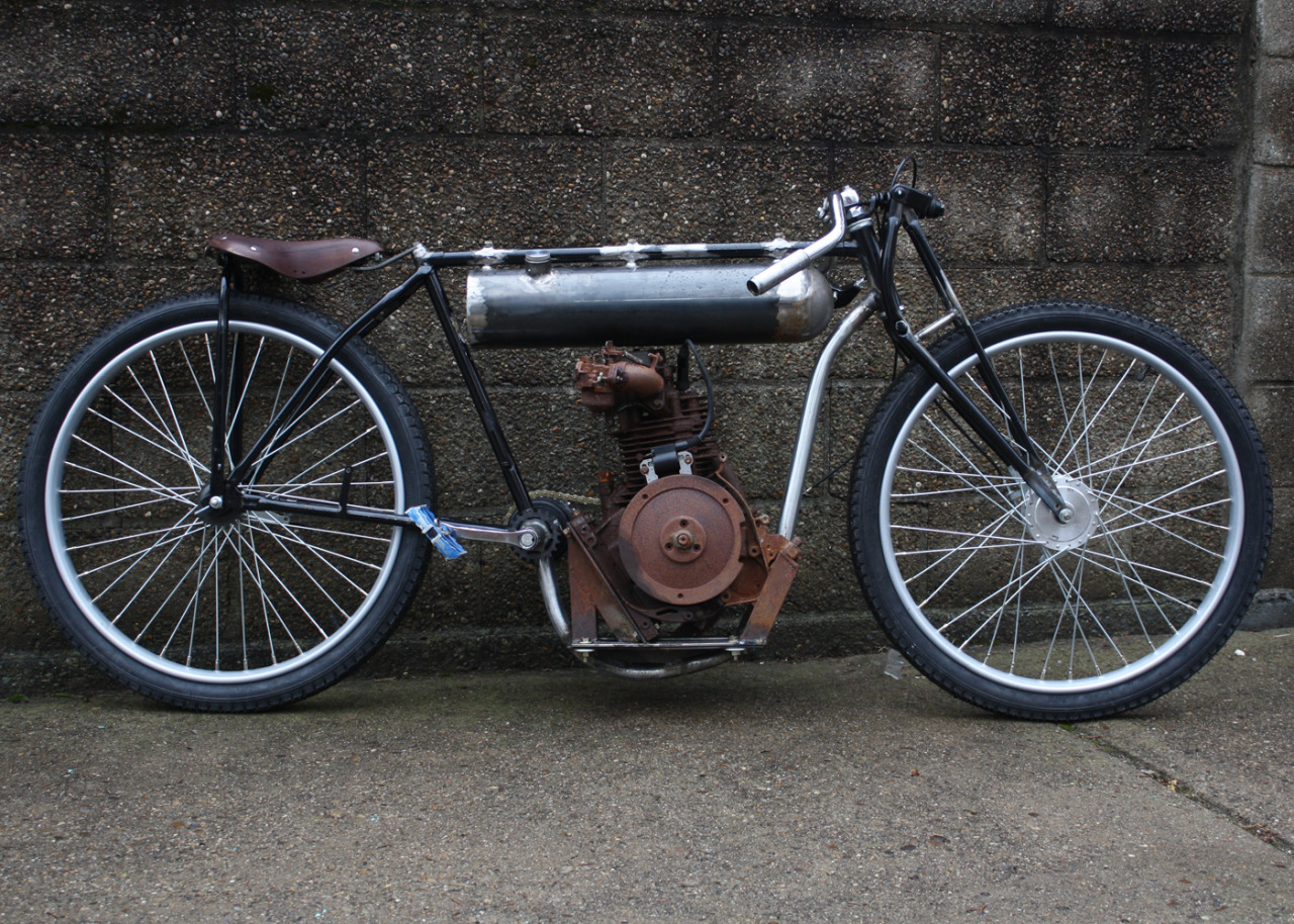

progress, progress, progress, everything must progress. Ijust finessed testing the pedal start system I have devised and.... IT WORKS! I couldn't be happier with the results I can't wait to get the rest of the drive train sorted so I can finally get a test ride.
I also managed to install the internal throttle and reinforce the fork.

...and you have lowered the seat! :-) Looks good!

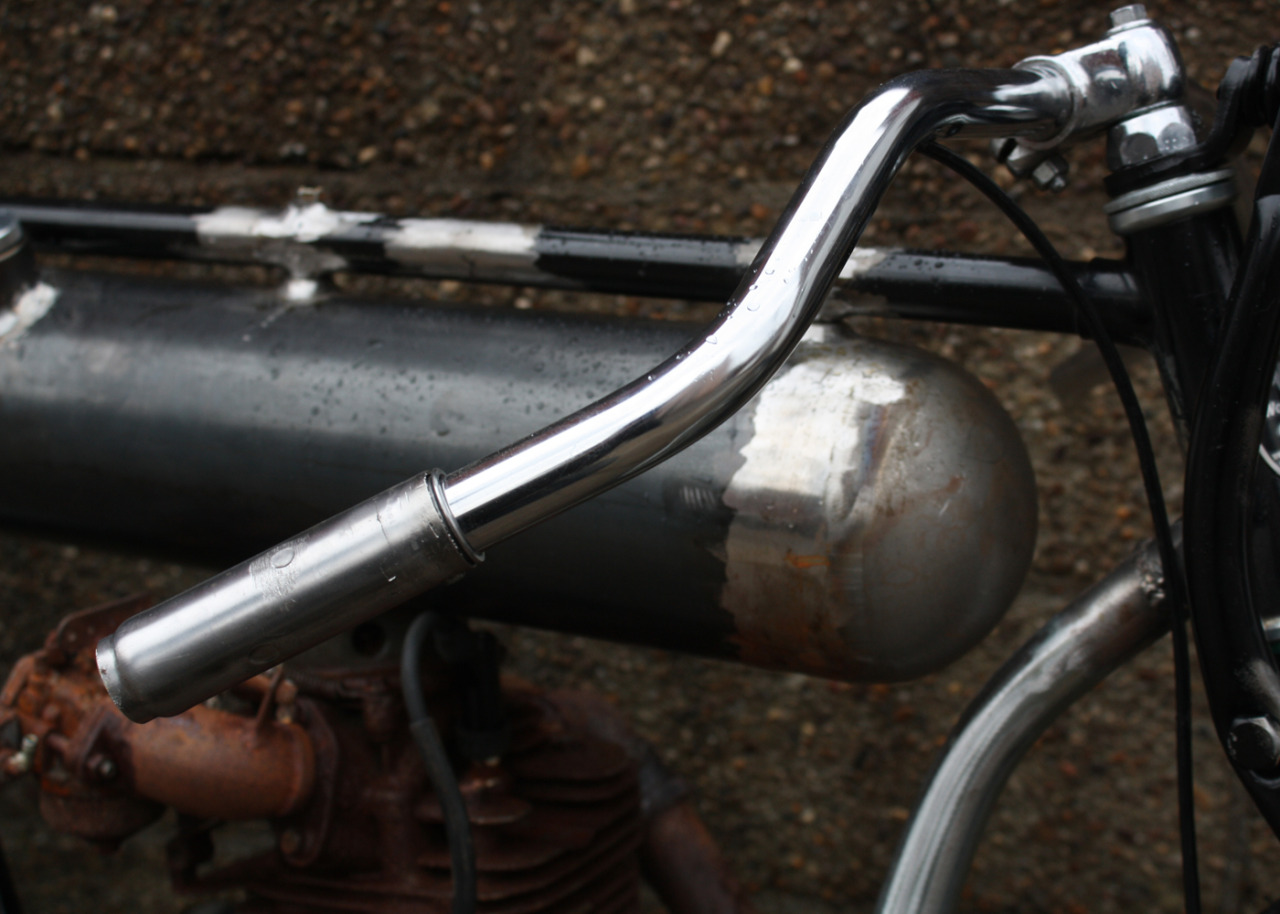

That thing looks amazing! I love the look of the m2600 with a drop loop, that's the direction I went with my current build. And that motor looks so authentic! I'm sure a lot of people will be fooled by that patina. Please please post a video when its running and riding. Thank you for the inspiration!

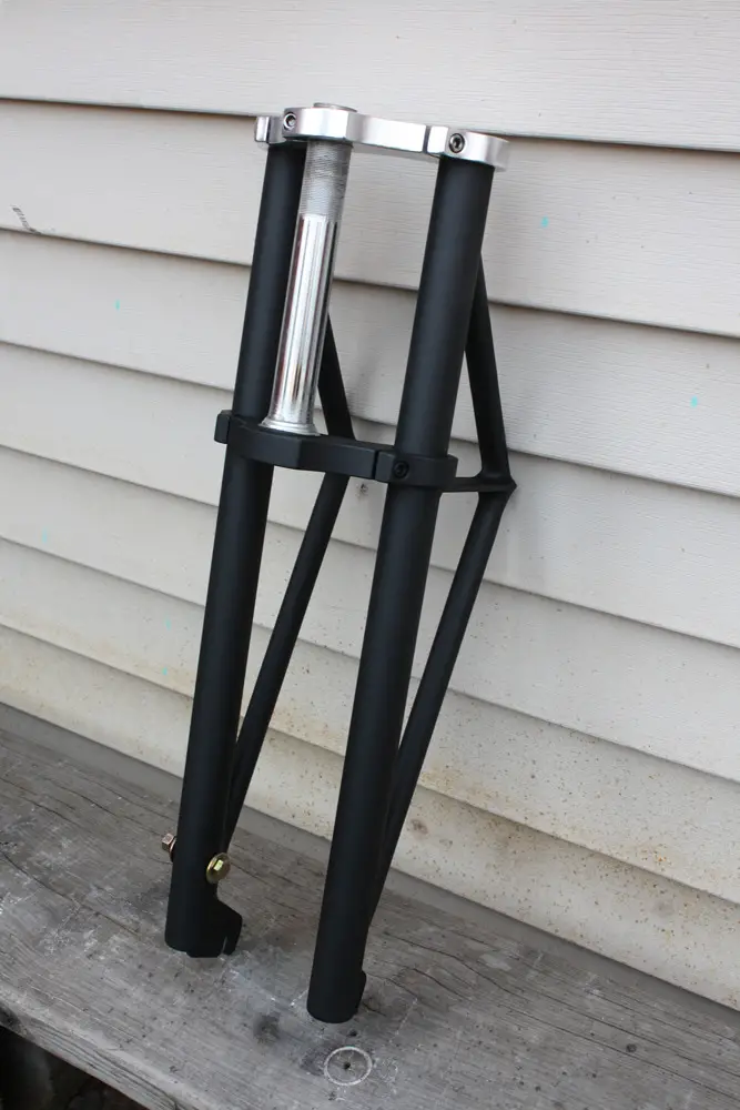

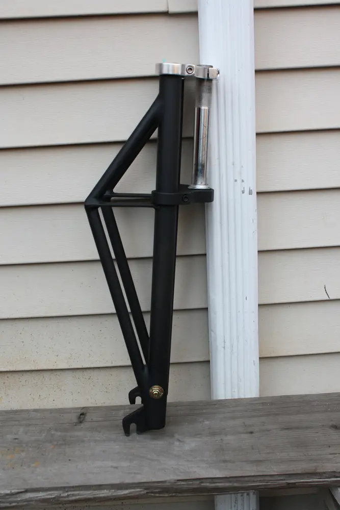

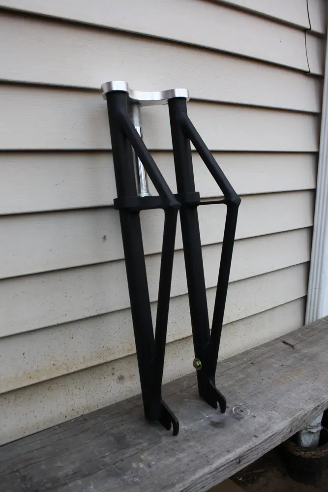

I just finished building a fork for a customer today so I though I should up load some photos for you guys to see. It is loosely based on a Thor btr. It is also almost identical to the fork on my old gx200 bike.

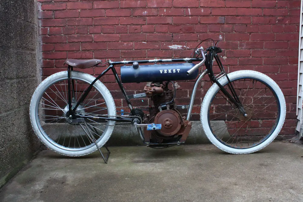

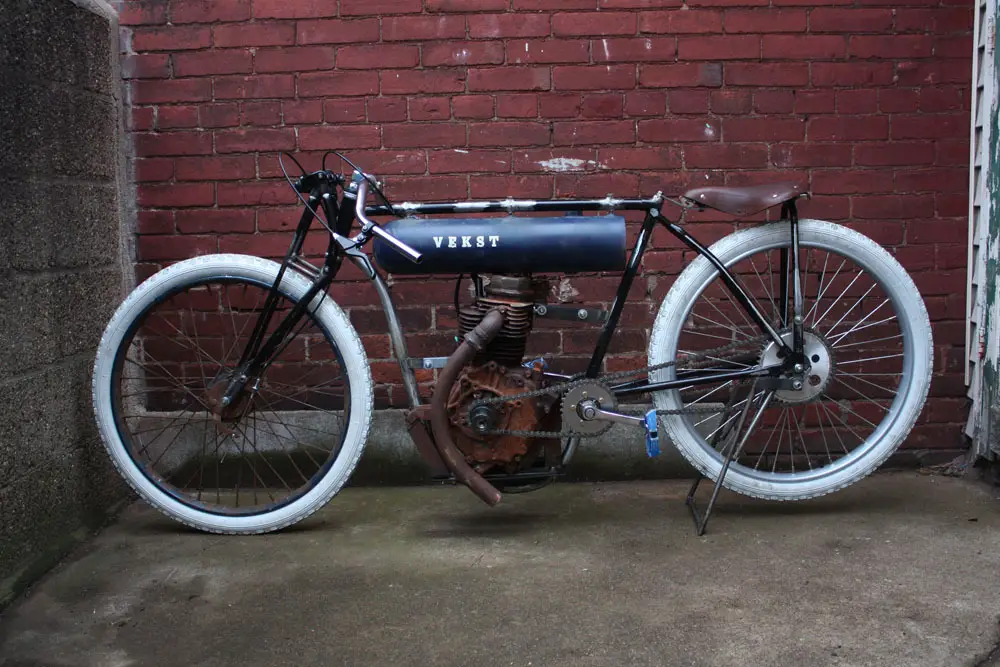

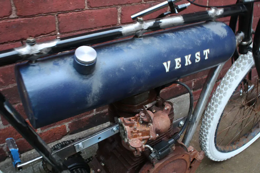

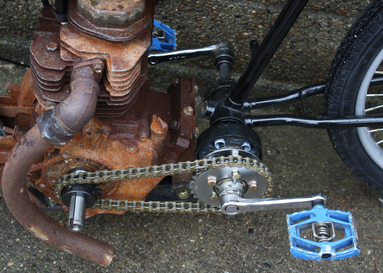

Hey guys, sorry for my absence on the forum and lack of updates, but I have been very busy this past month or so.
Anyway, I finally finished fabrication on the bike, and everything is test fitted and ready for teardown. I have also started to paint the tank and front wheel as you can see from the photos, but they are far from finished so don’t be too quick to judge.
I also took some photos of the finished transmission system to give you all a better idea of how it looks and works.
