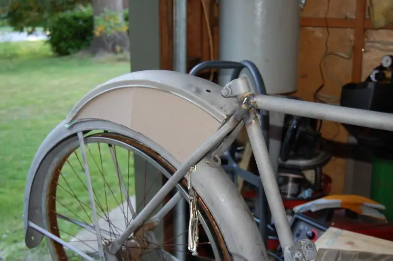

The one thing that has been giving me fits as what to do, is the gas tank.The seat is too low to get the Camelback look as the original was. It will be close but not quite what the original looked like. After the appropriate amount of grumbling I cut up an old fender and layed up the bottom and the another fender provided the top.
Tomorrow I'll make patterns of the sides and try welding it up.

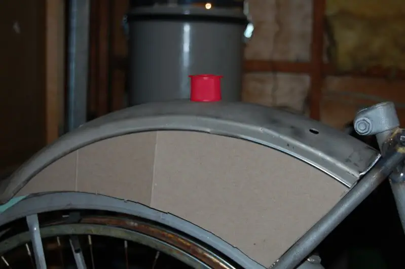

I got a start on the tank today after changing things around. I took a couple of photos with the side panels being the cardboard patterns I'll use to cut out the steel.
Just to give everone an idea of what it will look like. The red cap is where the gas filler cap will go.

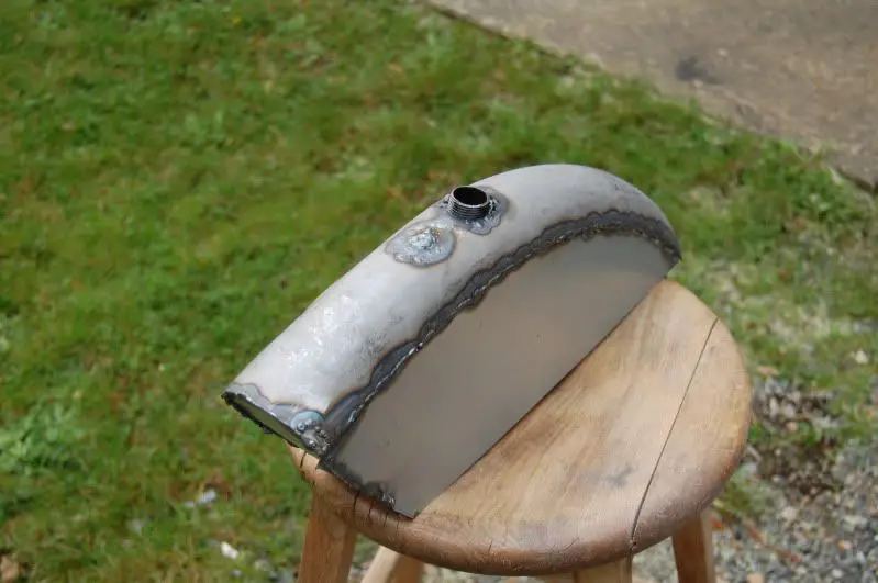

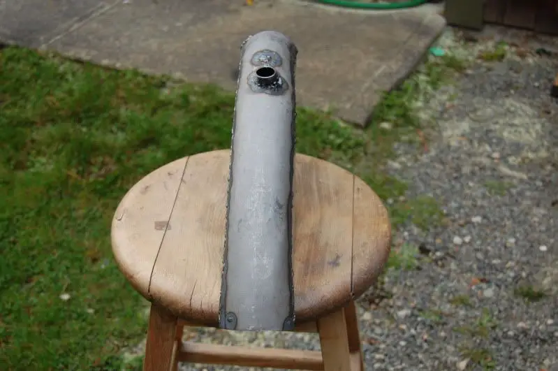

I welded the tank up today since it was the first dry day in a bit and I weld outside.
I used two front fenders to form the tank. Both 26". If I had them I would have tried a 16" or a 20" fender to see if I could a bit more of a curve to the top of the tank.
The filler was a 3/4" pipe nipple that I welded in. I should have welded in a couple of squares of metal to add to the thickness since the thin fender and the heavy pipe made it very hard to weld in with out burning through. There was lots of burn through.
The tank will need a good bit of tank sealer to make it tight.
The brass top is a garden hose cap that I found at Home Depot. When you have a splitter on one tap to use two hoses this is used to cap off one side so it doesn't leak if you take a hose off.
Not sure just where the gas line is going so I haven't drilled a hole for it yet. I'll solder in a fitting when I make up my mind.
I'm going to cut the sides out tomorrow and grind the seams if it doesn't rain. They were left long so that there was plenty of area to weld to since I wasn't sure where everything was going to line up.

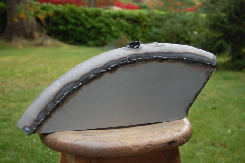

Trimmed the unwanted tin off with a sabre/jig saw using a fine toothed blade and then ground down the rest with a 40 grit flap disk and an angle grinder.
This tank was very easy to make since there weren't any butt joints. I put the side panels inside the top so it was just resting on the inside lip and welded it up on the out side of the tank. The end panel won't be seen so I set the panel back inside about a 1/4" and that gave me a small area to weld to that wasn't butted together.
As you can see I left the sides long and pushed the bottom of the tank up to meet the ends and clamped it so it was possible to measure the bolts that will hold the tank on the fender and make sure that they were centered between the sides and straight up and down.
I haven't put it on yet so we'll see how clever I was when I do.
Put a square on one side and checked the bottom to see if both sides were even all along the tank. Good thing since they weren't.
When it was being welded I used a thick copper plate about 2x4" that we got from Eastwoods. This is used to put behind moulding holes on cars when you are welding them up. It has 4 magnets to hold it in place. The welding wire doesn't stick to copper or brass.
I just put it on the work bench and the tank on top of it and used it as a heat sink to help stop any warping of the metal and not burn the wood. It worked nicely.
Tomorrow I'll body fill the low spots and clean up the welds and prime it and see if it sits an the fender properly.
