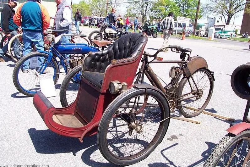

I have a question regarding the tri-car front end. How wide will the wheelbase be from tire to tire? I'm also wondering if I could swap that front end assembly from the Indian Hiawatha to the Orphan moped and back again... is that possible? Is it just a matter of setting up both bikes in the same way to receive the tri-car assembly? If so then I could use the front end for a Morgan 3 wheeler inspired velocar using the other half of my Grumman canoe as the body. Maybe.

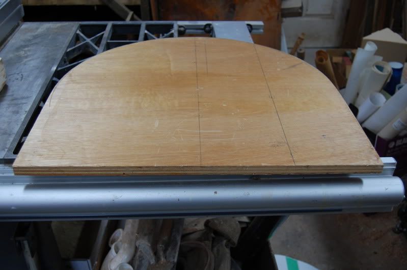

I've gotten a start on the seat for the tri-car. Not overly impressive for the next few days but it's slow going.
Here are 4 photo's on photobucket to give you an idea where the top part is going.
Click on the photo to see the rest. I should have more photos tomorrow.
Steve.
Good to see progress on the tri-car seat, Steve! Keep the photos coming...
Yes, I'd think riding up front would be spooky for sure. Slow speed in a parade perhaps. Good spot for the senior beauty pageant queen. Or my dog, Aaniimoosh, who would be less trouble.
