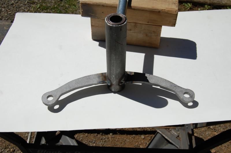

I welded the arm that goes to the pitman arm on the steering post, on to the spindle and did some fast measuring for the tie rods.
Tomorrow I'll get the pitman arm welded onto the steering shaft and see if there is time to cut and thread the tie rods.
Have to see the wheel builder this week and ask if he will have time to do them and if not the search is on to find someone or I'll try to do them myself.
This week as well it's finding a paint colour that I like and the seat upholstery material. While I'm waiting I'll get the seat done as I said and the fenders mounted on the front as well.
Here's how it looks now.
Steve.
