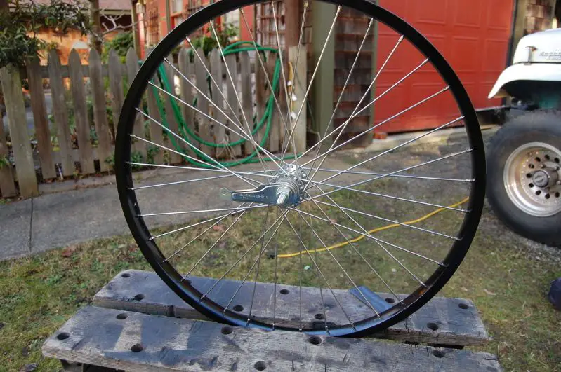

The hubs that came out were 2-9/16" to the outside of the spoke holes. The hubs going in are 2-11/16 to the outside of the spoke holes.
The guy that messed the wheels up eyes danced around like a tuna being chased by a shark when I asked him what length the spokes were. He probably had no idea and just picked out a number that sounded familiar.
I'll take a spoke out of the wheels that I still have in the trailer and tell you what the length is.
Here is the original wheel and they were laced up in the same pattern.
Steve
So the tri-car hubs are an eighth of an inch bigger in diameter than the donor hubs. Need to know the length of the spokes he used, not what was on the wheels you bought.
If you don't have a use for the Shimano coaster brake hub I could use it to replace the one on my American Flyer which is a clone of the Shimano I half expect to fail at any time. Chinese.
I'm guessing the donor spokes are 10 5/8. I wonder if they could be used with one more cross in the lacing which would take up some of the length.
SB
They said that they could use the spokes that came with the wheel but at the moment I don't believe much they tell me. The spokes that they used were the same length when I laid the old spokes against the new ones but the new ones were in the wheel. They measured them in the bike shop and said they could use them so I'm working on that.

So the spokes that were on the wheel were of the same length and they chose to replace them with thinner ones of their own? Somethin ain't right.

This guy says he is a bike mechanic and he saw the wheels as a challenge. His exact words. I figured I'm aced on the deal. There is no excuse for putting out shoddy work that will endanger someones life as well as the people around them. I never allowed myself to do work like that no matter what it cost me to turn out the very best and believe me I dug deep and surprised myself with what I could do when it was needed.
If anyone reading this has the chance to work with a rim drilled for 12 gauge spokes and has a 14 gauge nipple put it in the rim and see if you would be happy with it. The spoke pulled the nipple to one side and left the majority of one side of the nipple with out any support which would have pulled through the rim in short order I'm sure.

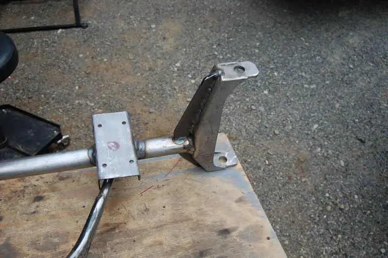

I welded supports onto the spindle holders today using 1/4" steel. Been looking at them and I could see that there was a chance that they could pull away from the end of the axle with out something to support them.
Rounded the corners of the spring perches and the ends of the tabs where the king pins go. As soon as we get another dry day I'll sand blast and prime it.

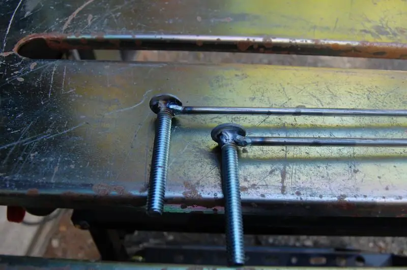

Got a little bit more done. Welded up the fender supports. For the rear supports I just took a couple of carriage bolts that I found in the mixed bolts drawer and drilled a hole through the square shoulder and put the 3/16" rod through the hole and welded it in place.
