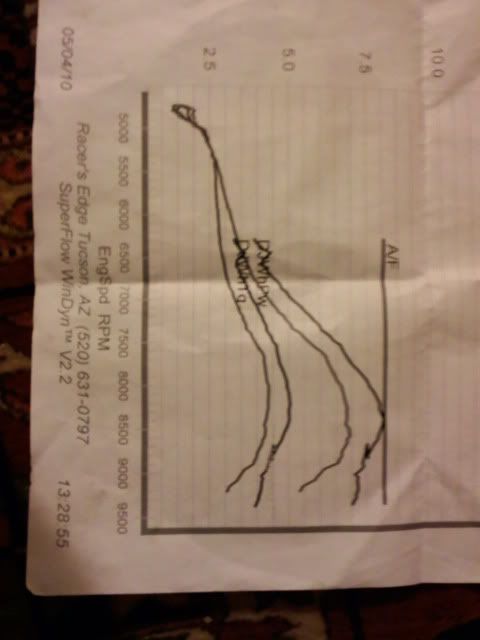

laid out over the last pull a a week or two ago. new rings and 25 miles of break in. the boost ports have 128 deg duration and the exh is untouched at 180 or 181.
ill do another pull in the next couple weeks with the ex widened and enlarged to 1 1/8 to match the header id. i also have a few different carbon reed thicknesses to play with after that.
