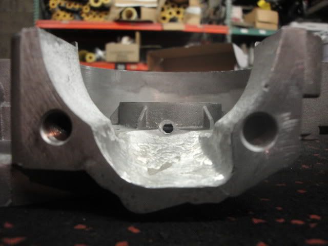

each main bearing got an oil feed

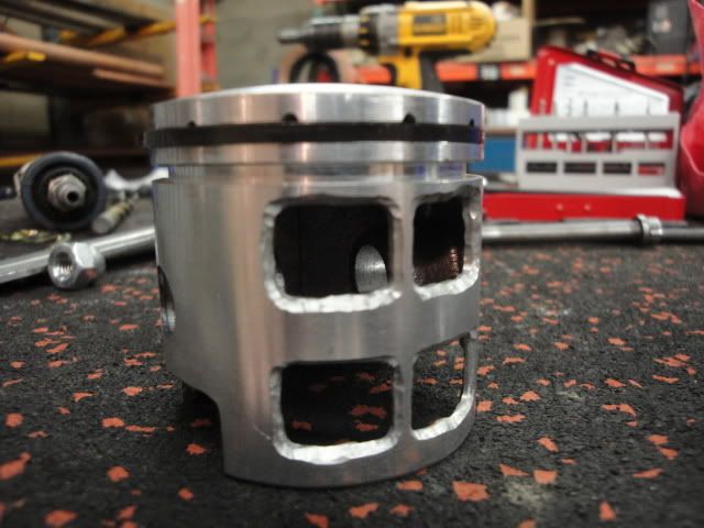

holey piston. this is the stock chinese piston with large intake windows and lateral gas ports.

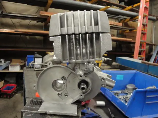

and its assembled
the cylinder has been decked 3mm for that perfect squish.
how do you think chinege pistion will live? and by the by i love the gass vents r you gunna run it with 1 ring then?
i cant imagine it will last too long. 1 ring yes. those vents dont go all the way through though. they cool the piston and clear the ring of exhaust gasses at the expense of a little primary compression.
and if you had the ports going all the way through youd leave the chance to hang a ring and detop the pist but you know 10000 rpm and a good bump might just do it for ya i wanna see :eek::eek::eek::p

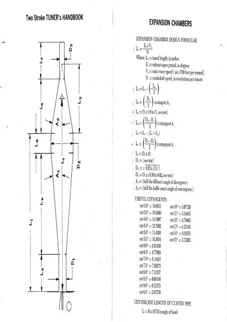

i am designing and building my own pipes out of .023 stainless. my chambers weigh less than the stock pipes. my last pipe had a longer baffle cone for more over revs and it was letting me hit rpms slightly above 11k, which ate up some big end bearings. my next pipe will have a shorter baffle cone which will give me a higher peak power and act like a rev limiter, hopefully somewhere around 9500rpm. the only driveline failures i've had were with a bicycle chain as a drive chain. not only did it break, but it caused all kinds of vibrations.
Thanks for the info but now I have more questions. How did you figure out that moped stuff would work on these motors?You must have had some cross exposure to pocket bikes or mopeds or work with two strokes somehow, what else am I missing? Are you using pipe software? I'm surprised the crank assembly is good for that kind of rpm, putting the holes in for main bearing lubrication was a great idea but I can't believe it didn't have some from the factory. I just got my first motor a couple of weeks ago so I haven't been into one yet but they look about as hi tech as a weed whacker.
i had almost zero 2 stroke knowledge before i got one of these bikes. most of my experience is with welding and fabrication for custom cars and pre evo harleys. the only software i use is cone layout, and most of the rest of the info is here

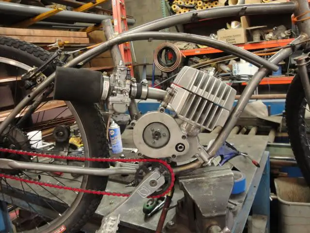

finally in the frame. and a new intake for the flatslide.
upon looking at these photos now, i see that i need to slide the rear motor mount up on the seat tube at least an inch. that will give me more room to get the exhaust past the downtube without obstructing the flow. luckily the intake will still fit.
