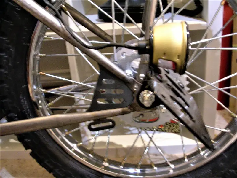

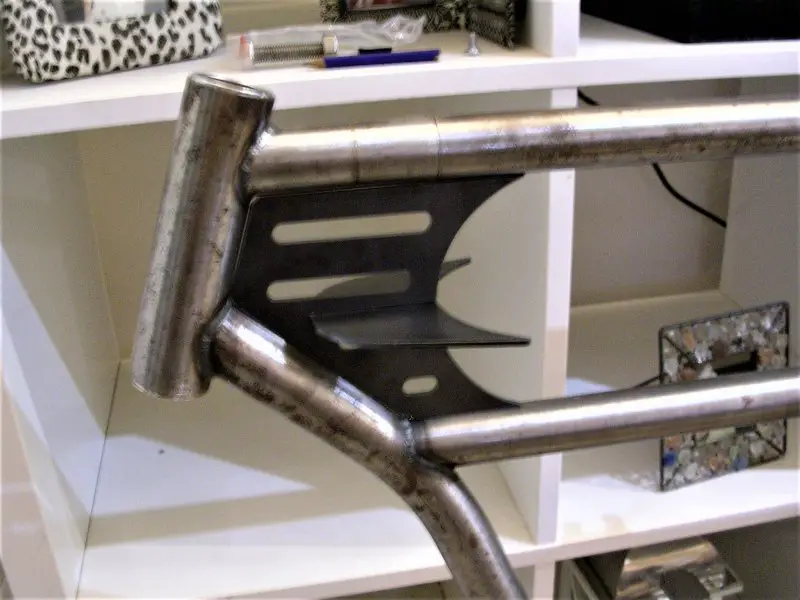

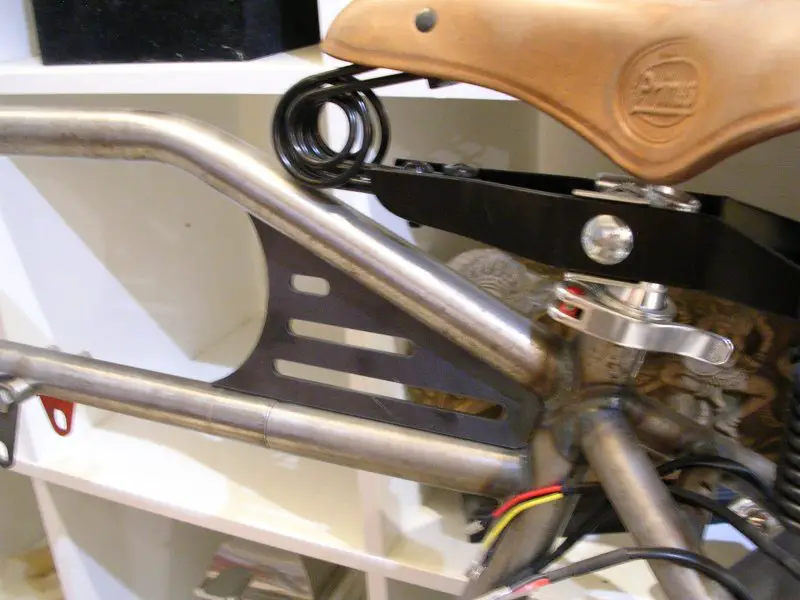

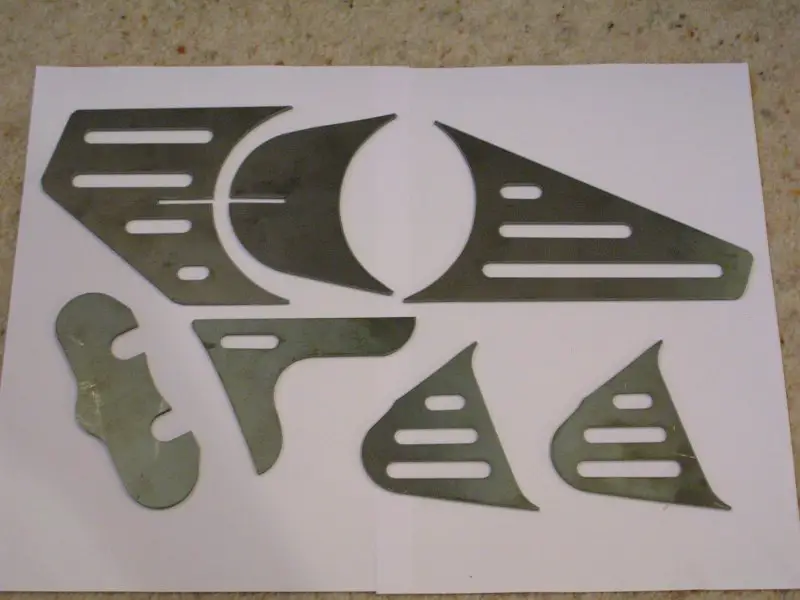

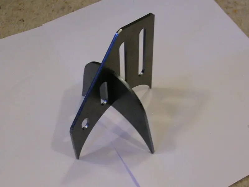

WATERJET-CUT FRAME GUSSETS FINALLY SHOWED UP.... (Remember me?....It's been a while....!)
Phew, after what seems like forever, my waterjet-cut, 1/8" thick, mild steel frame gusset parts were finally delivered today. All fit the frame perfect, as expected - but the lack of a 24mm dia. hole for the ignition barrel in the speedo bracket means that part will need to be re-cut. Barrington Metals said they'd do another. correct, speedo bracket for me sometime in the next few days. Oh well, sh _ t happens....
I can now proceed with silver soldering these strengthening gussets to the frame.

Found out the reason my waterjet-cut parts took so long to get done. Michael, the guy in charge of the profiling shop at Barrington Metals told me last week they'd endured several weeks of intensely frustrating communication problems due to their internet/phone provider being held to ransom by a hacker. Wondered why I wasn't receiving e-mails from them, and every phone call to them was either never answered or I was cut-off mid call. Often, their phone line was just dead when I tried calling. Caused their business no end of problems. After my parts were delivered today and I called them to say one component was incorrect due to 3 x missing holes that were on the drawing I supplied, they confirmed that was an ongoing problem also down to the hacker issue.

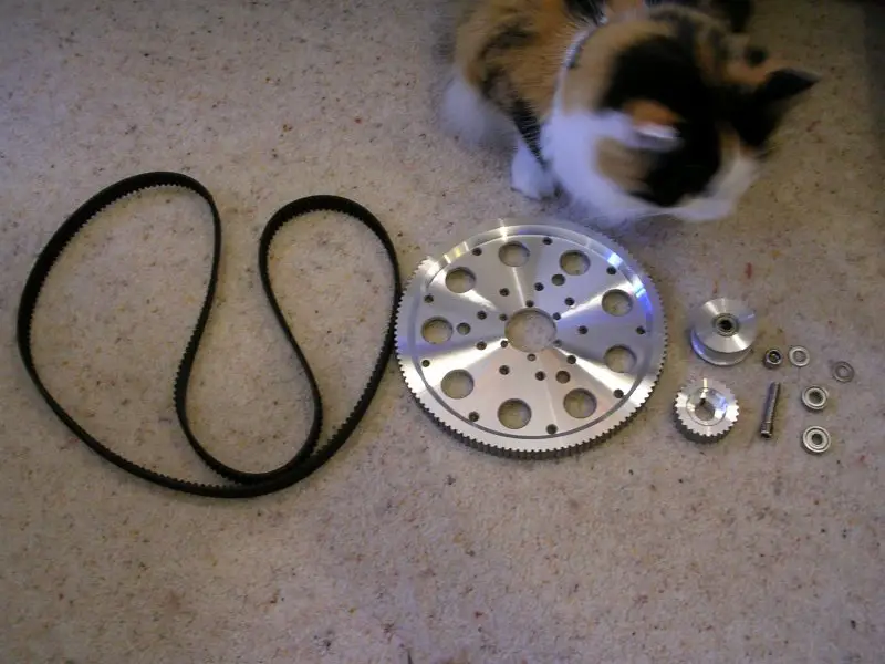

Been thinking about one of these CNC'd alloy belt drive conversions for a while. One of AliExpress's recent pop-ups on my PC offered it at a great price so I finally sprung for one and it arrived today. Thinking this might be a perfect upgrade for my first build, the little Indian tribute bike, which I'm planning on taking out of hibernation after two and a half years being holed-up in a storage unit here in Alnwick along with a couple of my other bikes since the house move back in 2019. If it doesn't work out on the Indian tribute, I'm sure I'll find a home for it on a future build.
Anyone have any experience of using one of these belt drives?
Tom, as Curt says, I first found out about the belt drive conversion kit via a forum advertiser's website. Being in the UK, problem for me is buying stuff from US sellers becomes way to prohibitively expensive once shipping and import taxes are factored in. (Still keeping my fingers crossed for the long-promised UK/US trade deal...). I purchased my belt drive kit from AliExpress for an all in price of 34 UK pounds. Including airmail shipping and there was zero VAT or import duty to pay upon its arrival. Also seen these belt drives listed on eBay by several Oriental sellers.
....(Said it before and it's probably worth repeating; In my experience I find it best to store anything of interest I've viewed on AliExpress. They track your searches via cookies and often start sending you pop-ups with tempting discounted offers for your watched items. But even on AliExpress it pays to shop around. Many outlets selling the same stuff at vastly different price points)...
So far, unless I'm mistaken, I haven't seen any reference to one of these belt drive upgrades being retro-fitted to a build on this forum. That's why I'm curious if anyone has experience of fitting and riding with one installed. I'm guessing fitting should be a no brainer - providing the belt itself is the correct length, or at least close to, - and the primary benefit of running a belt v chain is the greatly reduced noise.

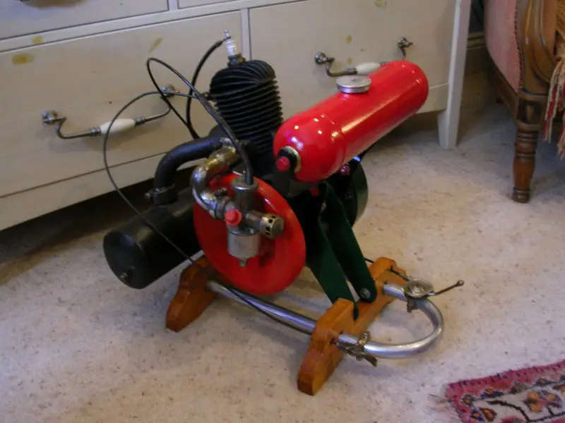

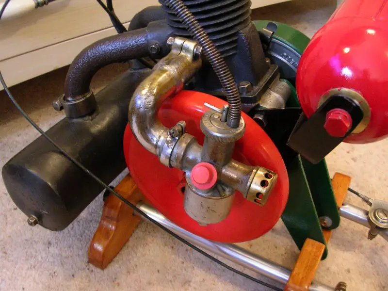

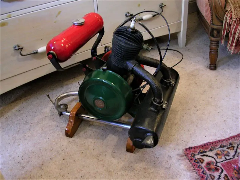

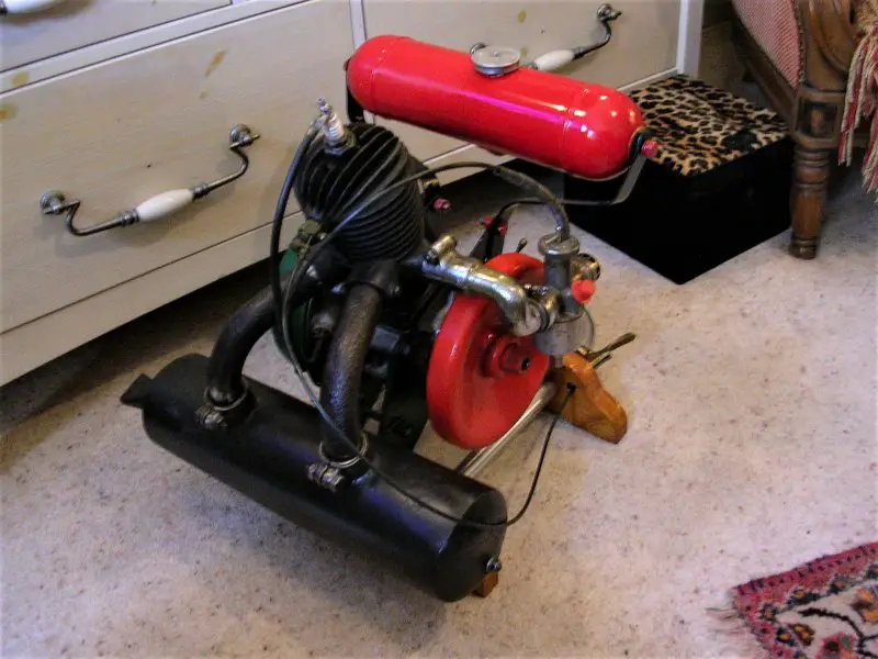

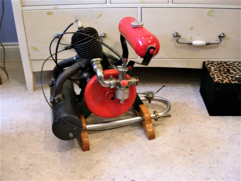

Received a pleasant surprise today when the Villiers twin port motor I purchased last week via eBay showed up a day ahead of the scheduled delivery date quoted by the couriers.
What a cool little unit! Pictures didn't do it justice. Obviously restored to a high standard by some previous caretaker, it looks like it'll fire right up once I've fitted a fuel petcock and hose which on first inspection are the only items appearing to be awol. As stated in an earlier post last week, the current seller said he exhibited it running as a stationary engine at rallies.
My online research leads me to believe this is a '30s vintage Villiers XIIC twin port, which would make it 147cc capacity - however, the engine's crankcase number, prefixed with ZF, is proving tricky to assign. Maybe this particular motor, like many, was intended for use in some kind of agricultural machine and not a motorcycle? However, the seller indicated this unit, complete with it's thumb throttle and decompressor lever, was very likely intended as a dealership demo/training rig.
I'm intending to use this engine - mated to a suitable vintage 3-speed hand-shift gearbox such as those from Albion or Sturmey Archer - in a future build, but even left as it is, I'm happy to share lounge space with this cool little piece of vintage history.
