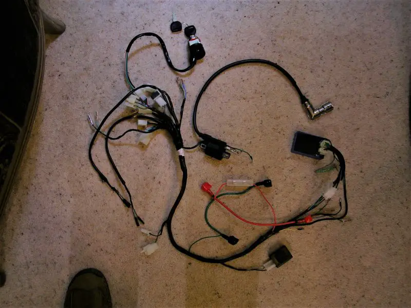

Been buying several bits and pieces for the latest build from 'OOracing', the folks who were the official UK importers of the Skyteam Ace bike I'm using a donor 125 engine from. They sell tons of spares too. Trying to make things as simple as possible for myself on the electrics front. Opting for an Ace loom and its associated electric components, hopefully means things will be relatively 'plug-n-play'. At least that's my plan....
Only drawback I foresee is that on my 'vintage' vibe build, there's not really anywhere to tuck a bulky loom out of sight. On the Ace, much of the wiring and stuff like the regulator/rectifier, relays, etc is hidden under the tank and seat. And I'm betting it'll be a challenge to fit all the multi-pin connectors within the headlight's shell. I may have to partly strip the loom and retro-fit sub-miniature connectors if that's the case. Or fit a larger headlight. We'll see....
Who knows?, once the Ace loom gets here I'll make a decision whether or not it's practical to go with it or wire the bike from scratch instead.

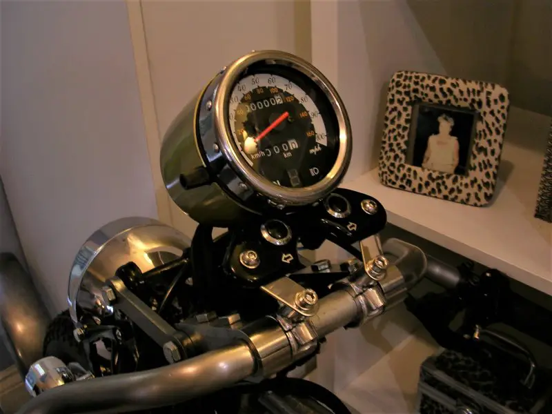

Wasn't too sure about the large speedo, but now it's installed, I reckon it works for this build.
Loom and associated electrical gubbins came in yesterday's mail. This'll be a challenge fitting it all in as unobtrusively as possible. Actually, I think it'll work out just fine if I can squeeze all the multi-pin connectors into the headlight's shell. May have to get creative.
On the bright side, all the connectors on the loom, electricals and engine do indeed make things pretty much a 'plug-n-play deal. Yay!
Right now I'm thinking it's time to consider fabricating a stowage box between the seat post and rear wheel to house some of the electrics such as the cdi and regulator/rectifier.

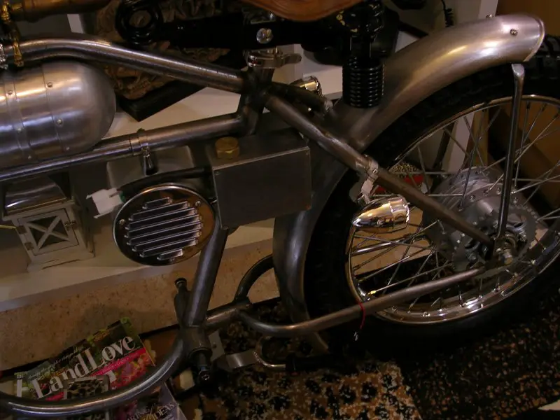

Opted to use a cast aluminium enclosure to house some of the wiring loom's electrics towards the rear of the bike.
Enclosure is one of umpteen sizes made by Hammond and more commonly used for musical instrument effects housings.
Ample room inside to hide the CDI, flasher relay and all the connectors relating to the rear blinkers, stop/tail lamp.
Intention is to disguise mine as a faux oil tank. So I've added a brass filler cap and later I'll plumb-in some copper oil lines to add to the illusion. Enclosure is securely fastened to seat post via a pair of stainless saddle clamps.
