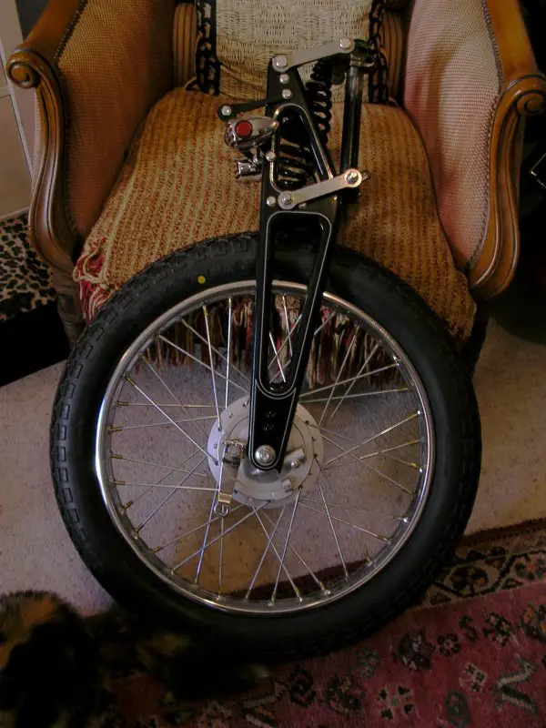

Girder forks dismantled and currently undergoing re-bushing and repainting. There was a little too much slop in the lower fork pins for my liking, so lengths of 13/32" brass tube have been used to pack the holes in the fork's cast crossmembers. The steel pins are now a snug fit through the brass tubes, eliminating any tendency for the forks to 'wobble'.
Fork legs repainted in satin black and, following the advice from fellow forumites, suitably pin-striped in silver. I'll give the black a few more days to fully cure, then give the fork legs a few coats of clear gloss lacquer.

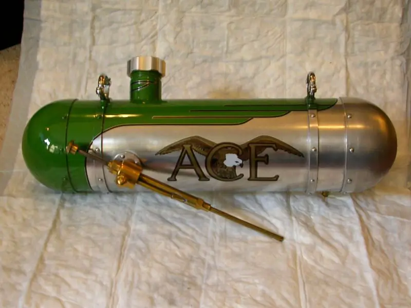

Girder forks now painted, pin-striped, clear lacquered and reassembled. Exceptionally happy with how they look.
Been held up waiting five weeks for an alloy rear brake pedal to arrive from an eBay seller in China. Gave up in the end and they refunded me, after which I bought a chromed steel pedal from a UK seller. First Oriental purchase I've had any delivery issue with.

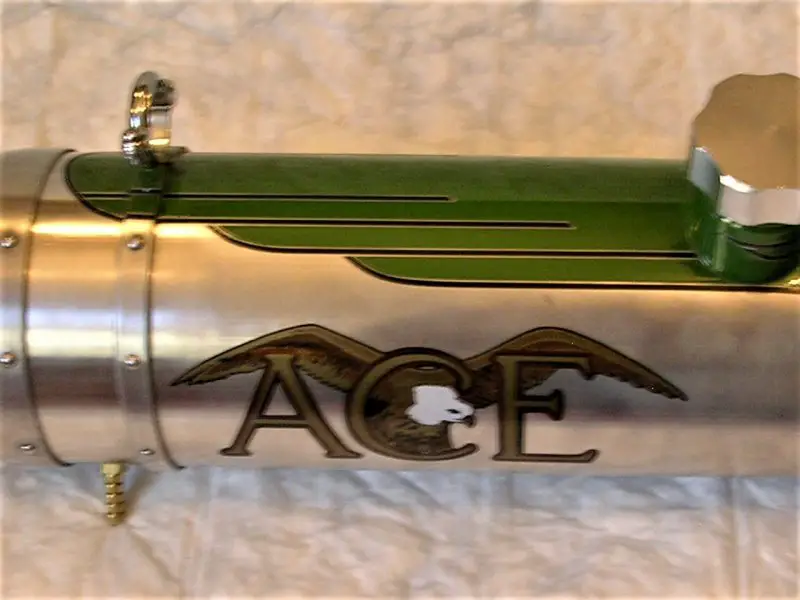

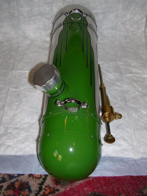

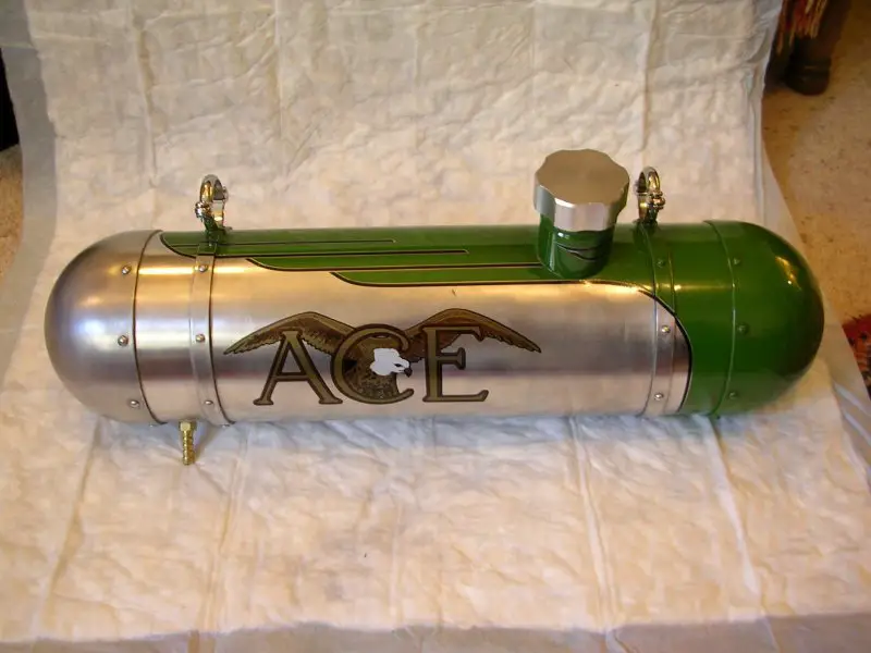

Turned my attention to painting the tank. Came up with a few options and finally decided on this green and bare alloy scheme, using the same green paint I sprayed the engine cases.
Sourced the vintage ACE decals from a reasonably local guy. Opted for these after I used so many Skyteam ACE donor components on this latest build, including the 125cc engine.
Just need to let the green harden for few more days then I'll add some gentle 'patina' shading round the rivets and tank bands before sealing everything under a few coats of clear.

Splendid work Pete and has me wanting to work on my torpedo tank which I've all the required metal components completed and laying about for a couple of years or more. I really like the paint and rivets contrasted with beautiful bare metal.

Thanks Tom. I see plenty other works of art on this and other forums.
This is the same cnc'd aluminium filler neck and cap I used previously on my Gnome et Rhone bike's scratch-built alloy tank. To vent the gas cap on that build I drilled a 1mm dia. hole in the centre of the cap and installed a circular sponge gasket under the cap to prevent fuel splash. I'll do the same on this build's filler cap.

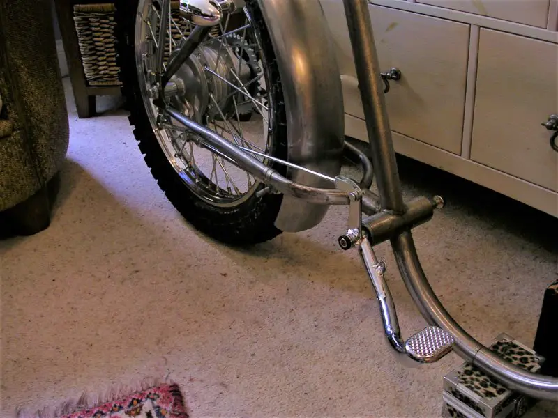

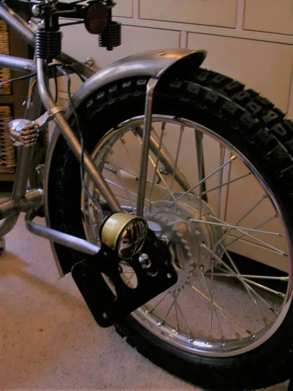

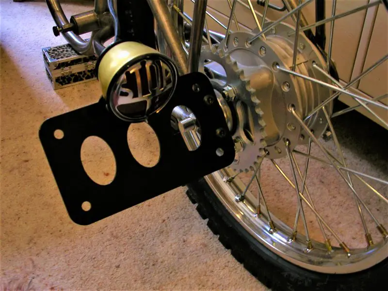

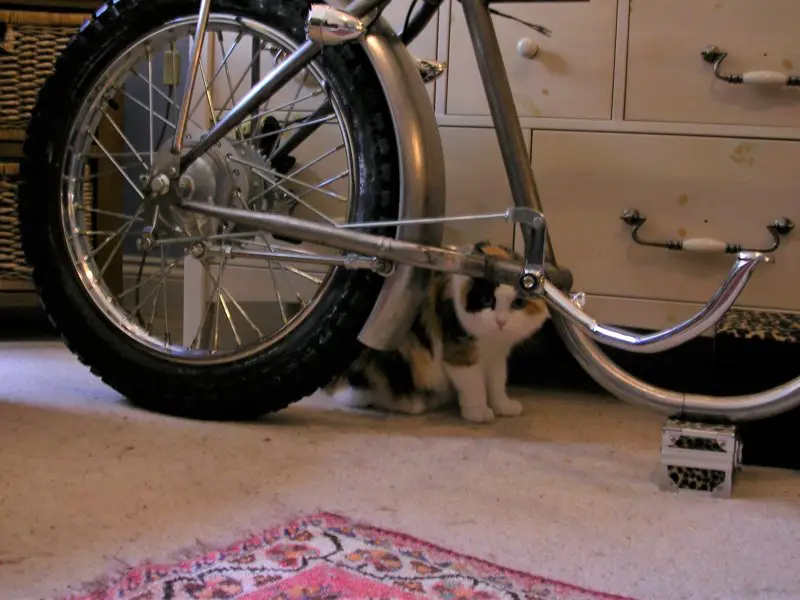

Rear brake pull rod arrived in today's mail, so now the bike has a working footbrake. Just need to fit some kind of bracket to the frame's bottom bracket to which I can attach the brake pedal's return spring.
Also going with a side-mount license plate with my preferred type of Vincent-style stop/tail lamp, albeit with the lamp's shell repainted brass colour. Reflector - which is a legal requirement for the MSVA test - now fitted to saddle's underframe.
Dadcat's little helper always has to try and have her face in the frame when I'm taking pics...

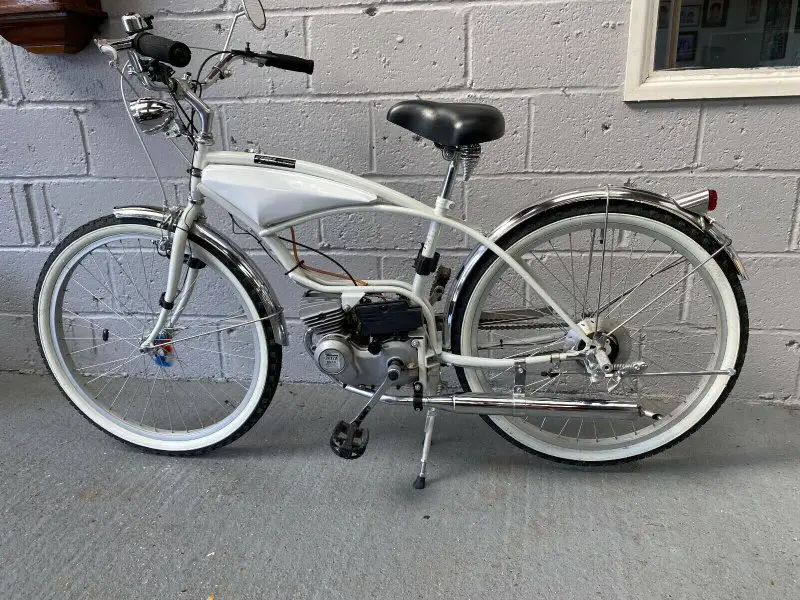

Well looky what popped onto my radar on UK eBay today. Kinda reminds me of those cool little vintage Ducati Cucciolos. This is a new one on me. It's a 33cc, 3-speed Japanese factory-made Fuki Planning - and jokey name aside, it looks a well made machine from the land of the rising sun. Offered for sale by a classic motor dealer here in the UK, this has got to be the only one to hit these shores. It's mega rarity value appeals to me, but with bids starting at 900 UK pounds sterling, I'll pass - even for something that has just spent its life as a garage ornament. For that price, there are plenty things I'd want to change for a more board-tracker appearance - starting with the the bars and saddle. And a set of springer forks with a Sturmey Archer front drum brake would really suit too.
For anyone with a spare minute, there's a full Fuki Planning website defo worth checking out. There's quite the range of different models. Downside is the motors are factory restricted to 20kph/12mph to comply with Japanese laws. Pretty sure that unrestricting them wouldn't be beyond the scope of anyone familiar with spanners.
