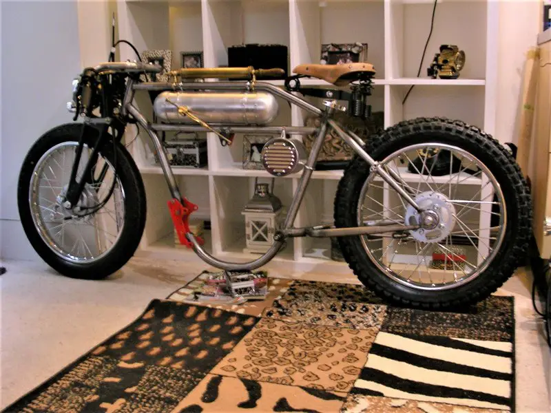

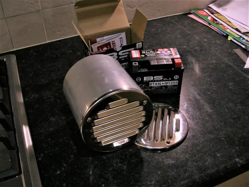

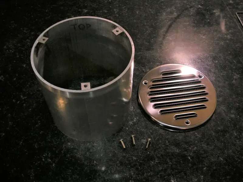

5" diameter aluminium tube and louvered stainless ventilation fascias arrived in today's mail, so work on the Battery Box for the latest build was able to get underway.
Saw the vent covers on eBay, and after checking dimensions, realized that when mated to 5" dia tube, they would make excellent end covers for a cool battery box. Those louvers also help maintain the bike's horizontal grille theme.
Used one of the covers as a jig to locate three mounting tabs cut from 10mm x 2mm aluminium strip left over from the gas tank's bands whilst brazing them in place.inside the aluminium tube using Alu-build300 rods and my MAPP torch. The tabs were first drilled/tapped M4 to accept the securing screws for the covers.
The battery itself will fit inside the tube, sat in an cradlle of 3" x 1" aluminium channel, to which it will be securely fastened with a stretchable rubber battery strap. The alloy channel and battery strap, together with another pair of Munsen rings which I'll use to fasten the battery box to the top & seat tubes, are due to get here tomorrow according to eBay. Gives me the sense I'm running this operation on the 'Just In Time' principle. ;)
Alu-build300 rods, where were they 40 years some ago? I have an aluminum punt, we call em Jon Boats. Any way mine developed a flex crack. I had to engage a professional welder to TIG a repair. Sorry for the aside Pete. :)
So am reading the weld rod flows from 715 to 735F whereas aluminum melts at 1,221F. Just expressing my ignorance.
Did you Scotchbrite the tube exterior after brazing on the mounting flanges?
Carry on Flash Gordon of the twenty second century. Your rocket is a rider.
Tom,
The 300 in the Alu-build300 rods refers to its melting point. 300 degrees may not sound all that hot, but results in a joint as strong as the parent metal.
On a couple of previous builds, I've used two types of aluminium brazing rods for building the tanks. Can't recall the name of the other kind of rod, but it's melting point was 700-odd degrees and was as hard as iron to file when cleaning up a joint. The Alu-build 300 files much easier. The higher melting point rods require the jointing areas to be vigorously cleaned with a stainless wire brush first.
300 degree rods don't require wire brushing of jointing surfaces.
I lightly sanded the jointing surfaces of the aluminium parts and the exterior of the tube prior to performing the joints. I did lightly pre-tin the joint area inside the tube with a film of Alu-build. TIP: Always pre-tin where possible to promote better solder flow..
The aluminium tube exterior was untouched after joints were completed. No Scotchbriting.
I'll admit to f_ _ _ing-up the first tab when I partly melted it while applying the torch's heat directly to it prior to introducing the Alu-build rod. After making a replacement tab, I then decided it would be best to apply the heat to the outside of the tube, allow the heat to be conducted through to the tab, apply the Alu-build rod to the joint, then watch it flow. That approach worked perfect.
Pete you discovered and applied a basic technique of welding, regardless the process, MIG, TIG, braze; when joining thick to thin 75% (at least). of the heat is directed to the more robust heat sink. I also really like louvers so the battery box (though I've not used louvers on a motor bike) is the cherry atop...
Rick C.

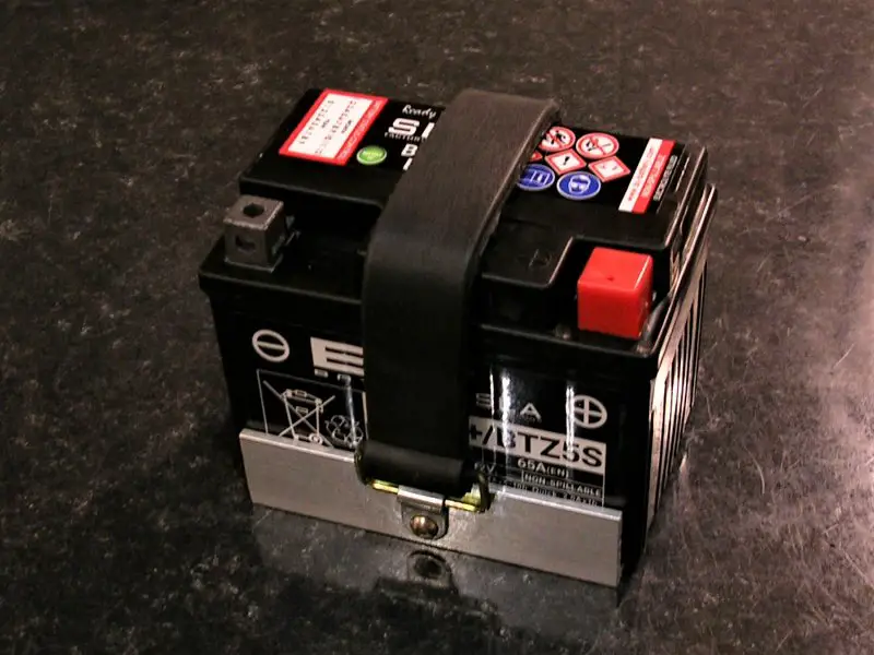

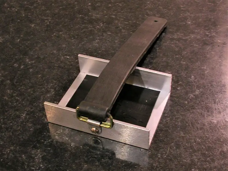

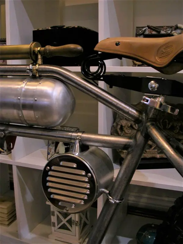

Battery box shell and mounts completed. Really happy how this mini project turned out. The louvres really suit the bike. Used a Munsen Ring to mount the box to the seat tube, and what I now know is called a Hospital Bracket - according to TNJ Pipe Fittings eBay store - to mount it to the top tube.

Hospital bracket has a single through hole, which I tapped and it's secured via a bolt inside the battery box's tube.

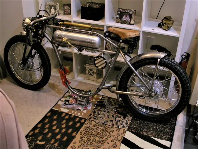

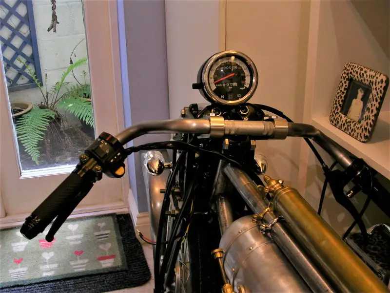

Speedo came in yesterday's mail. One of only two (primary) mph offerings on eBay. Only one which also featured illuminated lights for headlamps/blinkers/neutral functions. Everything else was kph. Didn't exactly realize it was this large. But needs must - so I'm going with it. Just need to fab a custom mount.
Shame only one of the two plugs for the speedo's 'lectrics was compatible with the plugs on the handlebar controls loom. I now have two FEMALE 9-pin plugs instead of a MALE/FEMALE. Buggery! Hate pi - - ing about with wiring.

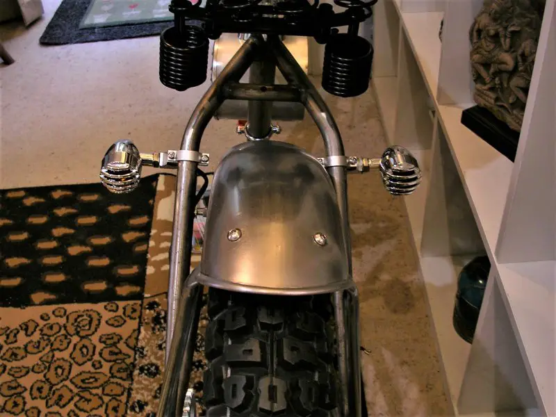

22mm (7/8") cnc'd alloy brackets for the rear indicators also arrived yesterday. These fit the bill nicely.
Pete I find the size about perfect, the early designers were not much into miniature fittings for motos or autos either and with nice clamps, which will compliment the brass pump clamps, the speedo will be stellar! A brass trim to the face of the instrument would make a nice match of things as well, to replace the chrome...but now I'm just being picky.
