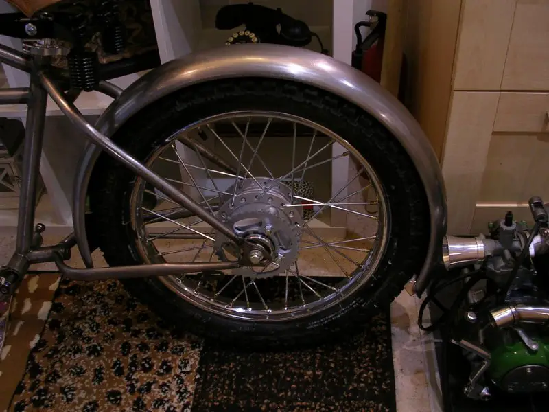

Received a surprise today when a fellow resident in the block knocked on my door and handed over a large curved package which had been delivered to her by mistake. Wasn't hard to guess it was the bespoke-made 27" radius steel rear mudguard I ordered on Monday via an eBay seller (pics below). Contacted him to chat about my requirements and he rolled the 'guard to order using the original UK machines and tooling. Features beautifully rolled edges and beaded end. Lovely craftsmanship and only a four day turnround. What's not to like? I originally specified a much shorter 'guard - about half the length of this - but the maker told me his 'guards are easier and quicker to make using standard full length steel blanks and to cut the 'guard down to whatever length I need. Now I've laid it loosely on the bike to see how it looks, I rather like the idea of leaving it as is. Thing is, seeing all this bare metal makes me ever more loathe to cover anything in paint.

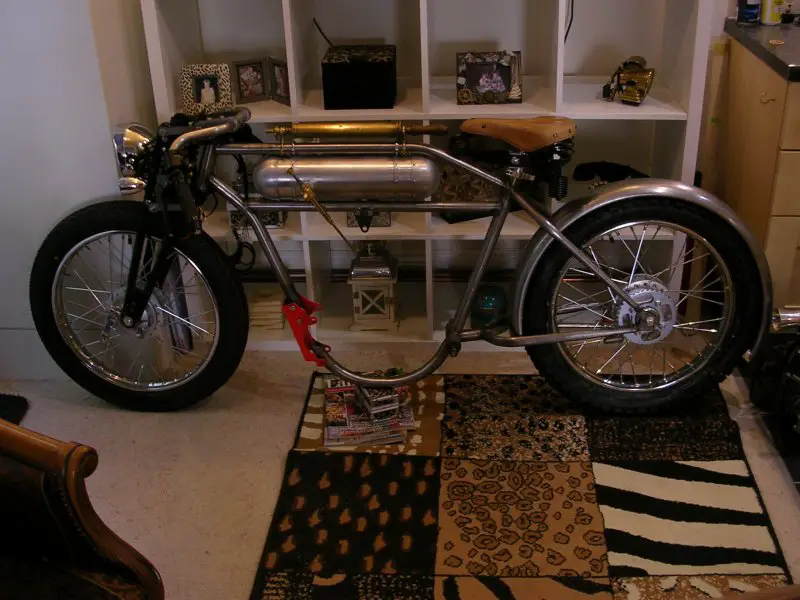

I've been prevaricating over whether to go for either the boardie or roadster vibe. The bike currently sits with those inverted/dropped handlebars, and as I discovered a couple of days ago when sat astride the bike while walking it round 180 degrees so I could photograph it from the other side, it's bloody uncomfortable perched aboard, leaning forwards, arse up, with both hands grasping the bars and only the family jewels balanced (read squished) on the nose of that Lepper Primus saddle. I'm thinking a set of pull-back tiller bars or beach-type bars would be far more in keeping for comfortable riding.

#757 You may have to split and hinge the mudguard full wrap. Chain stretch is going to be a bugger.
Nah, that wasn't me, Tom.
Rick would appreciate this 'guard. The seller/maker, Simon, makes it clear in his listing's description that all his 'various types of made-to-order 'guards feature scratches, imperfections and tooling marks. Not poor workmanship - just a hallmark of the traditional manufacturing process.
