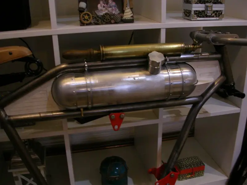

Those tank ends will work nicely for a tank on one of your upcoming projects. Presumably steel?

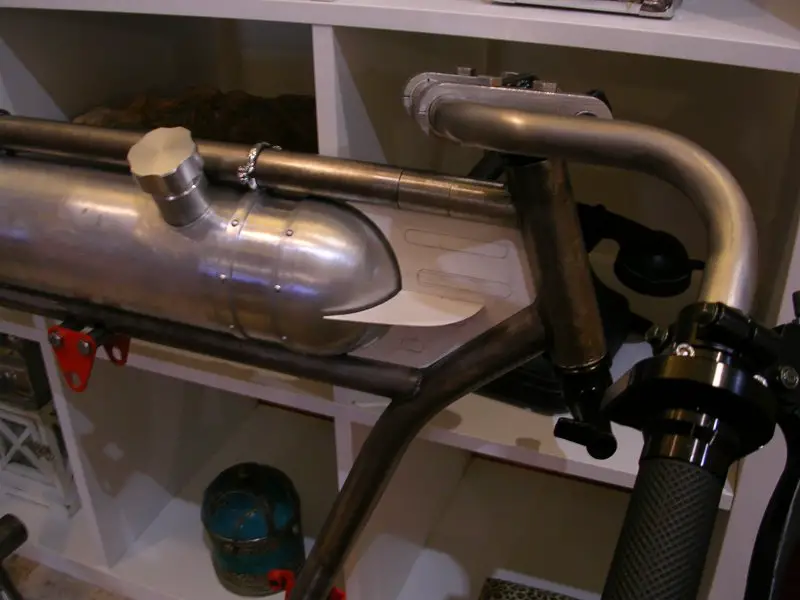

I lean towards aluminium on my 'home brewed' tanks. Mostly on account of it being convenient to use the 'low temp' brazing solders for aluminium such as the Alu-Build300 rods I used on this particular tank. For anyone interested, this time round I treated myself to a new torch and upgraded to MAPP gas instead of propane, which turned out to be really quick and simple when used in conjuction with these flux-less solder rods with a melting temp of 300 degrees. Joints are guaranteed to be at least as strong as the parent metal. Alu-Build300 solder flows like water once the metal being joined is up to temp. The secret is to clean the joint metal using wet 'n dry. No need to vigorously clean the joint first using a stainless wire brush as is required on other brands of Alumnium solder rods I've used. Then heat things up slowly and evenly to the required temp. Another benefit of Alu-Build300 is it files/sands really easily, making neat joints a cinch. Other 'low temp' ali solder rods I've used previously are hard as steel to clean up once joints have cooled.
As is my normal practice, once the tank is completed, I'll treat the inside with a coating of POR15 tank sealer.

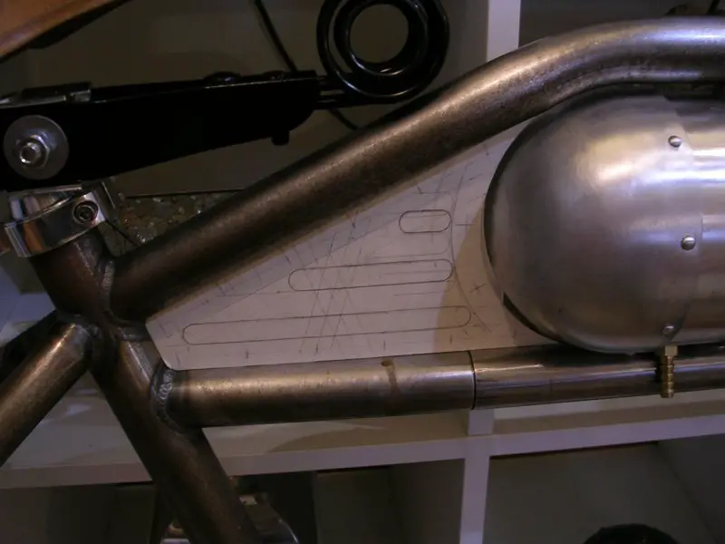

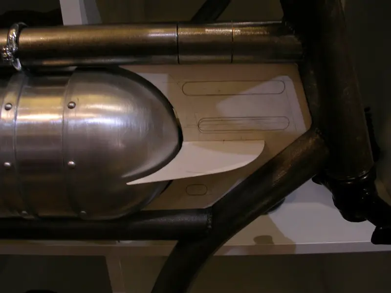

Having fun playing with card templates before committing to drawing-up the parts and sending them off to be cut from steel.
The theme on this build is to go with horizontal grilles on the headlight and indicators. So the steel panels needed to gussett the frame fore and aft of the tank will feature horizontal slots as shown in the pics here. Same design cue will probably be featured elsewhere - such as on the rear motor mounts which I'm about to draw-up.
Those gussett panels will also serve to reinforce the sleeved joints where I lengthened the frame's pair of top tubes.

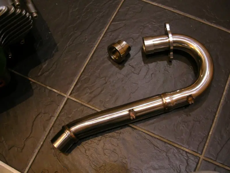

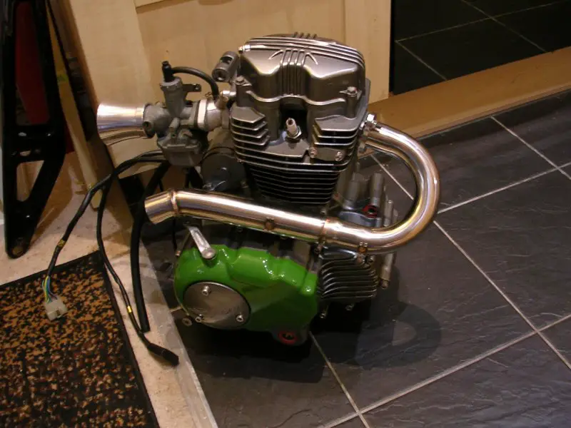

Modified the 35mm dia. exhaust from a Honda CBF250 to fit my Skyteam 125 motor.
Cut off the oversized 40mm dia. header flange and silver soldered on a new flange cut from 38mm dia stainless tube.
To finish it off, there's a perforated stainless heat shield on its way to me courtesy of eBay.
