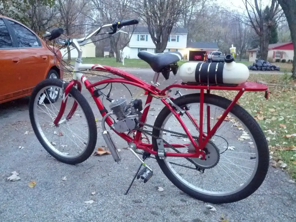

Nice looking bike apex..... I like the rear mounted tank also, trying to figure out for sure what it is, looks kinda like a coleman cook stove fuel tank but cant tell for sure, whatever it is it looks like its doing a great job.

That tank is a windshield washer fluid reservoir from a 1970 VW bus. They were a pressurized vessel so its quite stout. Gas doesn't react with whatever its made from either. My peanut tank didn't last one fill before leaking.
I'm thinking about trying my hand at fabricating a small copper tank. I have a slip-roller and a metal shear at work, I've brazed pipe before, for plumbing purposes, so I figured Iwould give it a go. I ddon't know how to tackle the filler neck/cap assembly, so I may just use an-fittings.
