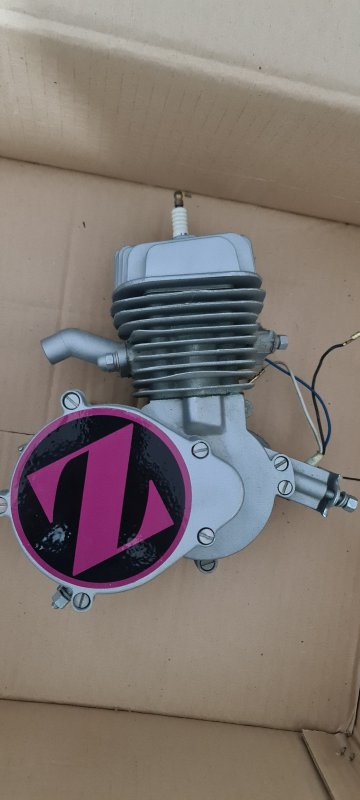

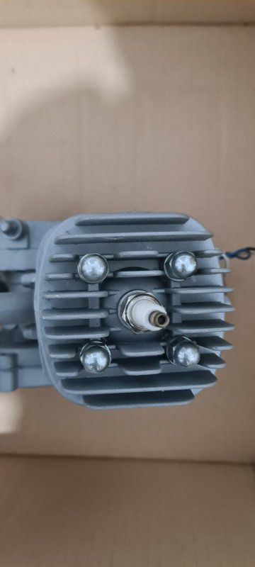

Okay so i made another post but it was pretty vague so I'll just make a fresh thread with pics, so I was scrolling gumtree and came across someone selling a old zbox motorised kit they had never opened and had just kept in storage and they didn't know if it was the z-80 or z-50
So went for a look everything was there just still unsure if it's the 80 or 50 as I can't find images online any help appreciated.
Avoidable teething problems, things not to get lazy with and things to make certain are correct much appreciated
P.s the bike I have is OK not good ( I paid 90 for the kit, bike was free ) so what would be the absolute ideal bike to keep an eye out for?
