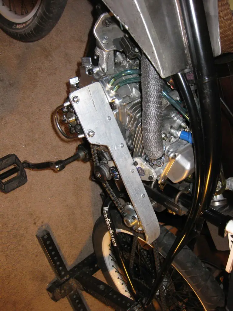

These are some pics of a guard I made for the drivetrain.......simple, cheap and effective. This is prototype #2......#1 isn't finished yet.....
This set-up is one inch narrower than with the CVT. I think you know what the purpose of the guard is. Joker Machine will prolly get a good laugh outta this one :D

i like it. the clutch guard is awsome dennis
Perfect for riding with thongs.
last time I rode one with thongs the edge of the clutch drum cut
up my big toe. :D

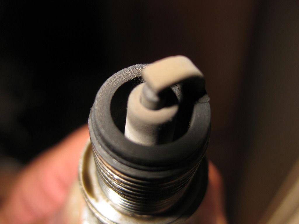

So I pulled the sparkplug today to see how it faired after a hard day at the track, and this is how it looks:
This is the original sparkplug with less than 40 hours on it in the one year of racing it.....not bad.
With the new jetting and higher compression, I think it looks about right with the new fuel blend. The bike was geared right and the acceleration was impressive.

I am glad to hear that the new engine/ trans worked excellent.
The spark plug looks perfect as well.
