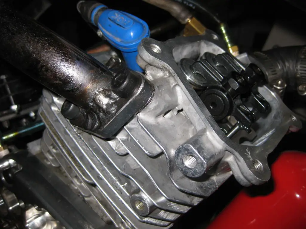

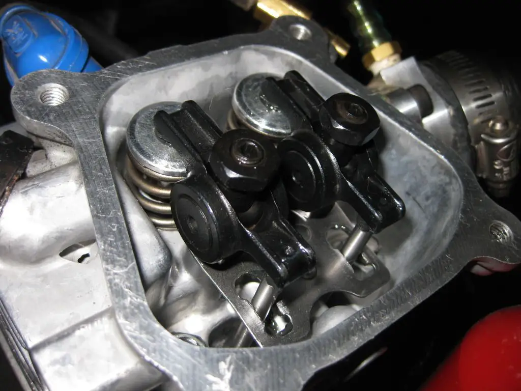

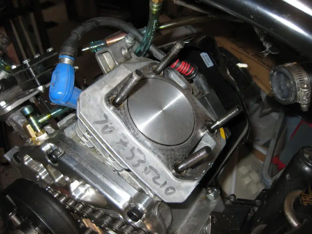

Had to turn the flat top piston down .098" for zero deck height. Then did a test fit and the rod wasn't clearing the block on top......I clearanced the block today and it's coming back together.......slowly.
scotto-
Custom 4-Stroke Bike Builder
Jun 3, 2010
6,505
25
38
Ridin' inSane Diego, CA.
What are you putting in that thing a stroker crank .
Andy......why would ya think something like that? Here is a pic after I clearanced the block, it was an easy job with the Dremel....

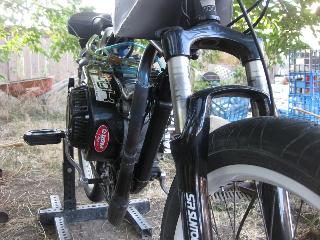

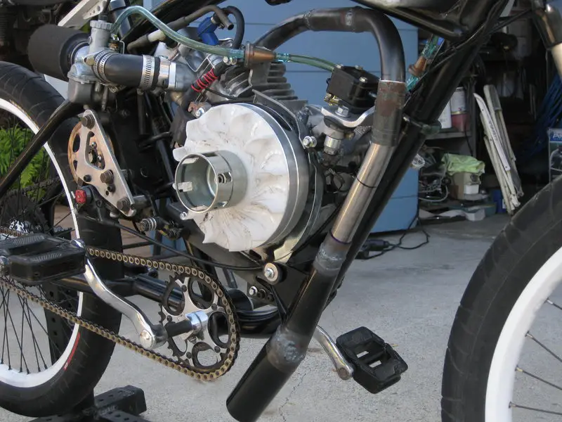

And here is the new pipe.......
URL=http://imageshack.us/photo/my-images/526/img1896ke.jpg/]
[/URL]
URL=http://imageshack.us/photo/my-images/716/img1907bq.jpg/]
[/URL]

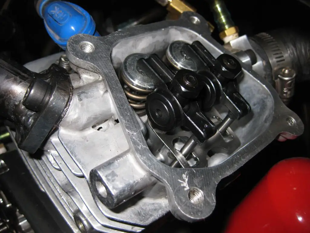

Well it looks like 2 bent pushrods was all I got from Apex. The piston, valves, rockers, lifters, cyl. head and all else are in fine shape somehow. The pushrods musta been a lil too long so it seems.......i'll letcha know after I drag race through the neighborhood a coupla times......

scotto i see no marks on the piston. any idea why the push rods bent? you got some strong valve springs. rocker geo wrong and coil bind? or maybe 10,000 rpm. good luck glad to hear its going back together. see ya bro. dennis

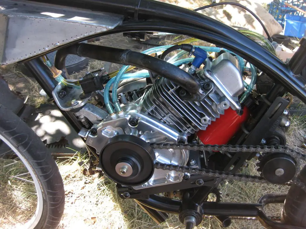

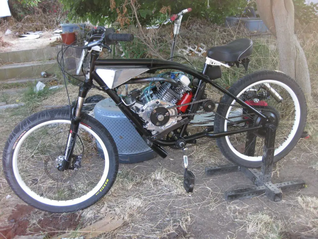

Well thanks Dan.....and Dennis......and Andy, here is a better sight
and even better yet, the sound
http://youtu.be/5pjAf6DU_QE
It was a bit of a pisser when I was putting the engine back together day before yesterday.....I go to put the head on and notice I'm missing a lash cap (again). I looked for the thing in the vacinity I was working in for hours and finally gave up and ordered a new pair yesterday. Then thinking back, where could I have lost that tiny miniscule thing, it donned on me......maybe it was over at my folks house where I was doing some work on the head and it was last seen.....over a week ago.
So I go over there with little expectation of finding such a tiny little part, pull up in the driveway, get out and look along the front deck to the garage doors and see nothing of course. Then before opening the garage doors I look to my right and 8' away on the driveway I see this tiny little button sized thing and YES, cha-ching.....there it was!
And so short story made long, I got the ol' Slant back up and running today finally.........look out Iceman! :D

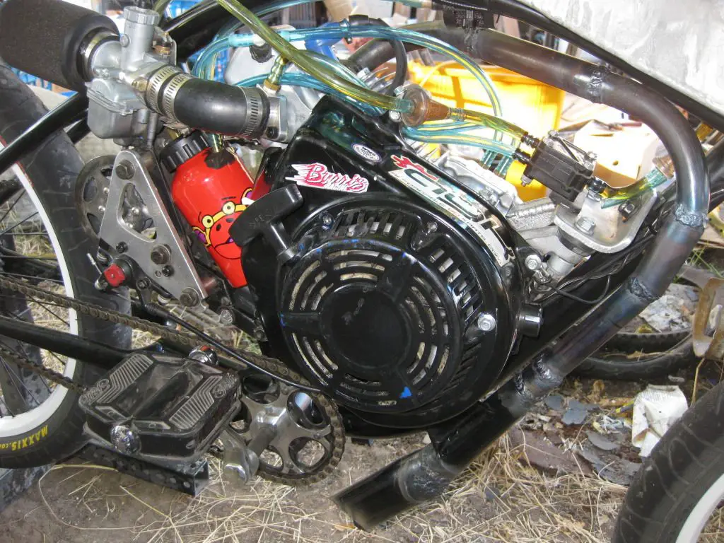

Here's the pipe after todays ride......
The pipe sounds so much better when decelerating with the angled exit.
It's LOUD and powerful
