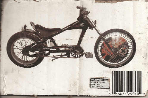

What kind of clutch did u use for speed scotto?? I am building a chopper and I have no idea where to get a clutch that will give me the full power and speed! Could you post a link?
That's a nice clutch but way out of my price range! Do you have a clutch you could recommend that would be cheaper an have torque and speed with the 212 predator? I'm looking to go 50 if possible what size rear sprocket should I use?
