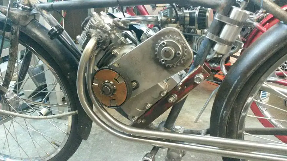

AWESOME! can you explain how it was changed to come out the side?.......................Curt
Not to sure what he is on about. It may be the twin pipe exhaust manifold. I will speak to that. The bolt holes were to close to the pipe so we used a pice of tube steel and built up the mounting points. What your seeing is a exhaust flange with tube steel stand offs and washers welded op the top of the tube steel. Where you see the bolts sticking out of the sides.
Curt I think he is asking about this
http://motorbicycling.com/attachment.php?attachmentid=73045&d=1412193162
Looking at engines now I really like that flatt top I may do that again
Yep that's it,normally the exaust comes out the front next to the carb not out the side of the engine..............Curt
Hey Guys,
Looking back at the "Rat Named Ward" thread, it looks like Lab Rat used a Tecumseh engine, which I guess has an exhaust port out of the side instead of the the back like a Briggs.
Looks like the confusion started with Lab Rat posting that picture in relation to "is a 4hp briggs too large". The Tecumseh is the same size, but posting that picture did make it seem like Lab Rat had modified a briggs to have an exhaust port on the pto side, quite a stupendous feat of machining!
Gilbert
Ok I see now its a Tecumseh. Guess I was so impressed with the twin pipes I paid little attention to the engine. Not all the Tecumseh small horizontals had the side exhaust. It was less common. Seemed to be a tiller/edger application.
