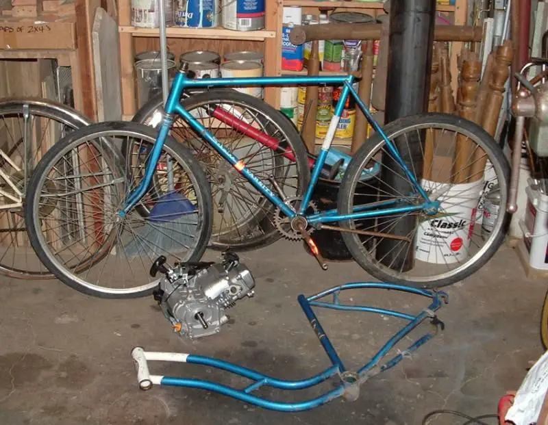

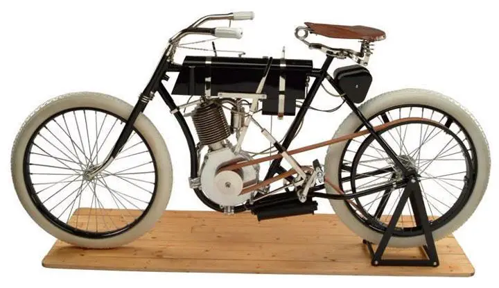

A old Schwinn Varsity frame is the main donor with a little help from a old girls AMF Roadmaster fork & it’s slightly modified down tube. A “vertical” HF 79cc Predator engine will be the power plant.
Unlike Excalibur ‘09 this one will be freshly “restoration” painted and not a rust bomb.

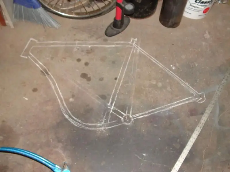

I worked the basic geometry out on the shop floor...

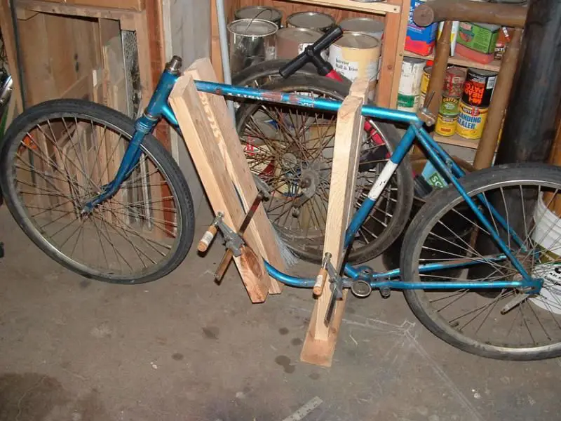

I’ve found using scrap 2 x 4’s really helps keep things true & aligned! For the initial fab I like to use internal sheaves and self tapping screws to join sections of tubing. I’ll strip the paint before welding and sandblast after.

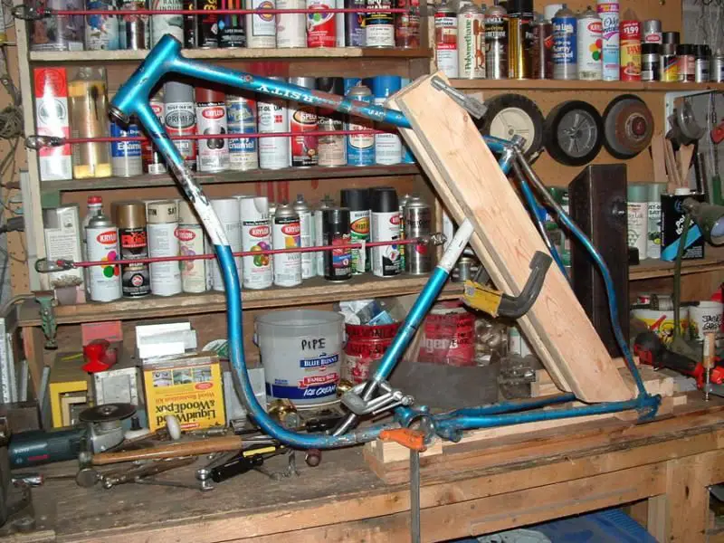

I also made a quick wooden jig to help with the rear triangle alignment. Getting the seat stay pulley bulge is where I’ve left off on the frame for now.

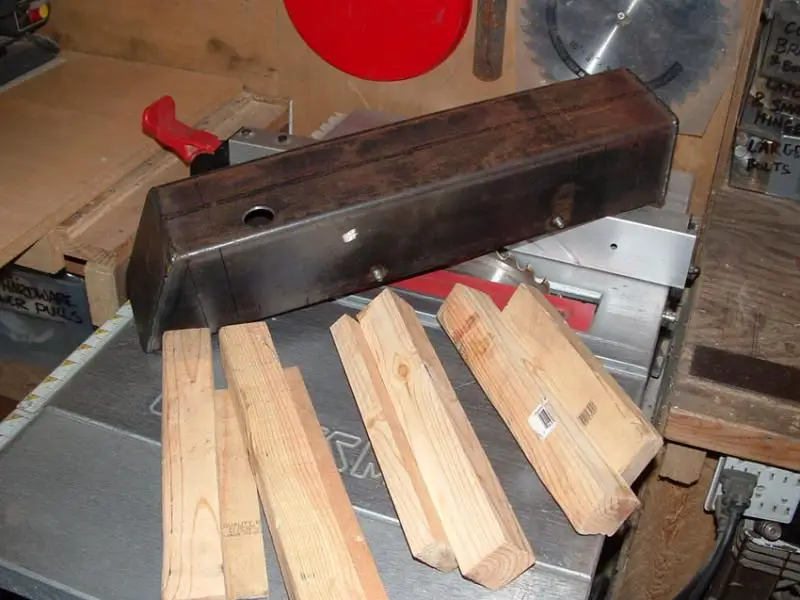

But I do have the gas tank fabbed, just a simple 4” square tube with welded end caps. It will be directly welded below the top tube and then covered above with a fake round top oil tank.
This should more than make up for the lack of strength that the true to ‘03 Harley single top tube originally had.
I’ve made 4 wooden angles to center and square the tank when it’s time to weld it in place.
More soon!
-Kirk
Thanks for the suggestion LR, fortunately I’ve already have a nice set of white 26’ x 2.15 Kenda tires...
Russell, for the large driven pulley I’m going to use a 24” bicycle rim strap mounted the rear rim like the original ‘03 used.
It’s a rolled rim and has a stepped down id that will work good with a #2 V-belt. Lever tensioned idler for the clutch just like the Harley.
I’ll figure out some way to fill the spoke holes, or use long tabs on the straps to cover them like I did for my Excalibur ‘09 build.

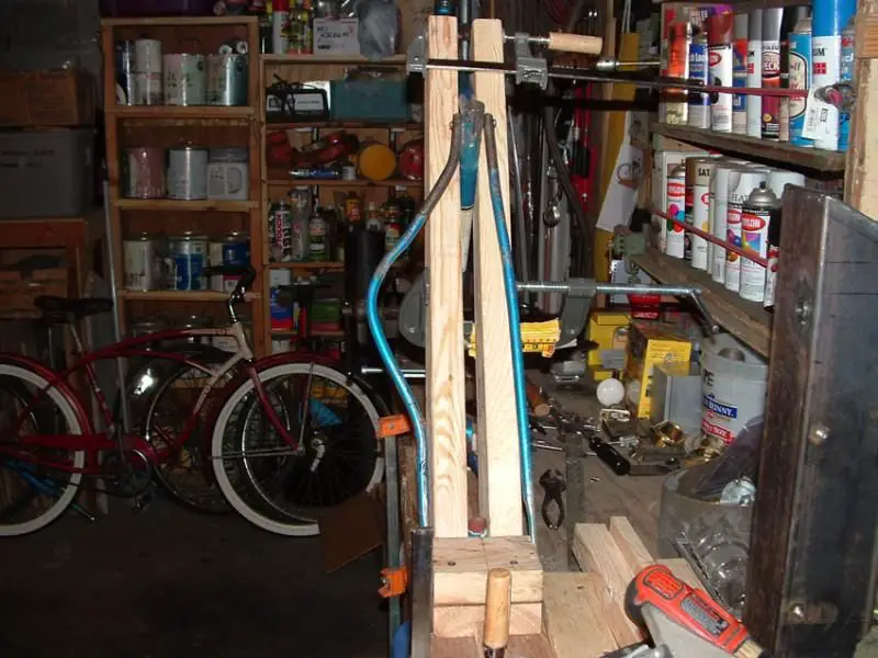

Also...Can you tell what donor piece you used for the pulley bulge on the seat stay? To my eye lt looks like a larger diameter tubing. Is that one of the down tubes from the girls bike donor? And if so, is the smaller diameter stay inside it (the ends, I mean, since you must have cut away a good bit of the original. I suspect I'll be facing the same problem. I don't think just crimping the frame on my 51 Schwinn is going to be enough. Looking for some guidance into new territory.

Did you flip the headtube to make the headtube angle slacker? Looks like you also added some length to the top tube?
Good eye!
Yes I flipped the head tube, not only did it give a rake close to the original Harley, but now there is only one joint to weld on the 3” frame stretch.

I simply pounded a tight fitting solid rod into the existing seat stay, then you can bend away without crushing the tube.
The new 1/2” tube on the top end is a match size wise, I think perhaps it must just look larger in the photos because it’s not painted and catches more of the camera’s flash.
But it was actually quite physically hard to pound the rod all the way down the pulley side stay (fortunately it’s just a much shorter inner sheeve on the chainring side).
And then it was awkward make the bends while the frame was in the jig.
If I was to do it again I’d use MUCH more new tubing and bend it before attaching it to the frame. Fortunately while the new tubing is still a tight fit, it does slide over the rod with out pounding.
Hard to beat the quality of the old Schwinn’s but the slightly thicker tube walls can cause a few headaches...
I’ll definitely make the wheel stay bulge off the frame, it will also make it much easier to match the bend of the seat stay!

But yesterday I did work on it a little. I finished the lower pulley side wheel stay and redid the top one to better match it.
Here’s a couple of detail shots for of the lower for Silver Bear’s sake.
I also clamped a oversized motor mounting plate, I’ll trim it down later when I have the drive train/engine placement worked out better.
I'm ready for the next round of welding, although with a busy week already planned I don't know when I'll get to it.
