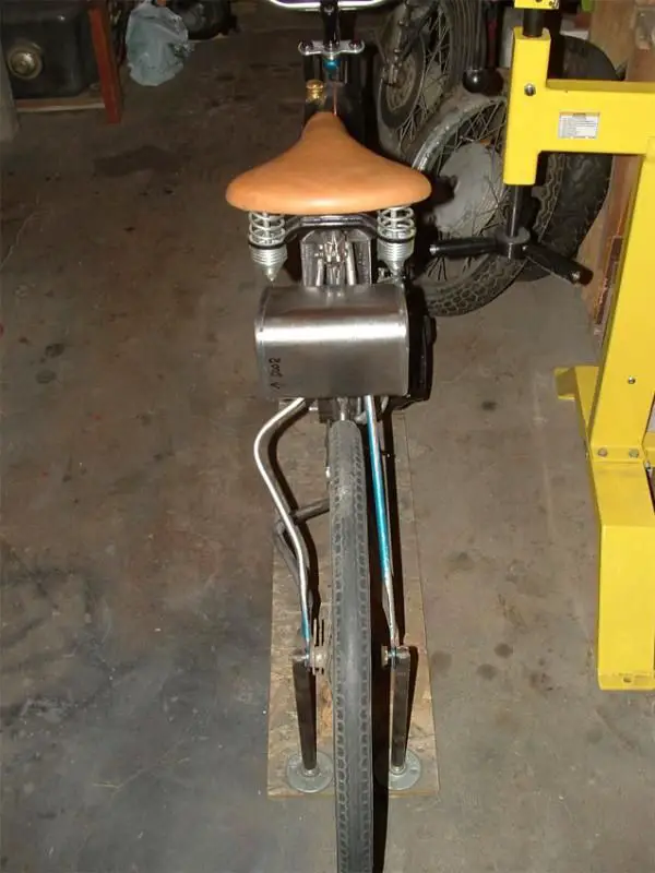

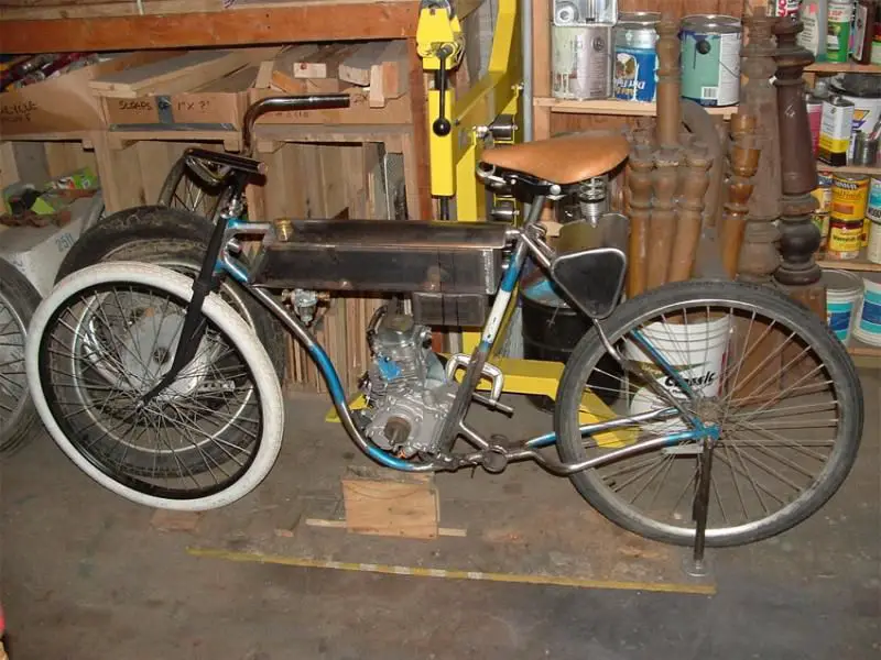

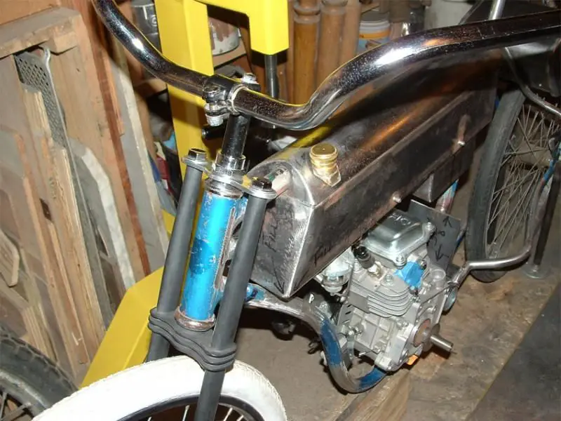

New fab- Just finished the filing, grinding, and sanding last night.
-Forks are finished and in primer.
-Engine plate extended (measure once, cut twice rule, uuggg)
-Fake over the top bar oil tank
-Brass fuel filler bung and “garden hose” cap
-Triangular battery box (ala a tool box)
-Various tabs, gussets, & brackets
-2 finger tips with 2nd degree burns, (ouch, this hobby is rough sometimes)

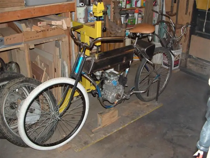

Shown here in quick mock up.

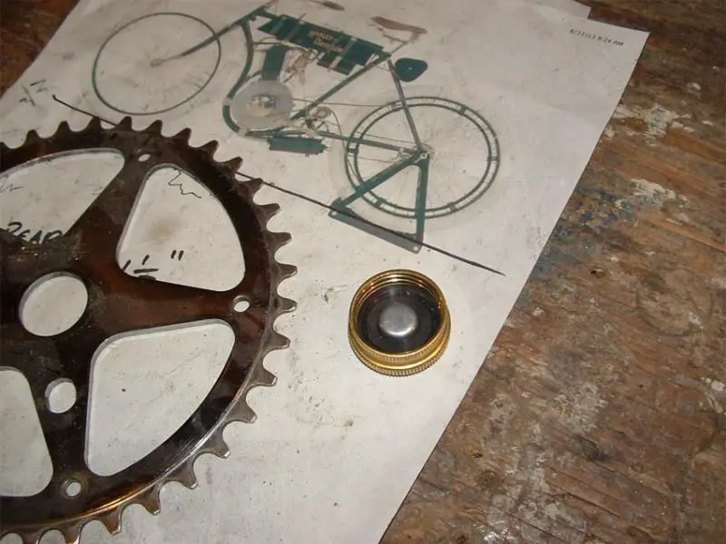

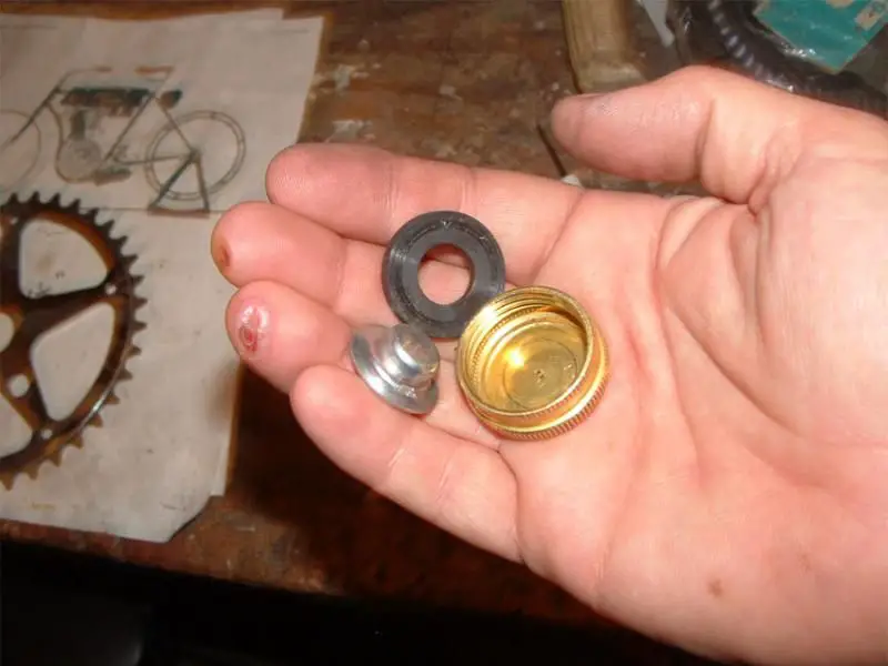

Also, a new vented gas cab concept-
I found one of those little hat shaped axle caps fits perfectly between the hose cap and the gasket. It already has vents built in with it’s locking taps pushed down flush. And then a hole in the cap with my tiniest bit...
Hope it works!

Your bike is looking mighty fine. I like that little axle cap for the brass garden hose cap. Where do you get those axle caps? I made my innards from a plastic bottle cut into a sort of flower deal with petals sticking out, which works fine, but I like yours mo betta.
SB
Cool build for sure and excellent idea on the cap vent. I used a similar brass cap and an NPT by hose adapter fitting for the oil fill port on my 79cc Predator build. Got the idea from CCC. Simple solutions are always the best and the most reliable.

Totally awesome. It realy amazes me what the things you come up with,just used some of the axel nuts on a cart never thought about a vent.a

Just a newbie question. Is that a Harbor Freight motor you have mounted? Any oiling issues with it rotated so far forward? Looks so much better rotated like you did.
Welcome to the Forum!
At first I would never imagined these engines would work well upright myself. And yet for a few years now folks have been doing it and sharing their results here. Some with thousands of miles logged already.
Originally it was a much discussed topic, but after much experimenting by brave pioneering forum members it’s generally a accepted practice now.
If it’s something you might consider yourself, read through some older posts (especially in the 4 stroke section) or search specific questions and you’ll find numerous tips & ideas about mounting, building custom manifolds, recommend oil fill amounts, etc...
