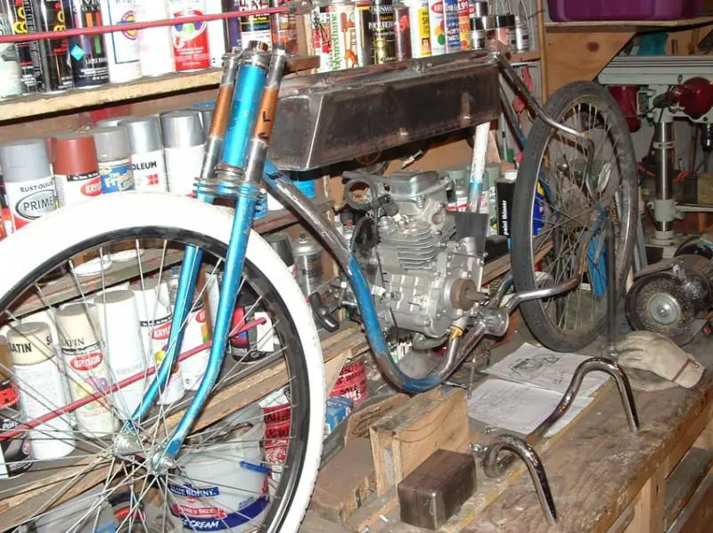

The tubes with the rod in did you cold bend or use heat? ..............Curt
curtisfox
Dec 29, 2008
6,082
4,058
minesota
Thanks!
Curt- Yes bent cold, I’m hard on vices! :- )
-Kirk
Me to between me and my dad i have two old Rail Road vices. Down through the years i managed to spring the jaws on both bending heavy metal, and its a lot bigger then yours. But i haven't broke eather yet.
I can see another lean to on the other side to balance it out in a couple years. More stuff more shed....LOL................Curt

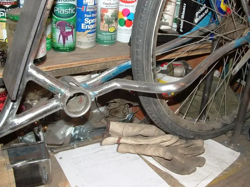

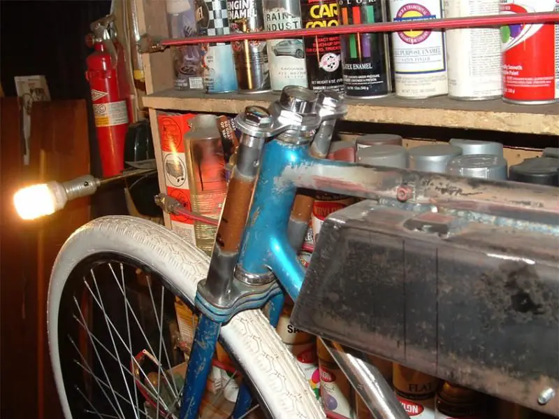

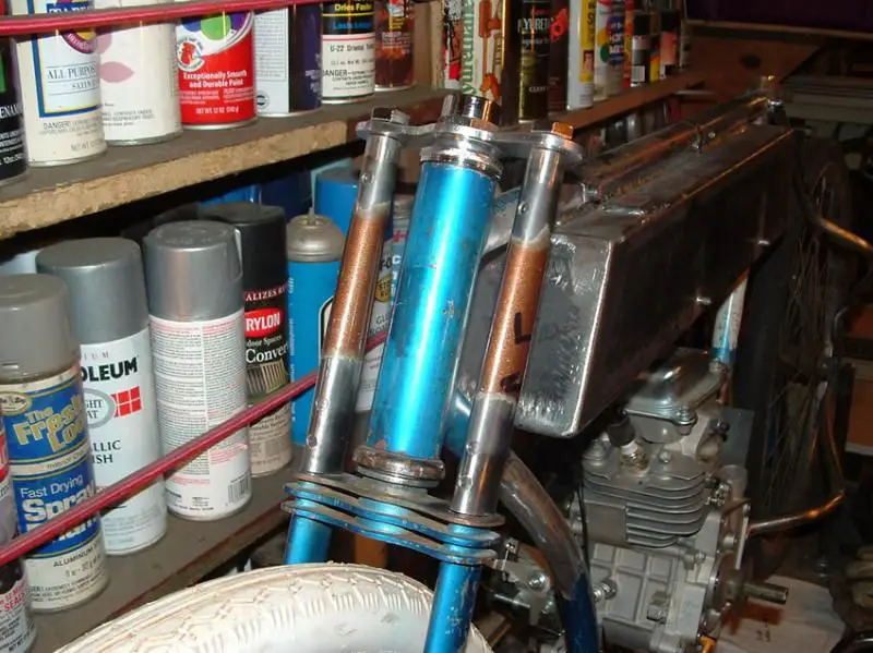

Had a little time to work on this again last night...
Welds are all ground smooth and read to go.
Harleyesque triple tree is fabbed and ready for plug welding and braising.
The top clamp is made from 6mm aluminum plate and the upper blades are from another old Schwinn 10 speed fork.
$5 worth of 1/2” chrome cap screws tie it all together, kinda missing my old friend rust.
I plan to repurpose pieces of the bike’s original race style handlebars into a exhaust pipe and a intake manifold. Creative staring shows they’re going to line up pretty well.
-Kirk

Mr. B got Talent! NICE! DIG those Forks Please! find more to work on this Baby Cause I can't wait for the next set of pic's.

I'd say Kirk is a master of the "Creative Stare" having an idea of what he wants and then looking around through his department of dead stuff & donors and finding just the thing he needs once he's re purposed it. I love this kind of build and this one in particular is going to be outstanding.
