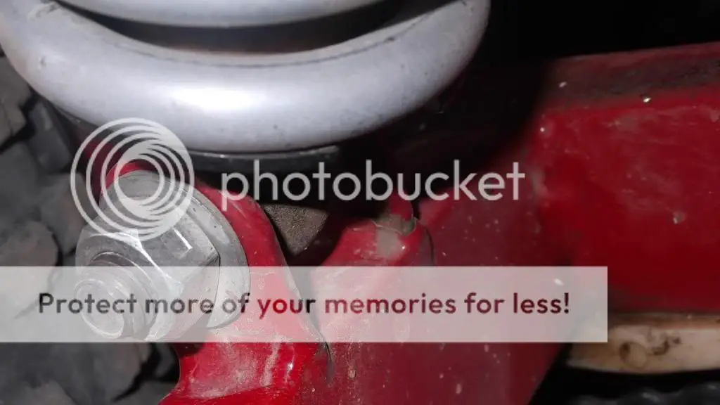

Starting to notice stress cracks in the paint. Most noticeable on the rear shock mount and motor mounts. A few other places but those are the worst.
Will get some photos up later when i have the time.
looks fine to me as well.
Keep a close eye on it if it bothers you and ride the wheels off it!
Did a better inspection pulled the motor off the frame and checked every single weld.
I think its all in my head, I saw nothing that should alarm me. Think I just got a little paranoid.
