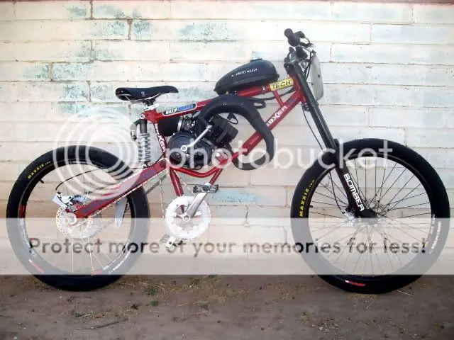

Re: Dave31 scsw BoXer
No wear there but at first the engine drive chain was too loose so i put teflon rectangular pieces on the frame held by zap straps works fine later i also moved the rear wheel back some andd no problems it lifted the chain enough for good clearance.
Just a reminder this is after 2 years and thousands of miles on my BoXer.
First thing I am going to do is adjust the chain to its proper tension. Combination of loose chain and soft suspension set-up for off-road that caused this problem.
Yes, the BoXers custom made by Dean.
Issues? Just normal wear and tear. It can be a pain to get both chains at the proper tension but it can be done.
Most BoXers don't come with my brakes, not hard to find after I really got looking for them. Just finding a set at a price I was comfortable with was the hard part. Any bike shop will be able to order the pads for me if they do not have them in stock.
Well, the chain will be fixed with proper tension and just stiffening the rear suspension will avoid chain on swing-arm contact. But I am going to weld it up and add something for the chain so we dont have chain on swing-arm contact. I will post it as I get around to repairing it.
Millage 40-50mph? First my BoXer only tops out at 42mph. And mileage? I have no clue, never kept track of mileage. I just gas up and ride!

According to this photo, the exhaust seems to end abruptly. It looks like the exhaust is going right back into the engine. There is no stinger?
Kristof I am ruining a 48T sprocket, so is my buddy Alex with his 9.4. I get 42mph he gets 48-50mph with the same 48T sprocket.
The exhaust runs into the frame at the top bar and exit's on the down tube.
