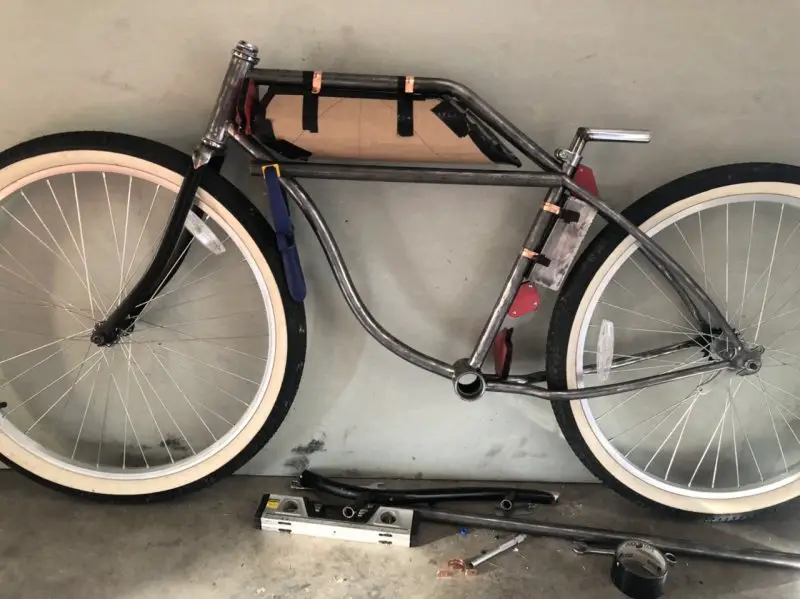

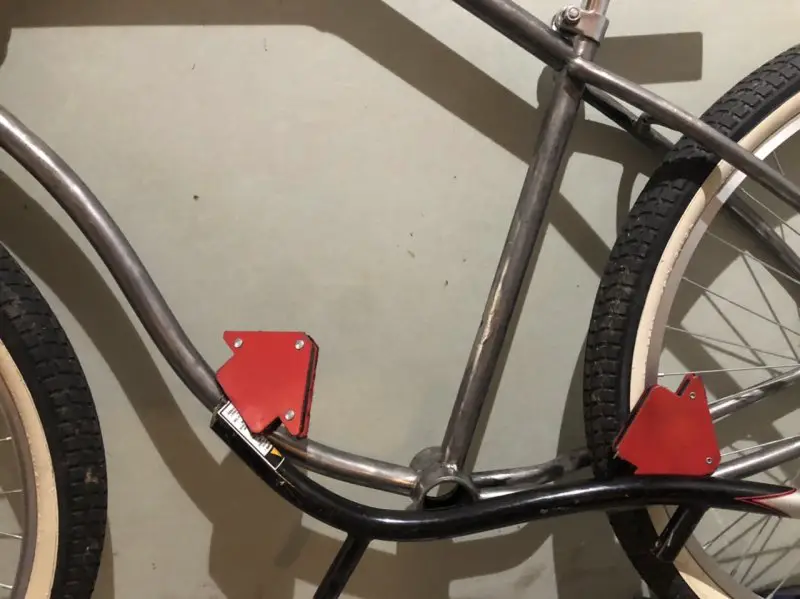

What’s the consensus, should I wait before I braze these 2 pieces of tubes and put my new forks on to ensure it doesn’t change the stance of the bike ? Sounds like a decent plan to me but I’m bicycle illiterate
If you look at it and take top bar and cut and fit it in the bottom bar, you would gain a deeper loop, plus a extension for a better look.
You can also maybe fit 26x2.35 tires in it. Print some shots and photo chop, just make sure you sleeve the frame with rosette welds and alignment jig to keep it all straight.
It has been done before in some older builds, but all takes time even looking through old builds. Something like this you have to know what engine you want and have it all planed out, and even have a quicky build to ride and resell while you are building. .............Curt

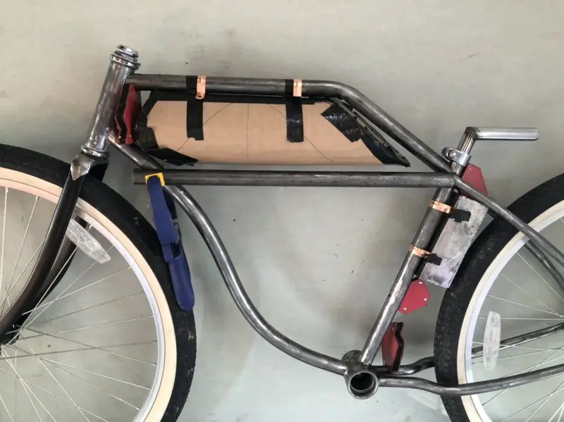

The other night with my first tube notching experience I learned a few things. I was drilling a 1/8” pilot hole and then trying the hole saw. Broke all but 1 of the 1/4” bits I had in the garage. Then I figured out I need to go ahead and drill out the Pilot hole with the 1/4” bit before proceeding with the hole saw. Needless to say the hole saw took a beating as well. Missing a couple teeth. So pipe notching will continue when I get another hole saw lol.
In the meantime, I took my cardboard tank I made and taped it between the pipes. Obviously it’s a tad short. Anyway thinking of supporting it with copper pipe straps.

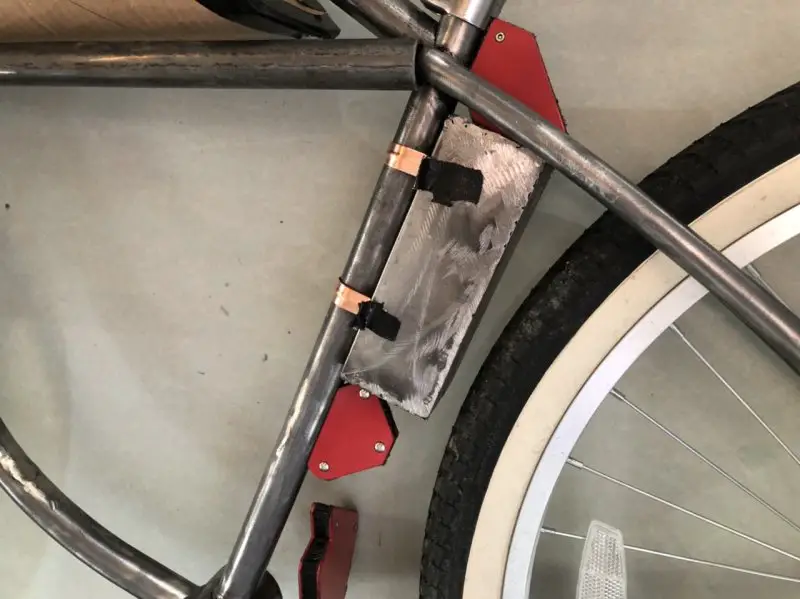

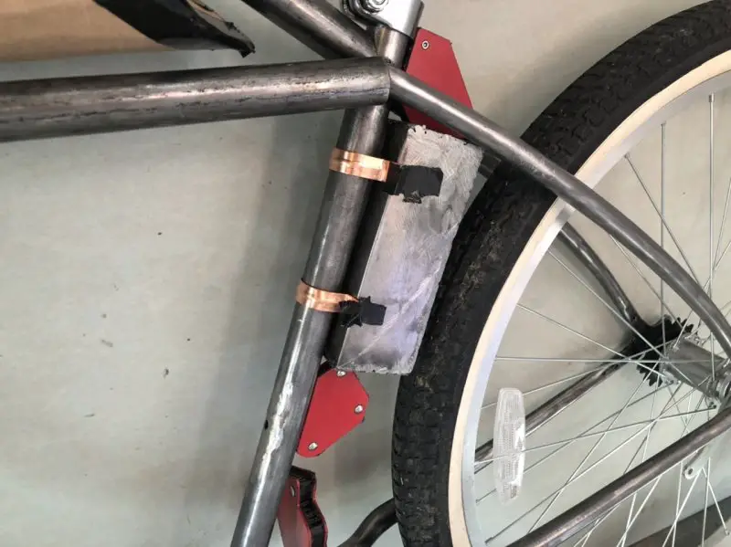

Also, while practicing some welding I created a small rectangular box. Was thinking of possibly making this a faux toolbox or oil tank. Not sure, definitely not authentic looking however.
Anyway, here’s a few pics
