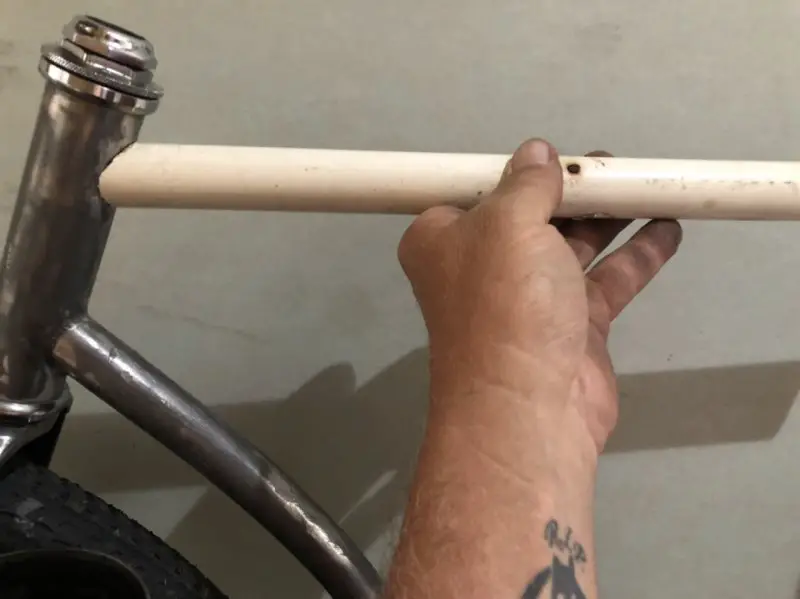

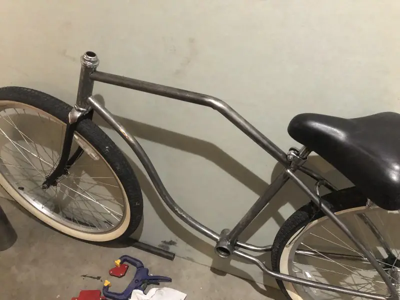

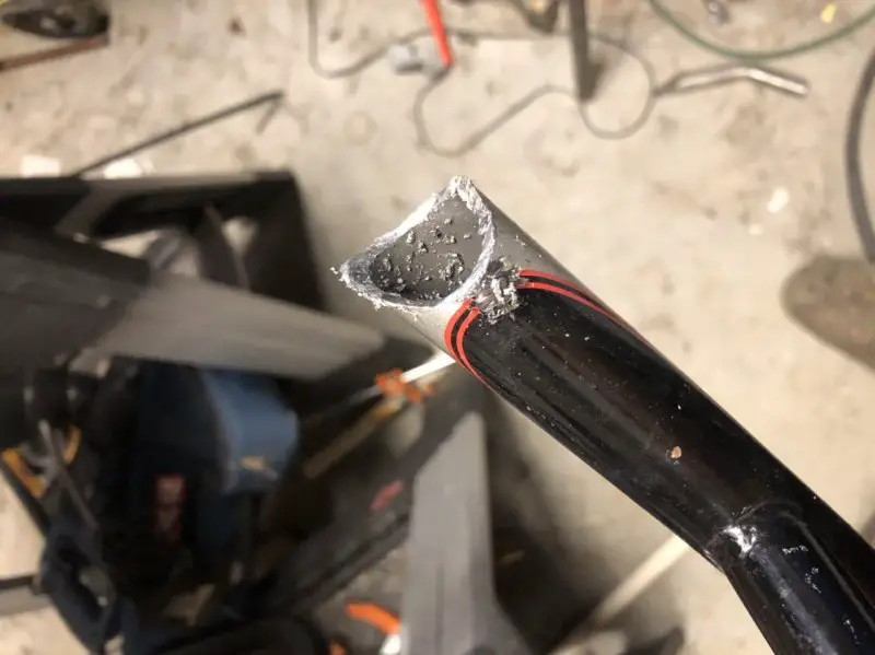

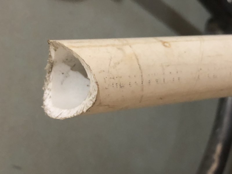

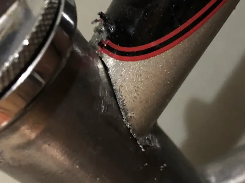

Well that’s great, cuz I got busy. First I notched a 1” piece of pvc and was pleased with results. Then I notched the other bar I cut off the bike. And I was pleased. Mind you, I did these with a hole saw. Deciding to move on and try it on the real bar, I quickly realized I did not have enough tube on the head end. So I did use the holesaw on the seat post connection, but had to use a cutting wheel on the steering head post. Needless to say I’m pretty happy with the results. I do need to clean them up just a bit, but I’m pretty happy with the results.

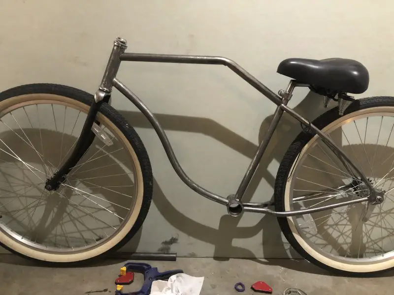

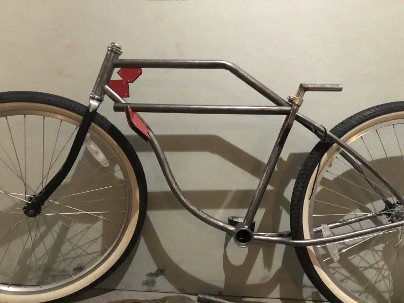

And another inspirational picture, lol. Will get to that second bar when work and time permit.
