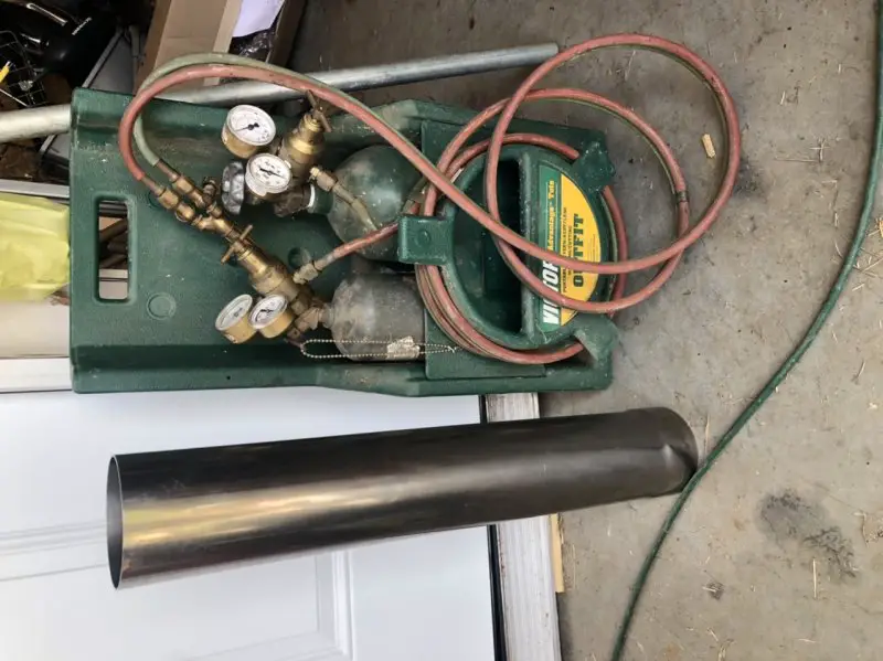

More tools and parts. Working oxy/acetylene Torch and a 4” exhaust pipe I hope to build a gas tank from.

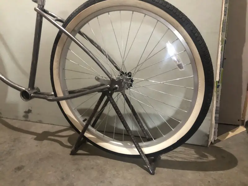

Took the time today to fix the bike stand that I had built. It needed to be narrowed, and I used the ozy/acetylene torch to heat one side and bend it making it match the other side. Lol, still not perfect but functional.

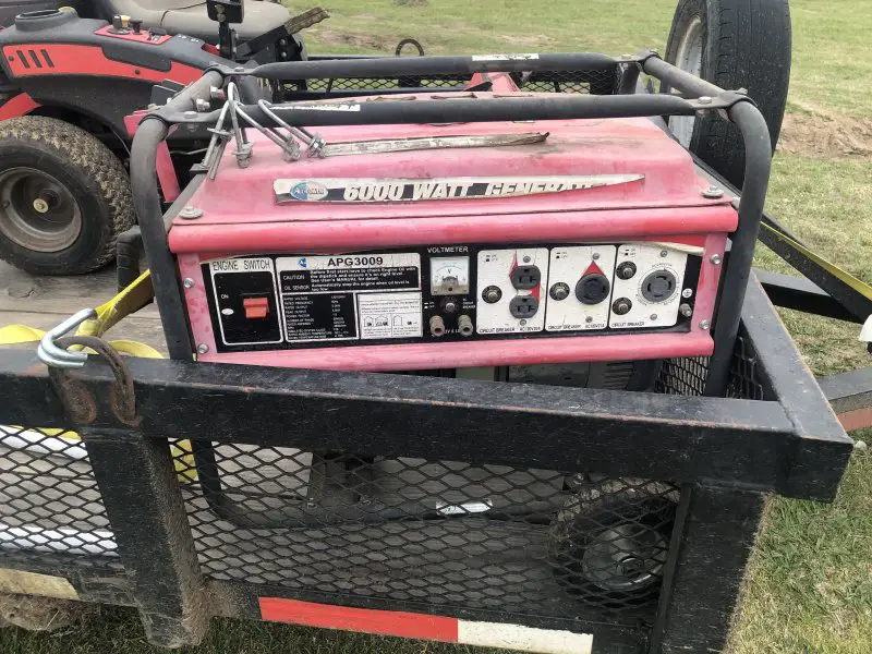

On a sidenote, I got a free 6000 W generator today. Do not know what shape it’s in yet, have not had a chance to look at it.

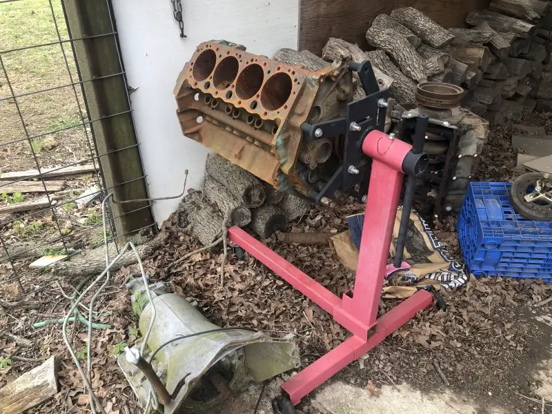

And I have access to an engine stand. I’ve seen a couple people on here using it as a bike stand. Should I get it, it’s free also?

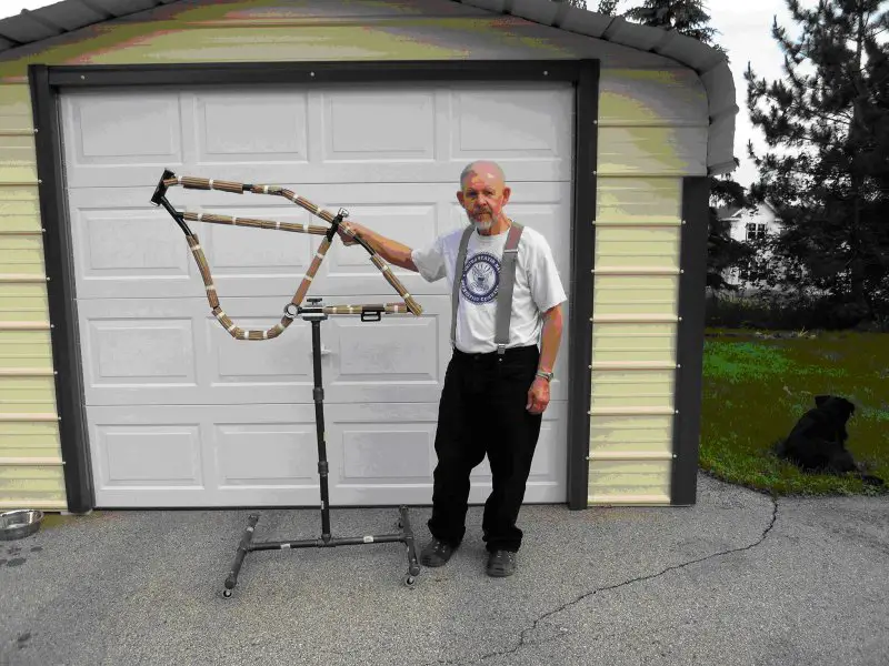

Sportscar Pat uses engine stands. My back and knees don't like working at that height. So I made my own out of black gas pipe sections, can be broken down for storage. The chain stay clamp is a Peterson Precision product. (Me).

Hope the geny is a runner, they just take up space until you need one. Used to live on the prairie Dekalb county in Illinios.

My 2 cents on bike stands. make one that on the top half of the bike a bar stool is about the right height to sit on, and a standard chair is the right height for the bottom half of the bike. Bar stools you are at the almost standing position, so little effort is needed to stand up.
That’s a great idea Tom. And thanks I knew I had seen a couple people use them.
So maybe I need to talk to you about your plans and your clamp..., although I think I’m still getting the engine stand because it’s free.

If I can’t get it running I know a small engine mechanic that can. And yeah I have no space for it but I’ll make do. There are just times when you need one

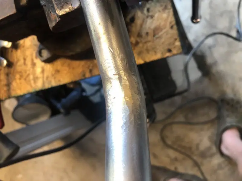

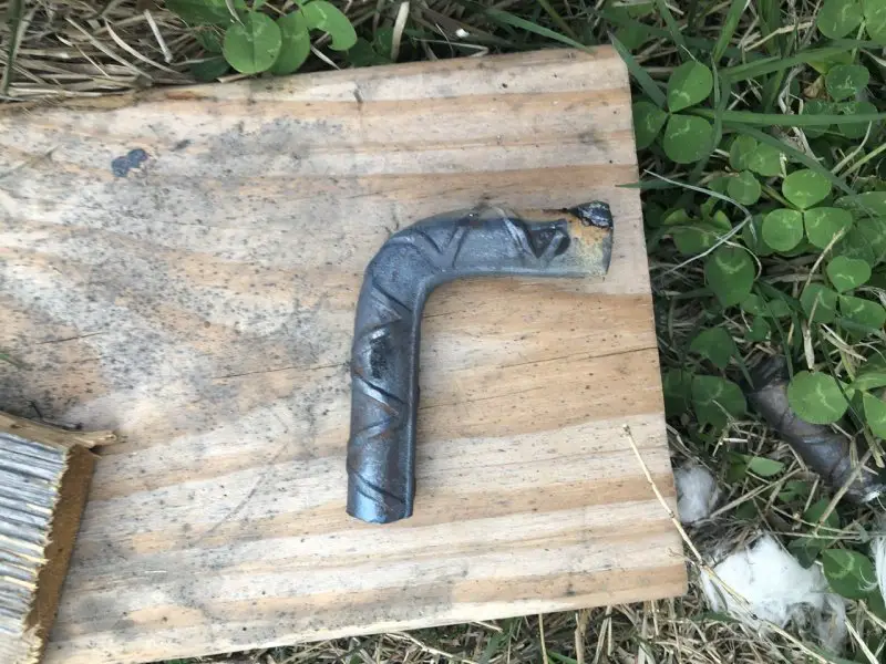

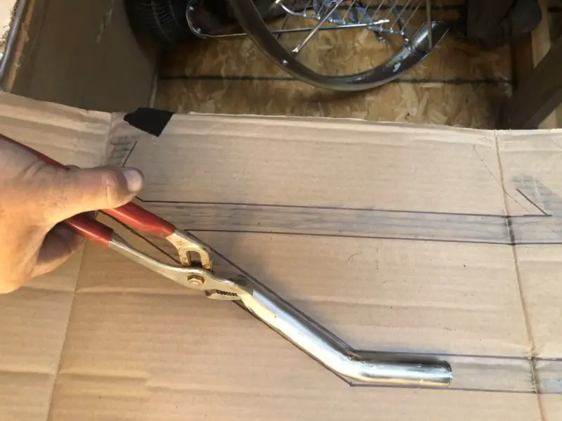

Did a little pipe and rebar bending today checking out the awesomeness of my oxy acetylene welder. Bent rebar first then went for some 3/4” Home Depot pipe. I tried it with sand and without sand. there really was no difference, with my backwards ass primitive way of bending pipe. In the vise with a leverage bar, lol. Of course it created a crease, so I took one pipe and brazed the crease, still needs work but didn’t turn out half bad. I got some quality practice time in today, need more but getting there
Last picture is upside down, no matter what I do this website wants to put it upside down so sorry
