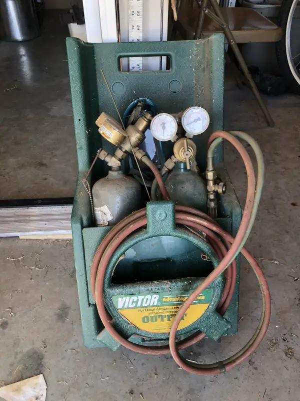

Picked up and oxy/acetylene torch from my dads place. New hoses and some gas and she should be good to go

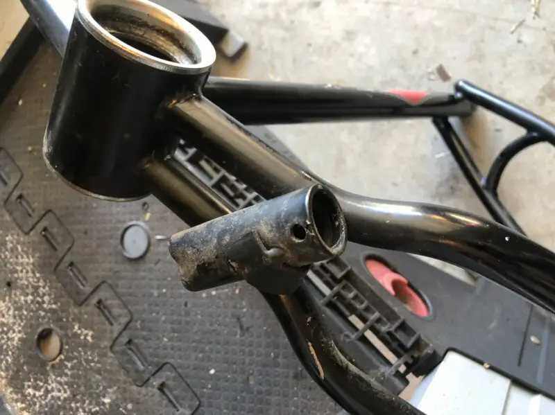

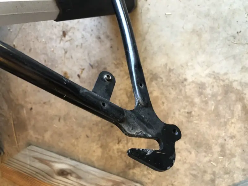

Should I cut the kickstand frame off and the extra tabs on the back of the frame where the fender and chain guard attached?

Danny, kickstand might come in handy. You are building a boardie tribute.
Racers were the original choppers. If it don't make it go fast it goes. Chain guard and mount.
I covet your Dads torch.
Oops, chain guard mounts and kickstand frame gone. Oh well, it will be chopped
yea me too on the torch, gotta get that baby checked out and fired up

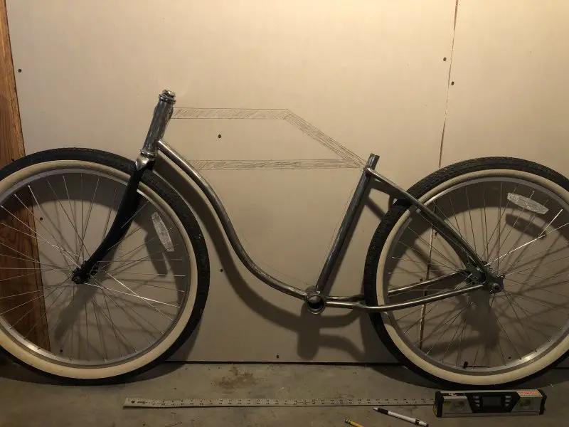

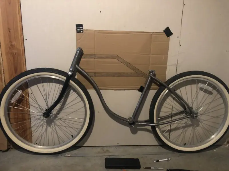

Not sure I like this or not, but without stretching the frame it looks a little different. Still decent though.

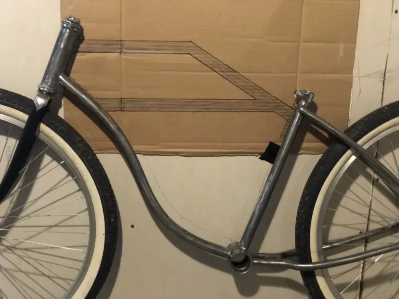

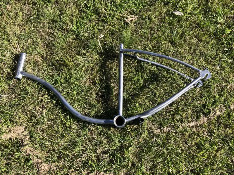

Ok so I redesigned a little bit, I like this frame layout better. Bars are spaced so I can use a 4” exhaust pipe for the gas tank.
I have 1”x.083” chromoly and the exhaust pipe in route. I have decided to braze instead of weld. I think I have a much better chance of success that way lol
Layback seat post and I can picture it
